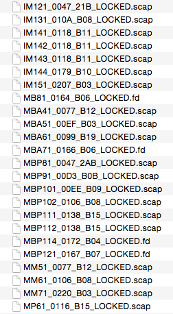

Boot ROM from B11 to B15 ;)
could 1st of july be out happy day? The new Boot ROM - that explains the unusual double reboot i remarked. Thanks for the hint bax.
I am aware, there are probably different reasons for all our problems. Im am very curious about the results from flyingfoxuk's machine. In my case i am still waiting for another freeze after my simple last steps - which did not happen yet for 4 days now. (ok, not REALLY waiting for it to happen....)
These Macs got Firmware update:
I had a look in the installer and it's an update for the OS recovery boot-time option. But maybe they sneaked something else in there on the quiet ;)
Could be preparing for the new OS? New filesystem type coming? Speculate away wildly!

Sorry... a patch from who? For the nMP? Different from 10.10.4?
There is that entry MP61 (we do own the "6.1") at the bottom of the ist from bax2003, but as infrared writes, we do not really know whether this is a fix of some kind for the current system. It Could be, that Apple really fixed something without making too much noise about it...
