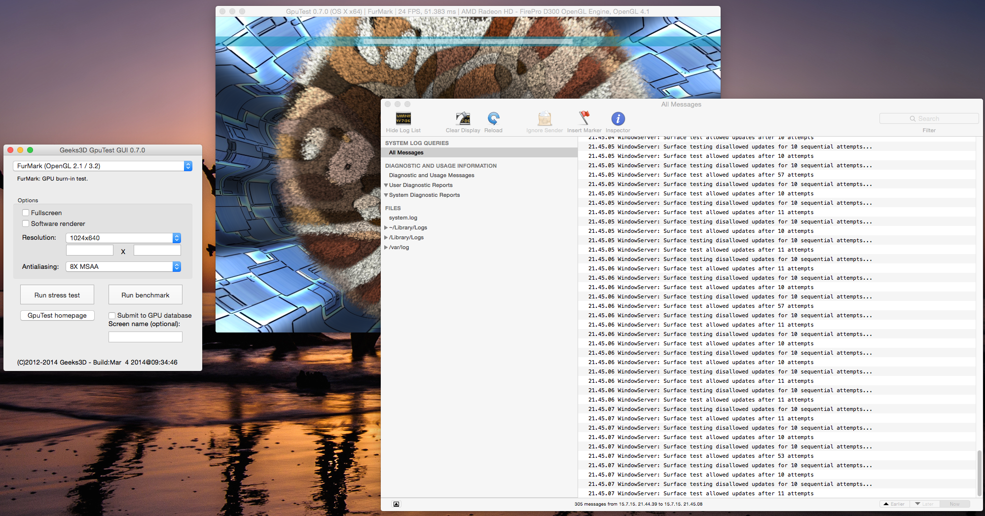

I discover that http://www.geeks3d.com/gputest/ can show your GPU weakness easily. Just run FurMark standard test, snap the window and move it. In the same time take a look at console.. (hundreds of "WindowServer: Surface testing disallowed updates for 10 sequential attempts..")

WindowServer ... : Surface testing disallowed updates for ... sequential attempts.. -

@axantas - I didn't wrote that gputest freeze macpro, but have a look at console during the test. I don't think that it's normal.
here it is:

I get the same console messages when I run this test while moving test window.

I am also seeing the
" WindowServer[199]: Surface testing disallowed updates for 10 sequential attempts..."
just before the lock-up and also when running the GPUTest - although the GPUTest does not lock-up the WindowServer.
Not sure if others with 'working' systems see this error at all in their console?
