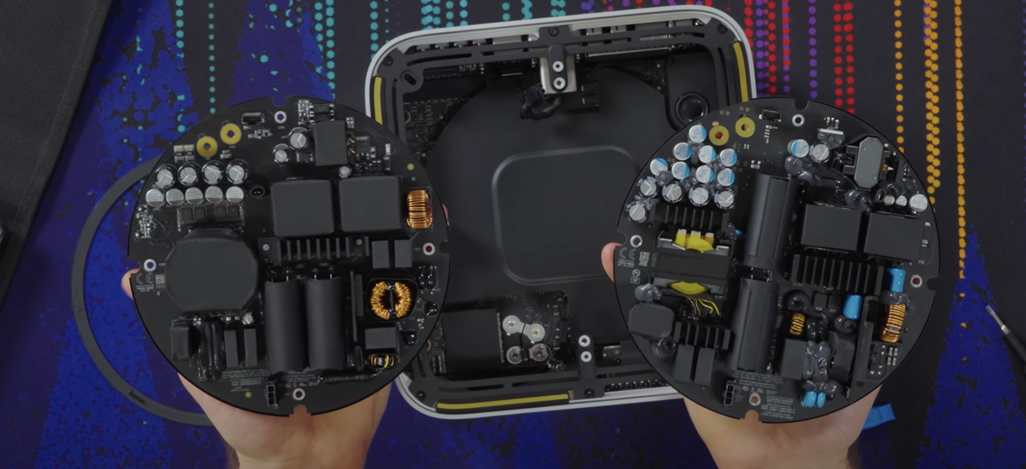

The video posted above about covering half of the vents makes this Mac Studio problem seem like some sort of design oversight where the particular placement, how it draws and pushes air causes some sort of turbulence effect. It would be interesting to hear if it goes away by removing the chassis for example and if it does, changes to the vent pattern might help.
"Don't buy a first gen new Apple product" is again apt because they always seems to have issues that then get fixed silently for the next iteration.
I am not so sure this is the fan(s) causing increased noise in some Mac Studios. I think the most interesting observation is still the fact that we seem to have differing PSUs in play, and I wish we could tell which PSU we have in a particular Mac Studio, without having to open it up.
The "Whine" possibly stems from that difference as well.
