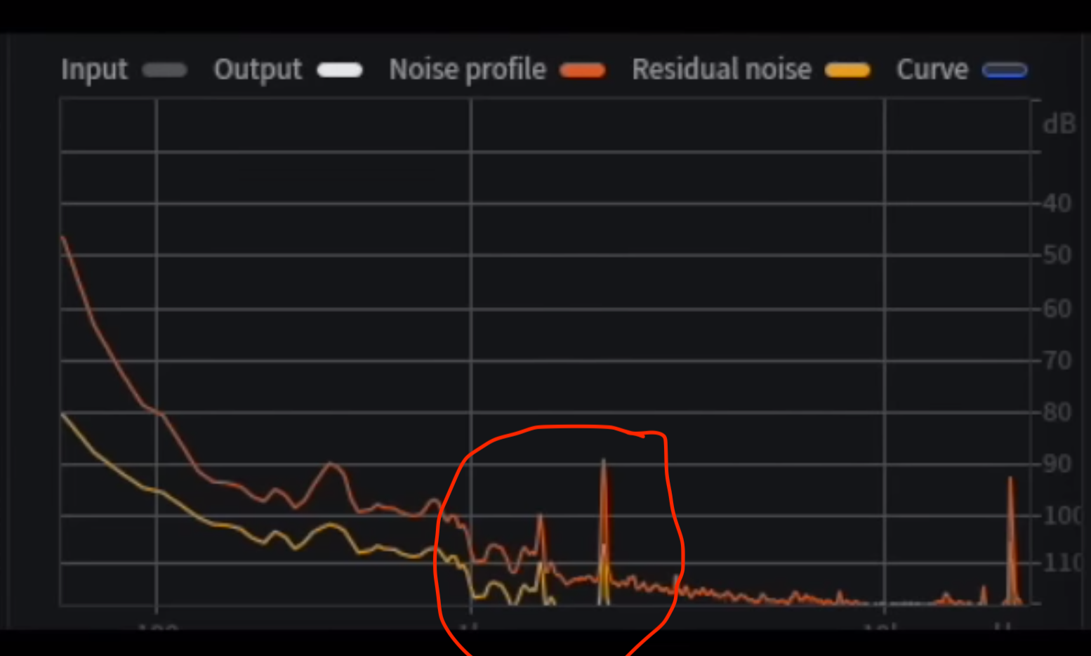

For example, here is someone who is a music/sound professional that says they can't hear the tonal components, even though they're clearly in the frequency response measurements they made:
Source for above image:

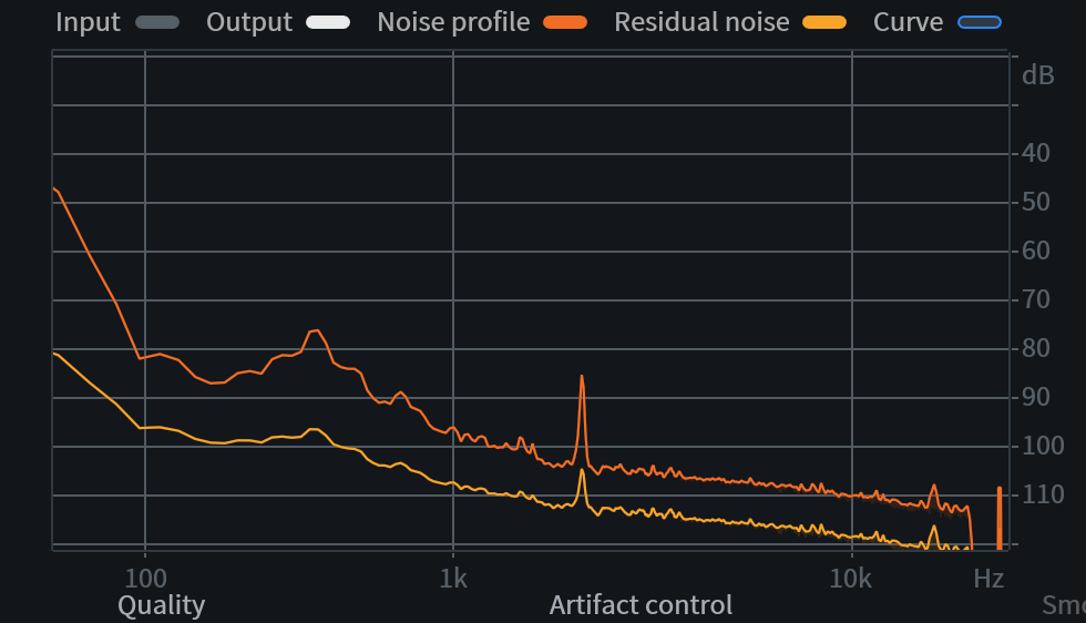

And below we have my Mac Studio at the same distance...using the same software to make it easy for people to read...
I've seen some other high quality measurements posted with the same tones...some also from users saying they're silent...also I've ran the analyser on every decent recording/youtube video I've found and they always show up...

Conjecture also. Just because you cannot hear it, does not mean it is not there...as I've shown in my class 1 measurements, in my Mac Studio, it is very low...at 1m (3ft) it is between 0dB and -3dB...below the threshold of hearing for many...
Even at 30mm (1"), the tonal components are less than 24dB, some wouldn't hear distinct tones even with their ear right up to it; just generic fan noise...and some might only barely hear the fan noise...
Some people can hear below -10dB at these frequencies...these are the kind of people who will hear these tones even in a loud enough room 1m away...possibly even with music on...I'm not one of those...(even though I've always worn ear plugs at live music, and even though I monitor at responsible levels: years of playing an acoustic piano for hours a day takes it toll, my mom is half-deaf from it lol)...
Conjecture also. Just because you cannot hear it, does not mean it is not there...as I've shown in my class 1 measurements, it is very low...at 1m (3ft) it is between 0dB and -3dB...below the threshold of hearing for many...
Some people can hear below -10dB at these frequencies...these are the kind of people who will hear these tones, even in a loud enough room, 1m away...possibly even with music on...I'm not one of those...

Besides the whole whistle/whining thing, i.e. even without tonal components, the Mac Studio is not silent, you can hear the fan noise at 1m even in a noisy enough room. The title of the thread is correct, and the sound power specifications are correct: it is one of the loudest Macs at idle. Anyone that cannot hear the fans has some hearing damage, end of story. This is just science, there is no getting away from it.
The higher-midrange tonal components that users are complaining about are at about 0 to -3dB at 1m from my unit. See attached images. Note the peak around 2.1k in the second image. And yes I did say 0dB, humans with good hearing can hear down to about -10dB or more at this frequency range. Moving the mic a few cm made it disappear in the frequency response graph (first image), however you can always see it as a vertical line in the spectrograph. It's highly likely many will not be able to hear these tonal components at 1m. Even at 30mm the tonal components are less than 24dB, so also likely some will not be able to hear them even with their ear up against it. And also likely not to show up on many mics etc.
Note the overall fan noise at 1m is about 15dBA, as stated in the specifications, and as can be calculated from the sound power level. So low that I had to move the mic to 500mm to get above the noise floor in the room (23.5dBA in those images).
Now whether it bothers you is a totally subjective matter...IMO it really isn't that annoying, but it is a little bit, especially if you have the room dead-quiet. And it is disappointing, particularly in comparison to the M1 Mac Mini. Also for any sound engineers, I agree with the Sound on Sound review, that it won't be an issue recording in the same room as it. "I wouldn’t be afraid to use it in a live room with a musician." https://www.soundonsound.com/reviews/apple-mac-studio
