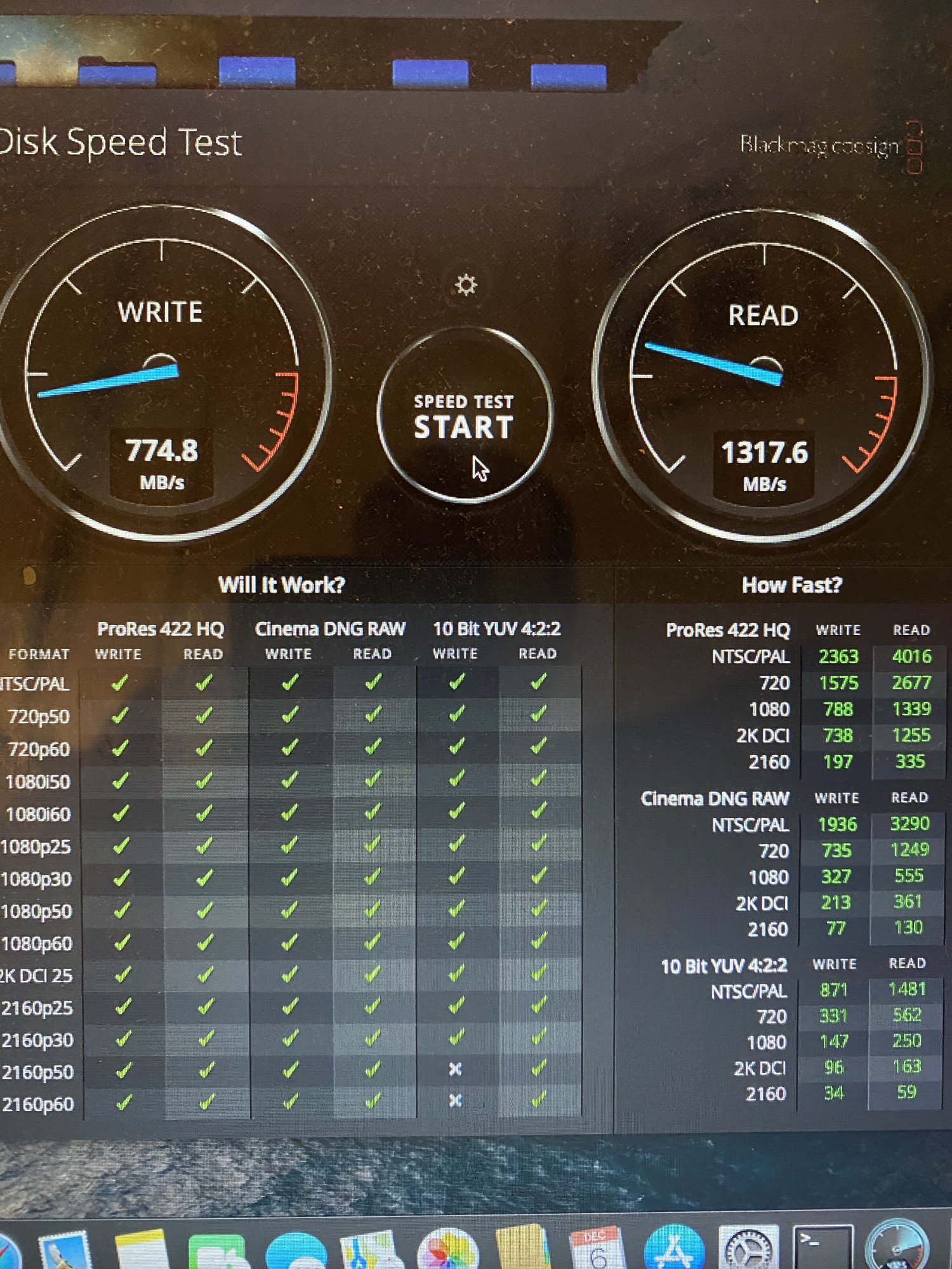

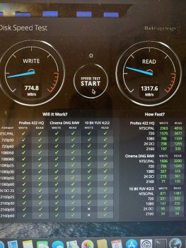

Thanks for all the info on here. Can’t thank you enough.
I have finally upgraded my MBA 2017 with Sabrent Rocket 512GB.
Got the Sintech adapter from their eshop website (received black adapter)
Mac sees PCI x 4 lanes but my write speed is low at ~750/mbs
Read speed is not bad at ~1300/mbs
Is this because of the black sintech adapter?

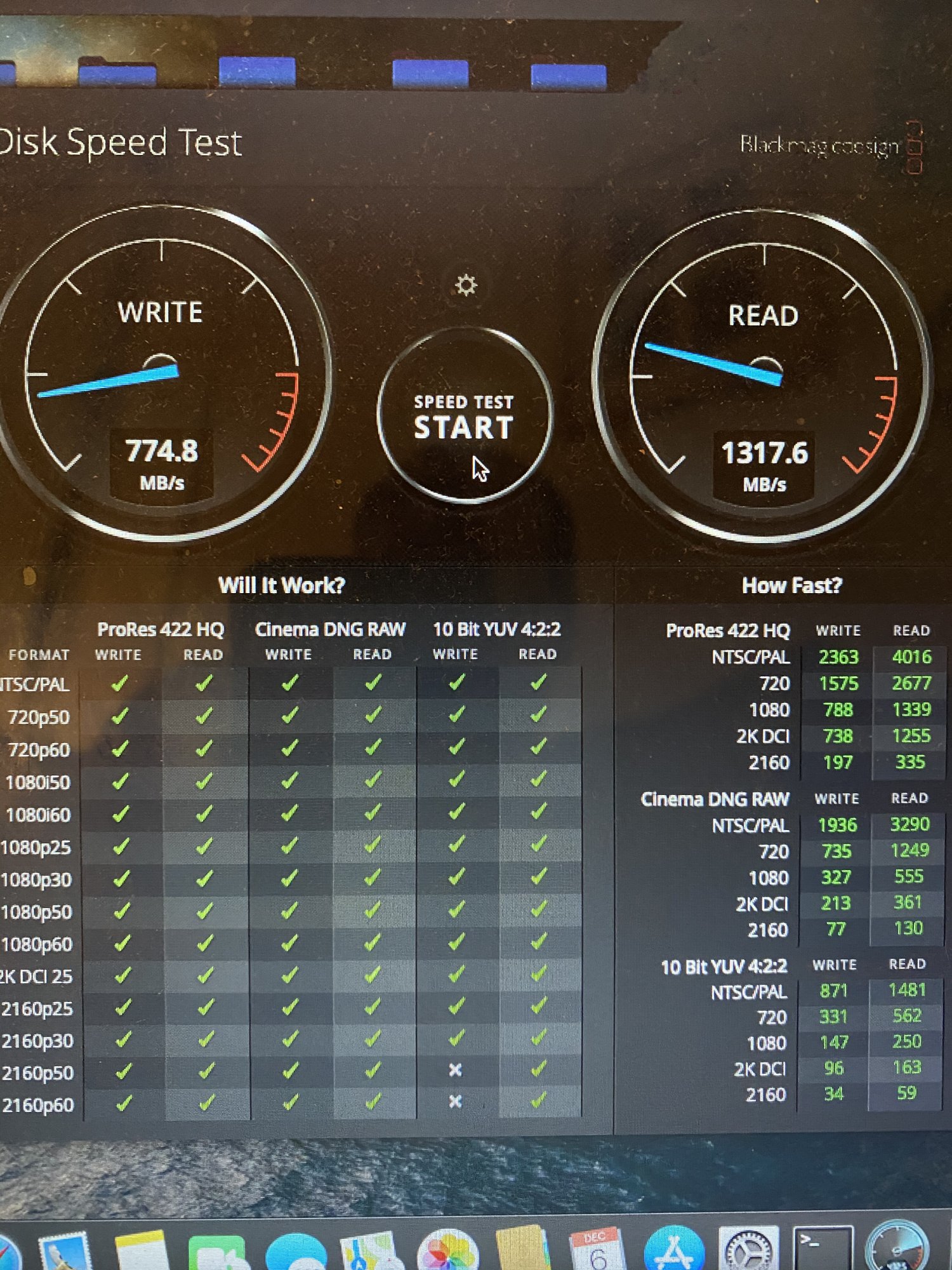

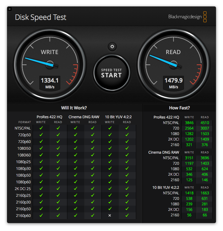

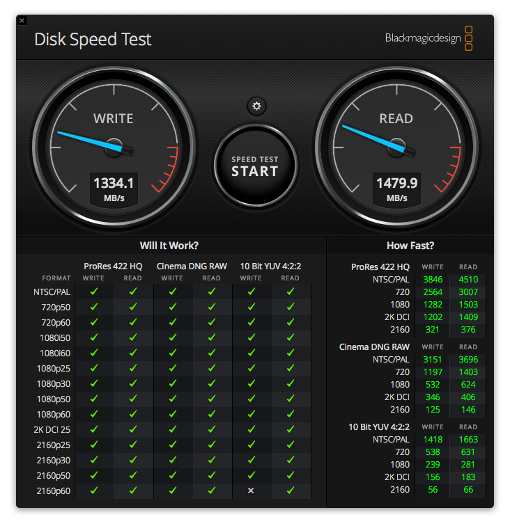

I'm using a black sintech adapter on my Early 2015 11-inch Air and I'm seeing 1000MB/s write and 1400MB/s read speeds but I have a 500GB Samsung 970PRO NVMe M.2 storage drive in mine.
It's very strange, from looking at other peoples reads with Same Ssd (Sabrent 512 GB) most people get around 1500 read and 1300 write. Trim is enabled and System page shows x4 lanes PCIe. Not sure how to cross check what's not working, baffled.
Being PCIe 2.0 x4, you're never going to get higher than the roughly 1500 MB/s Read/Write speeds. In my 2017 MacBook Air, I added an ADATA SX8200 Pro and get around 1400 MB/s Read/Write speeds.
Reactions: Macdctr
That’s what I’m trying to achieve.
At the moment I’m getting 1500mb/s read speeds but write seems to be stuck at 800mb/s.
If there was something wrong with the SSD I imagine read would be low too?
Also on disk utility my mac sees 2 internal disks. My HD name is “Mac SSD” disk utility sees;
-Mac SSD
-Mac SSD - Data
