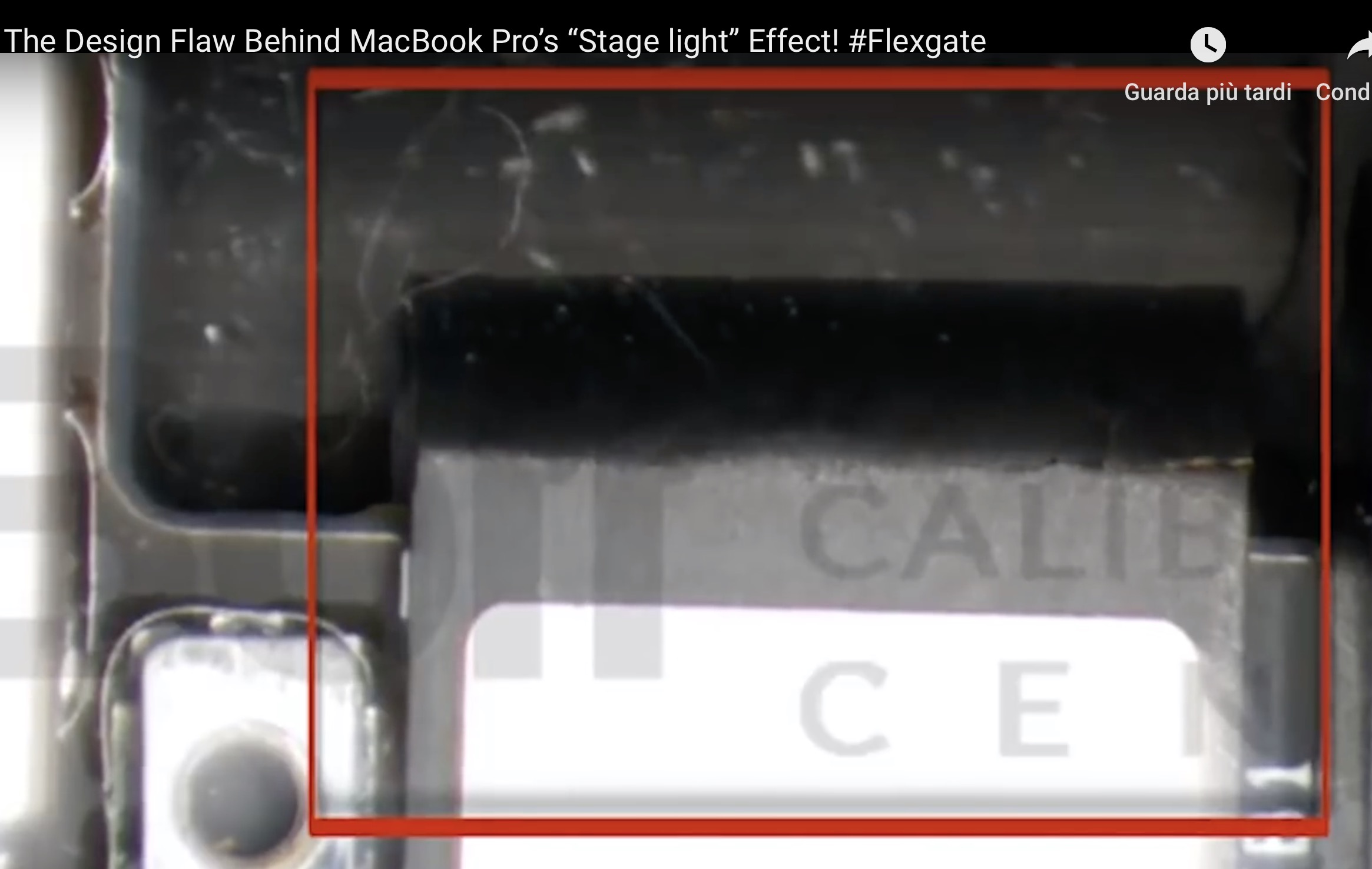

I think we just need more pictures of the cables that broke and the kind of curvature they had at maximum stress.
The issue is due to a insufficient radius of curvature, if we can see the radius of curvature has changed (we need more proofs of machines of various manufacturing dates, so please help), there is no point in measuring the cable, which is impractical for the average user.
Ifixit measured the cable because they saw a much better curvature, hence they wanted to check if the cable was different, but the cable doesn’t fail because it is short, it fails due to flexural stress with an insufficient curvature.
I don’t think the flexural stress is the cause of the failure in this situation. A cable doesn’t have enough rigidity to resist flexional stress. Cables only work under tensile stress.
I think the source of the problem is the fatigue of the flex cable. A longer cable would work under less tensile stress increasing its lifespan
Yes, fatigue is the issue, but if it was caused by tensile stress, there is no reason why the cracks would always appear at the point of minimum curvature and not at the connectors (weakest section) or everywhere randomly, hence my assumption of flexural fatigue.
Try to imagine you pulling a rope against a friend: there is only tensile stress, sooner or later you or your friend just lose grip on the rope, because it is the weakest connection point. In the Macbook the connector is a “clip-on” type. If tensile stress was the problem, the cable would just slip out of the socket slowly with time. If the connector wasn’t the weakest point, the cable would break at a random point, not always the same for every Mac.
An idealized cable only has tensile stress, but as thin as it can be, a real cable still has a third dimension (thickness), so it is more correct to apply beam theory to understand the issue. Real cables can and do sustain flexural stress, otherwise you would feel zero reaction when you push one of them perpendicularly.
Actually this is the very reason “flex cables” are made as thin as possibile: to minimize the stresses induced by the bending (beam theory here again). But these stresses become zero only for zero thickness, which is impossibile.
P.s. The flex cable doesn’t have to resist bending, it should oppose the least resistance. If it had enough rigidity to resist bending, it simply wouldn’t do its job.

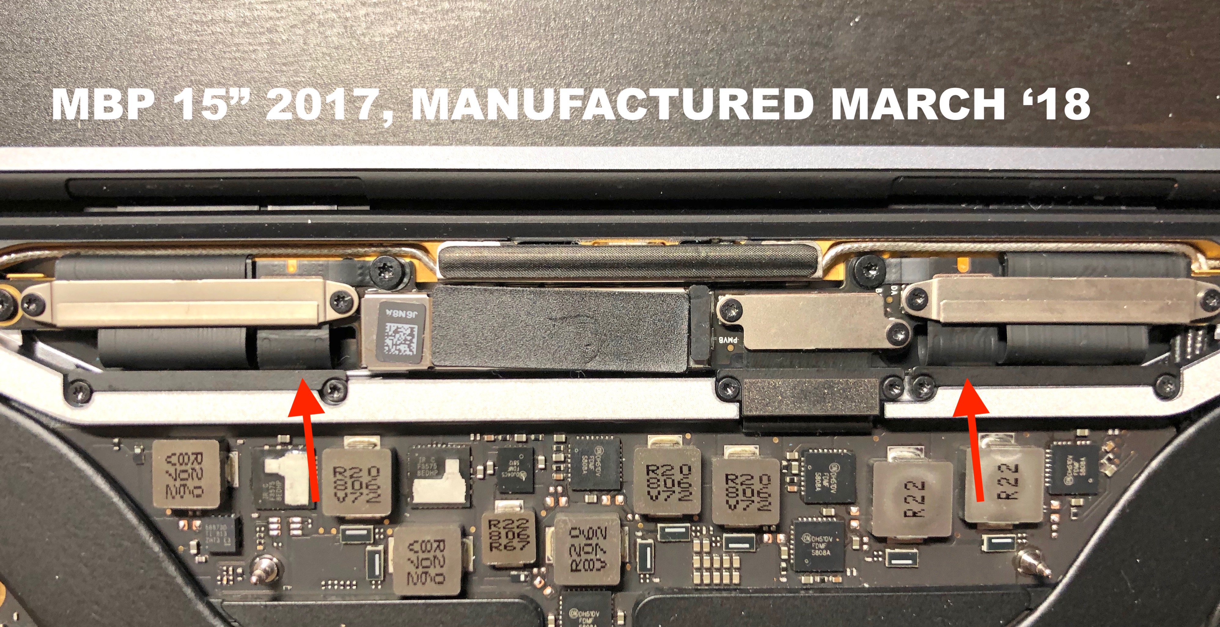

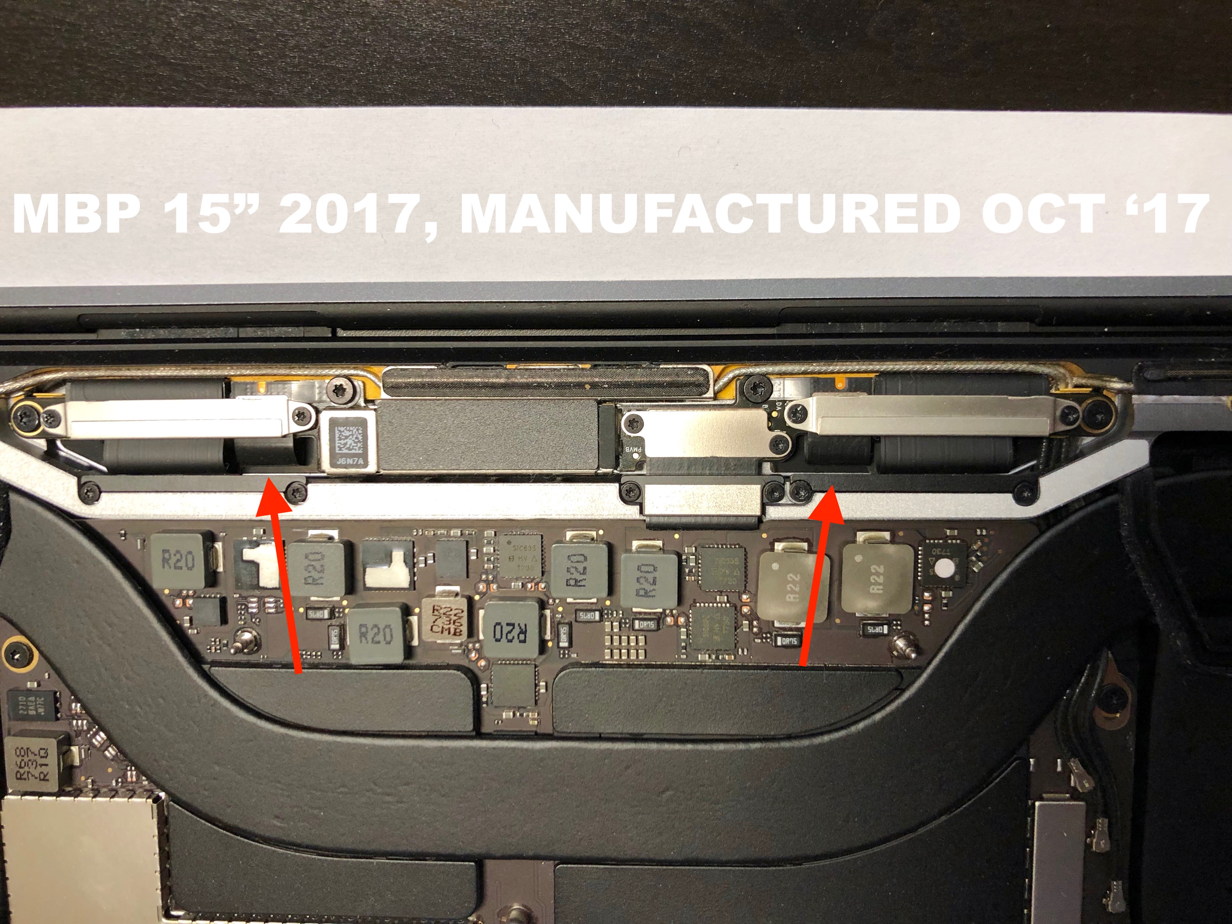

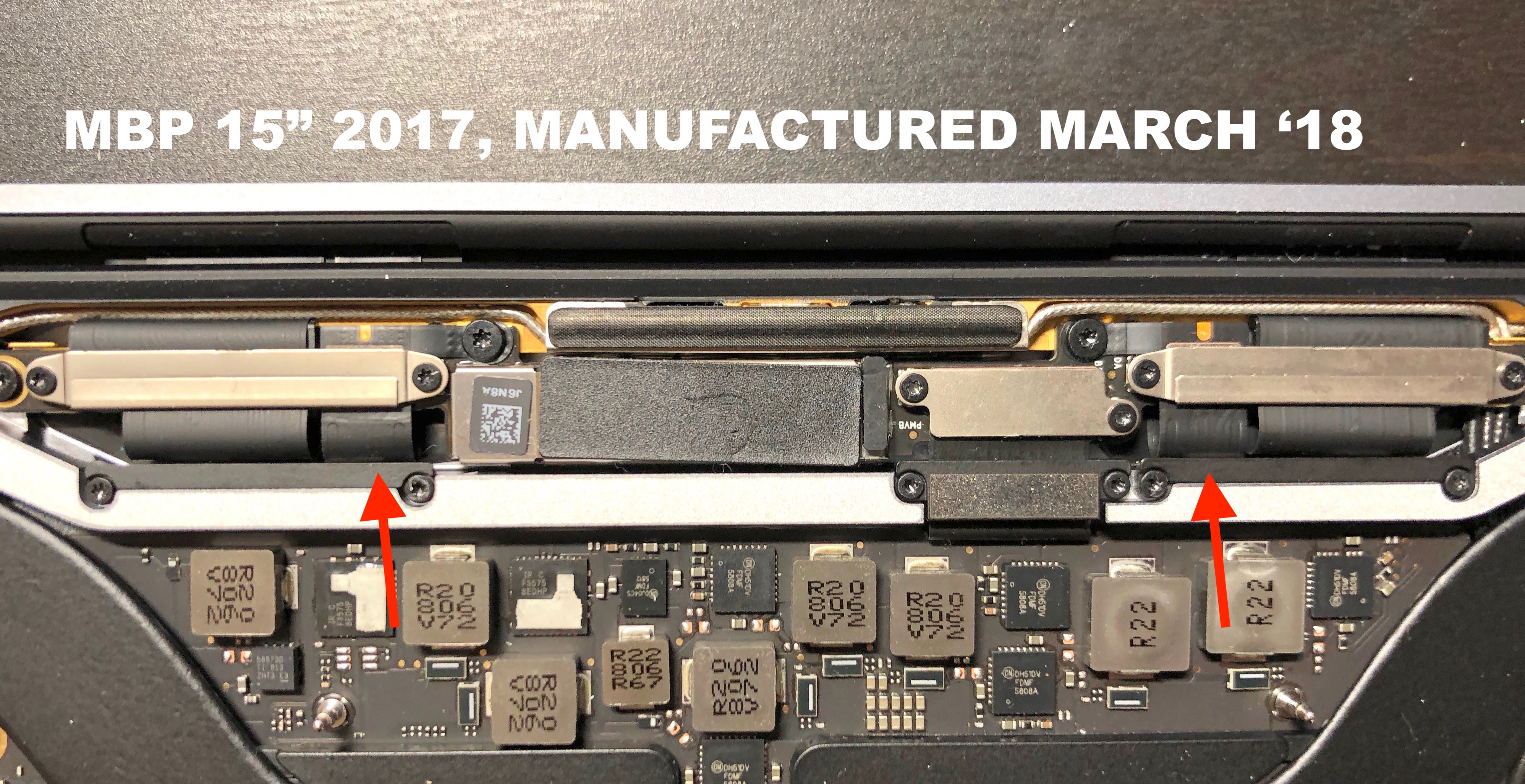

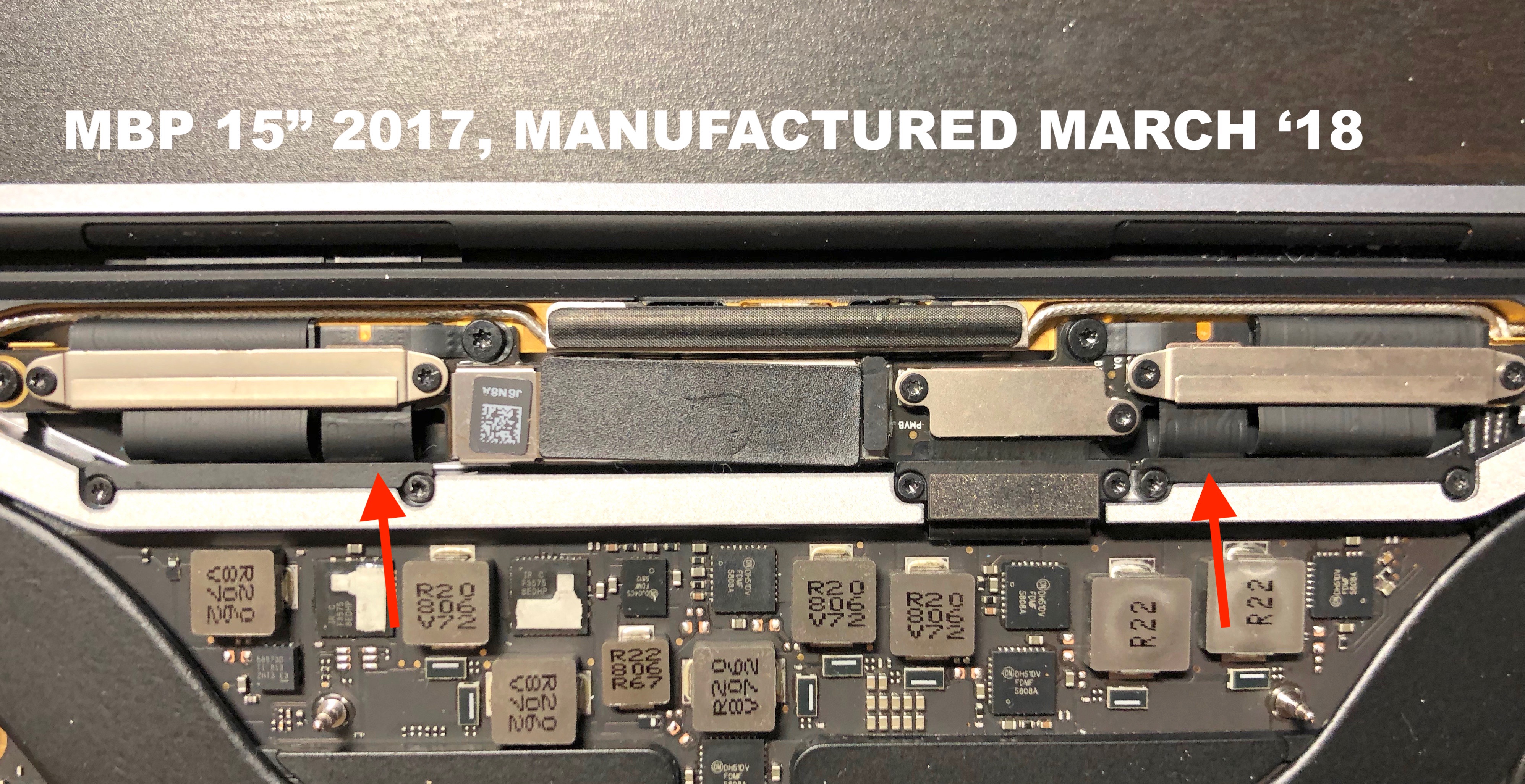

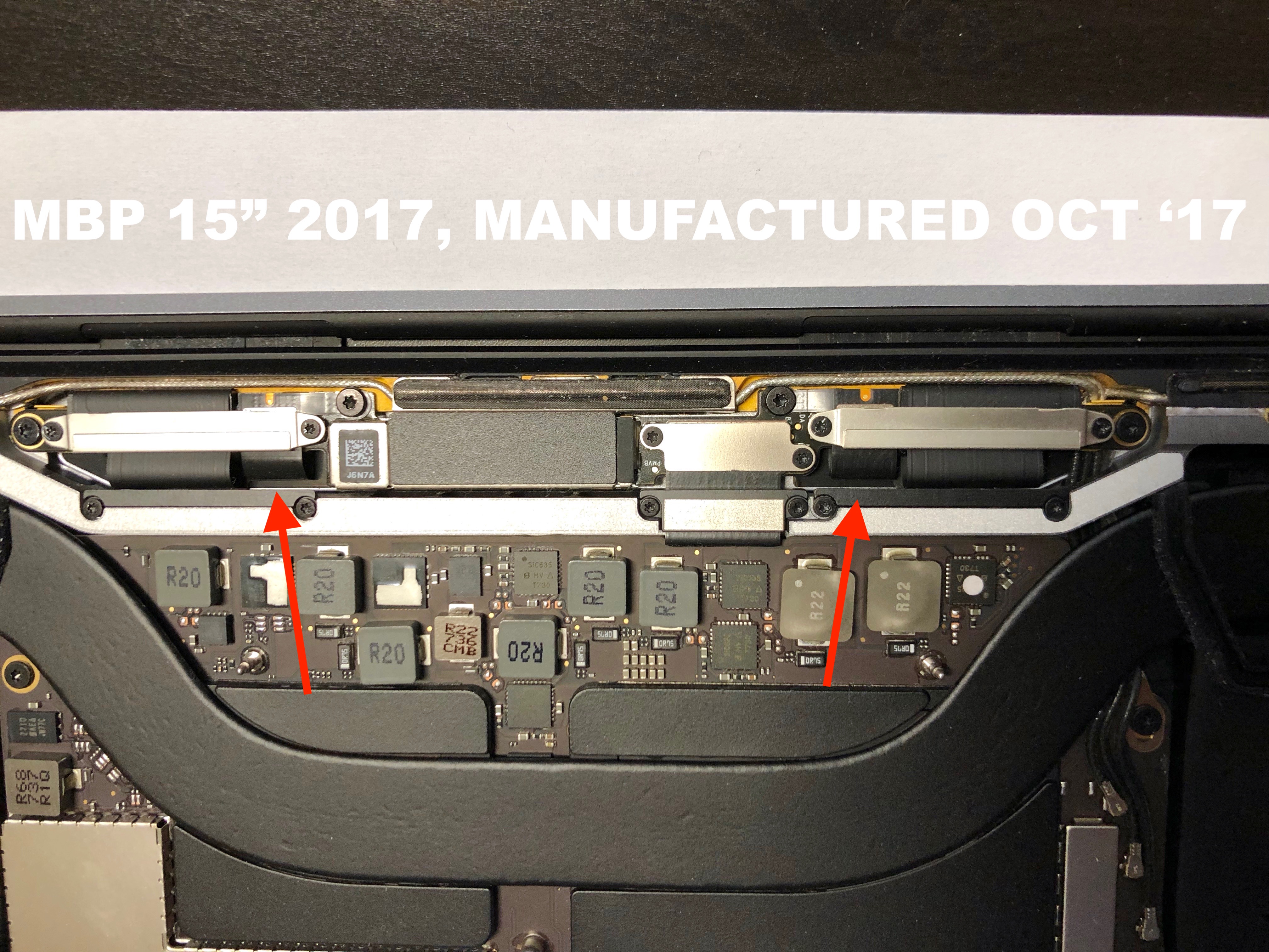

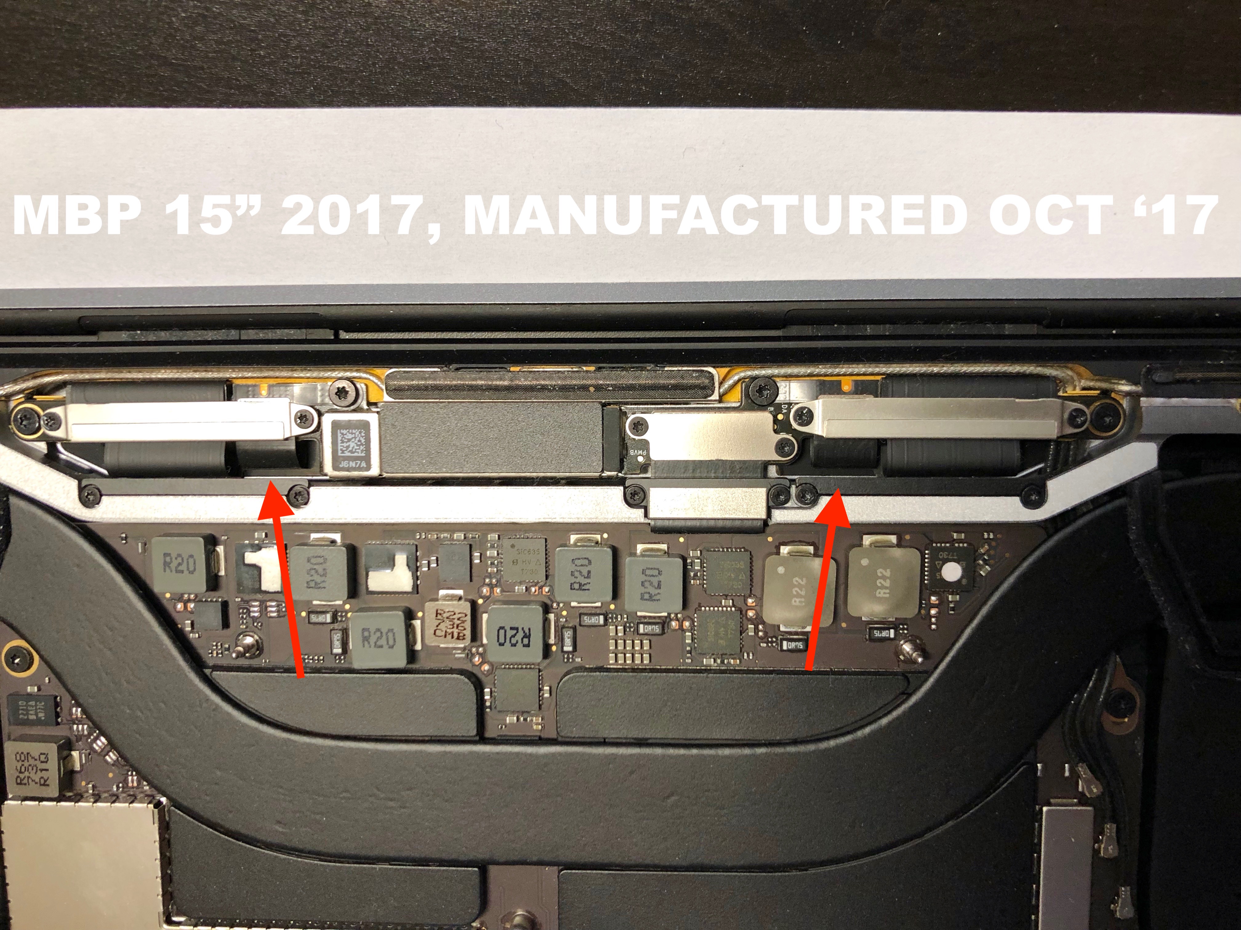

I had the chance to open up a 15" 2017 manufactured in October '17 (info from its serial) and I noticed a shorter cable than my same unit manufactured in March 2018.
View attachment 830343 View attachment 830344
Just curious, how do you determine the manufactured date from the serial number? I purchased my 2017 MBP refurbished in March 2018, and I am curious to find out the actual month it was made to see if it possibly has a longer cable.
Use everymac.com serial number info section or similar services on the web. Another good one is Chipmunk (in Dutch language)
