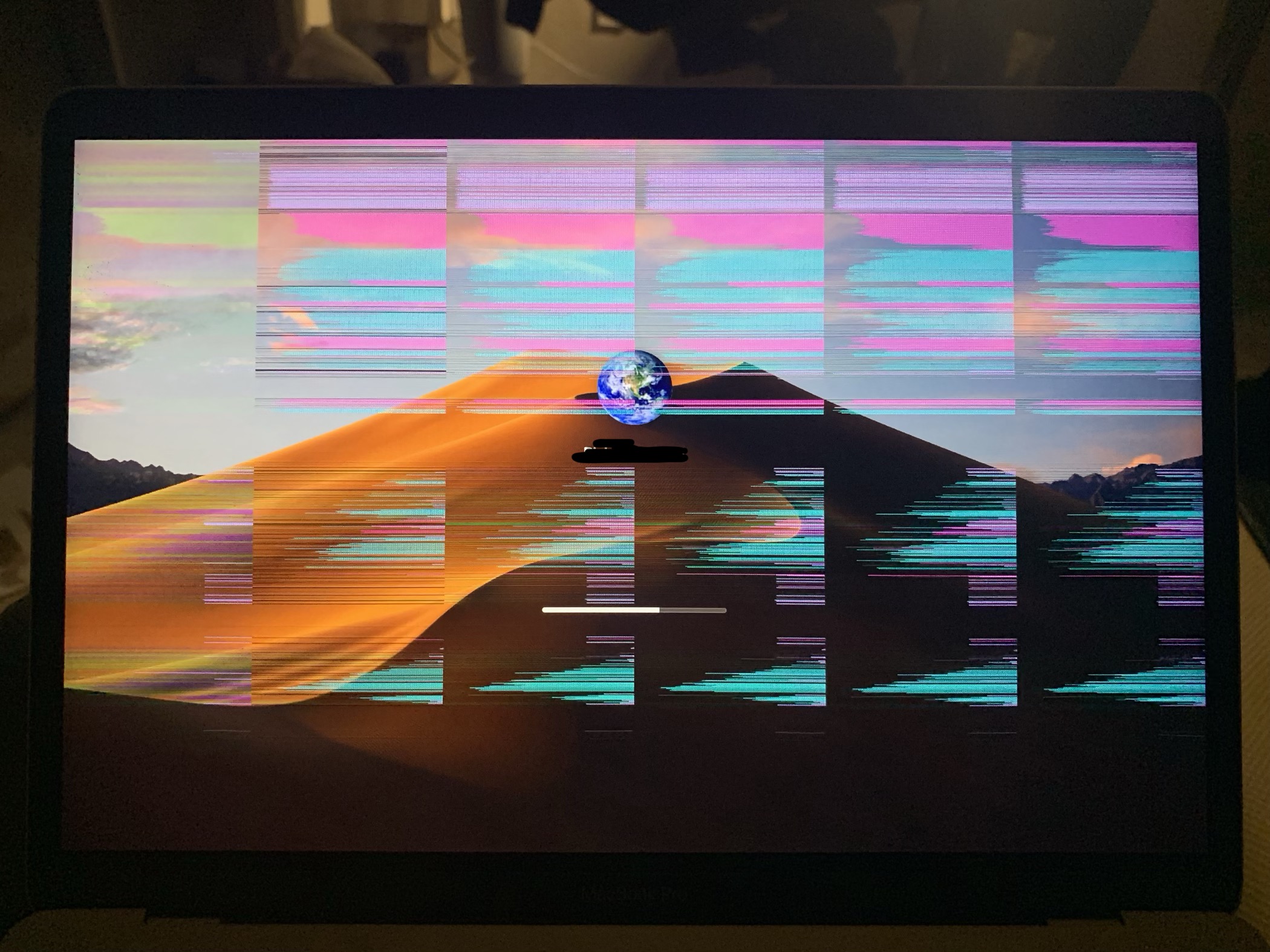

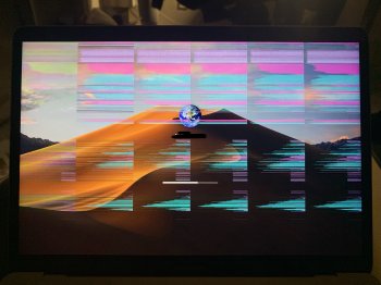

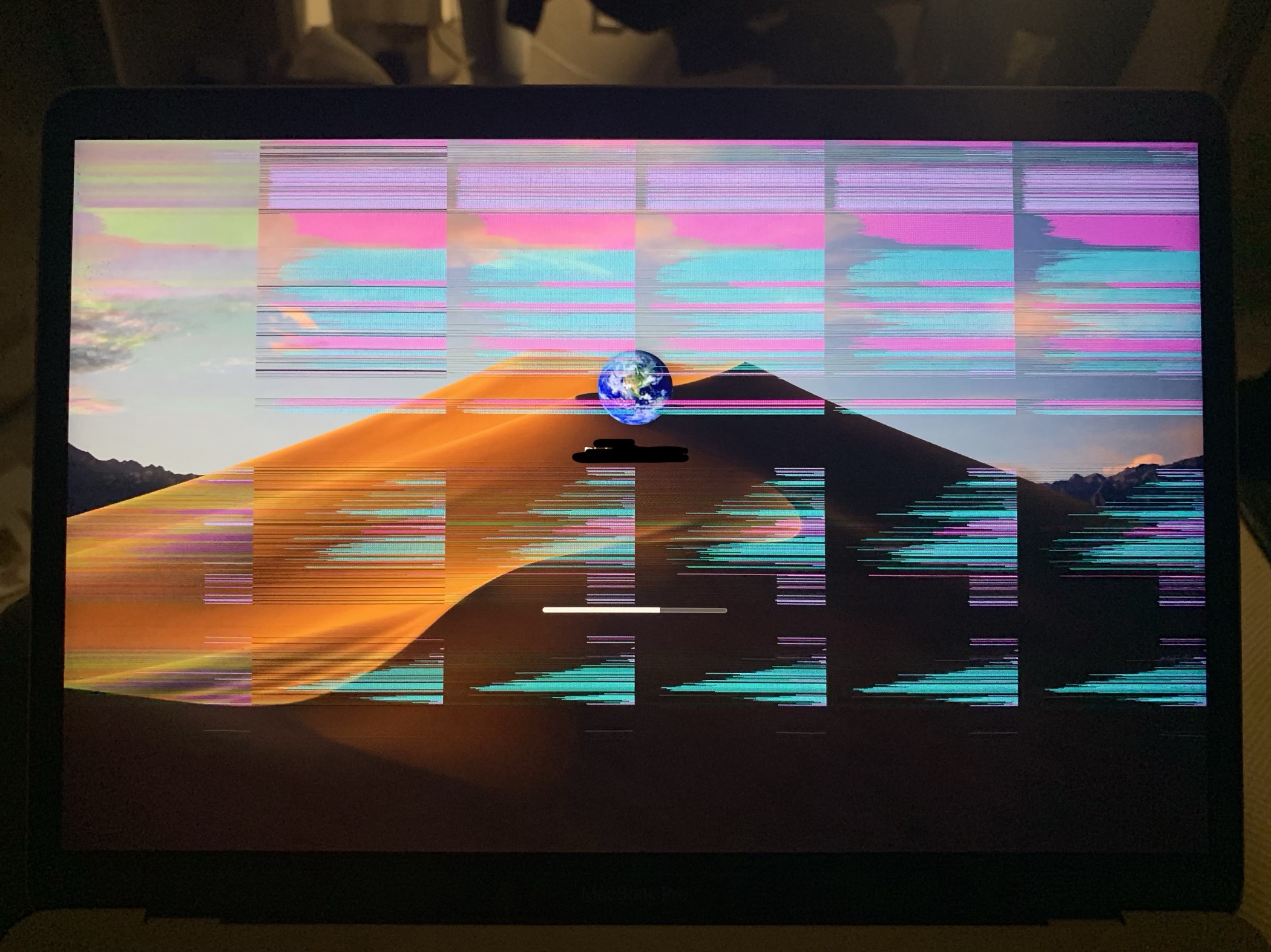

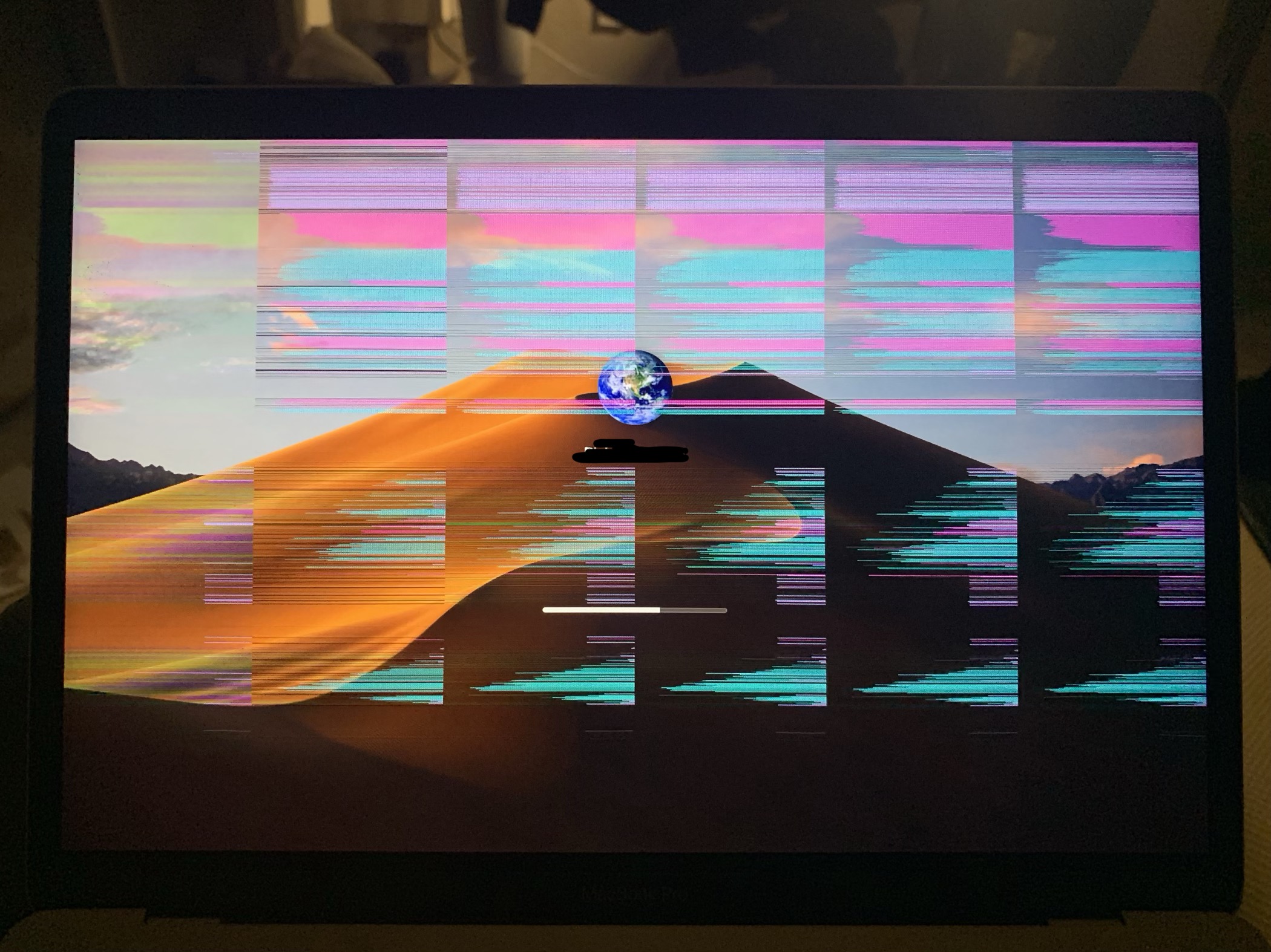

I took my MBPro ‘16 to the same Apple store I had a terrible experience in few weeks ago with them refusing the service and leaving the only option of $475 LCD replacement. I tried to convince manager and told him how many problems I had with this computer, but he still refused the service for free of charge claiming it’s an external damage and they need to diagnose it ( even though I diagnosed it for them myself already that it’s the cable with a lot of evidence).
Today, I took it to the Same Apple store again and fortunately the same person that I had a bad experience with, oh this really felt good this time without questions asked, he took the computer in for a repair.
