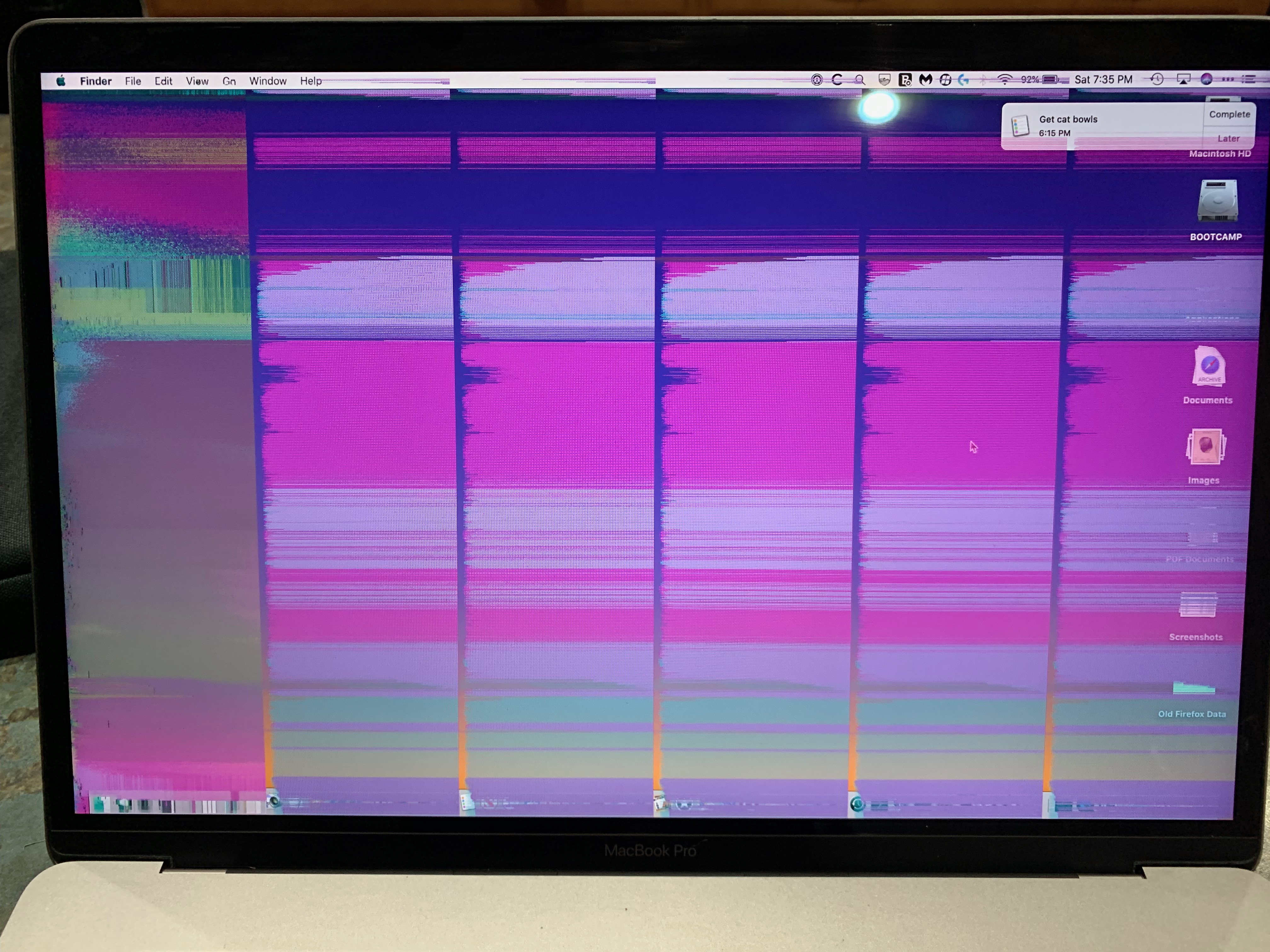

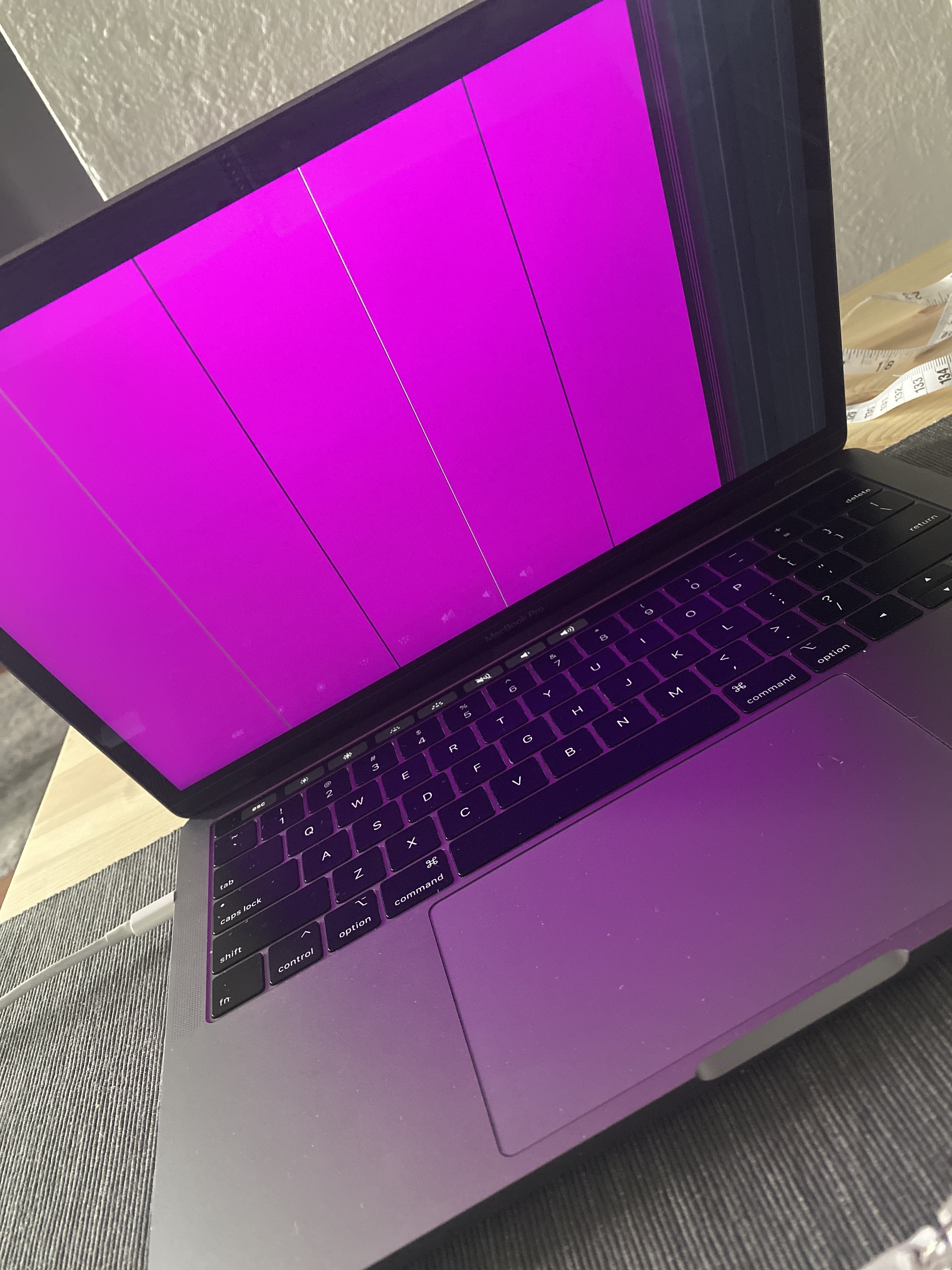

The problem I'm having is that my screen has become distorted with blue and pink lines going through it. I've seen some similar posts in this thread but I'm not sure if this is the same issue as the Flexgate problem which seems to center around the backlighting. I don't have issues with backlighting just the distorted screen with blue and pink lines as shown in the photo. If I plug my laptop into an external display, there is no distortion and the screen performs as normal.
Is the problem I'm having a form of Flexgate cable issues?
I took my laptop to the Apple Store today and they said the problem would be $680 to fix since it was out of warranty. I asked if the problem I was having was related to the "FlexGate" issues which I heard were covered under an extended warranty and the Apple Genius brought up an Apple web site and had me slowly scroll trough the extended warranty issue that were active to show me that the 15" MacBook Pro was not covered. I found the FlexGate 13" problem there and asked if the problem I was having was the same issue but was told that only the 13" was covered.

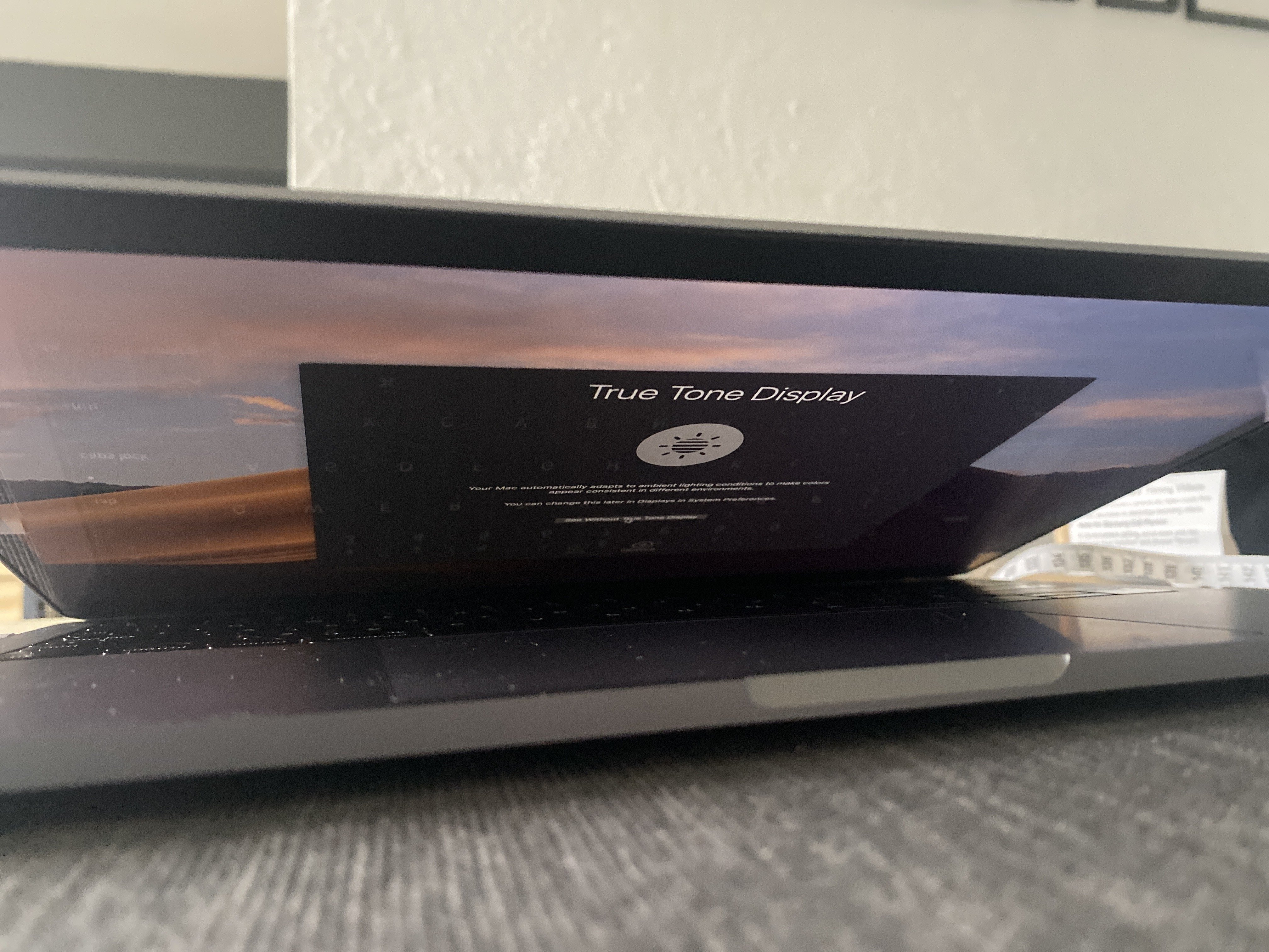

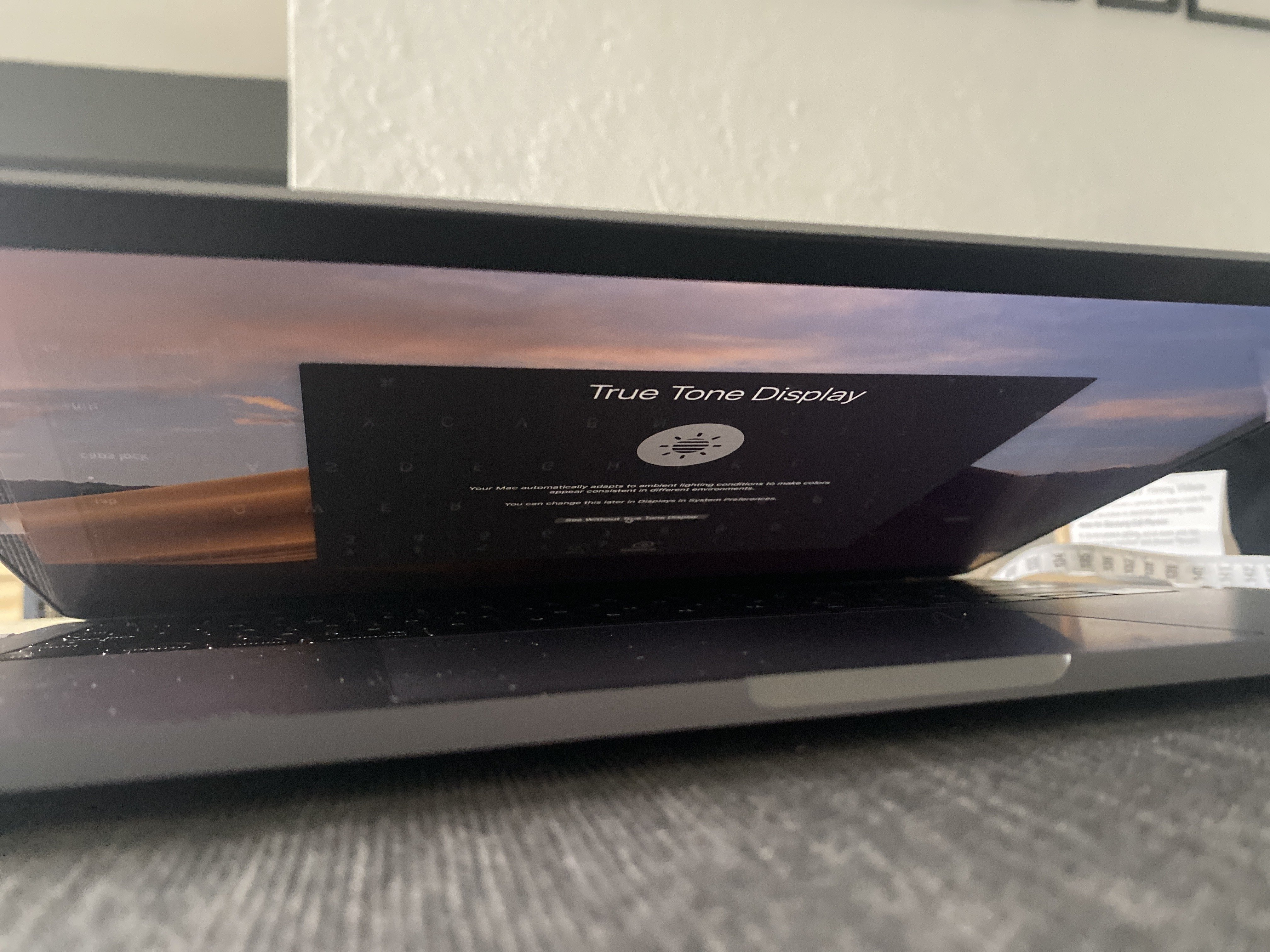

I thought I was good and didnt have this problem but tonight playing a game on my MBP, the backlight just went dark. Can still see the LCD working perfectly underneath if you shine something on it. Time to make that Applecare+ go to work.
Update to my previous post: Took my MBP in yesterday. Told the guy what was going on and he took an LED light out and checked the screen and noted in the work order that it was only a backlight issue. They are sending it out. Was quoted $475 before tax to fix but should be covered under Applecare+.

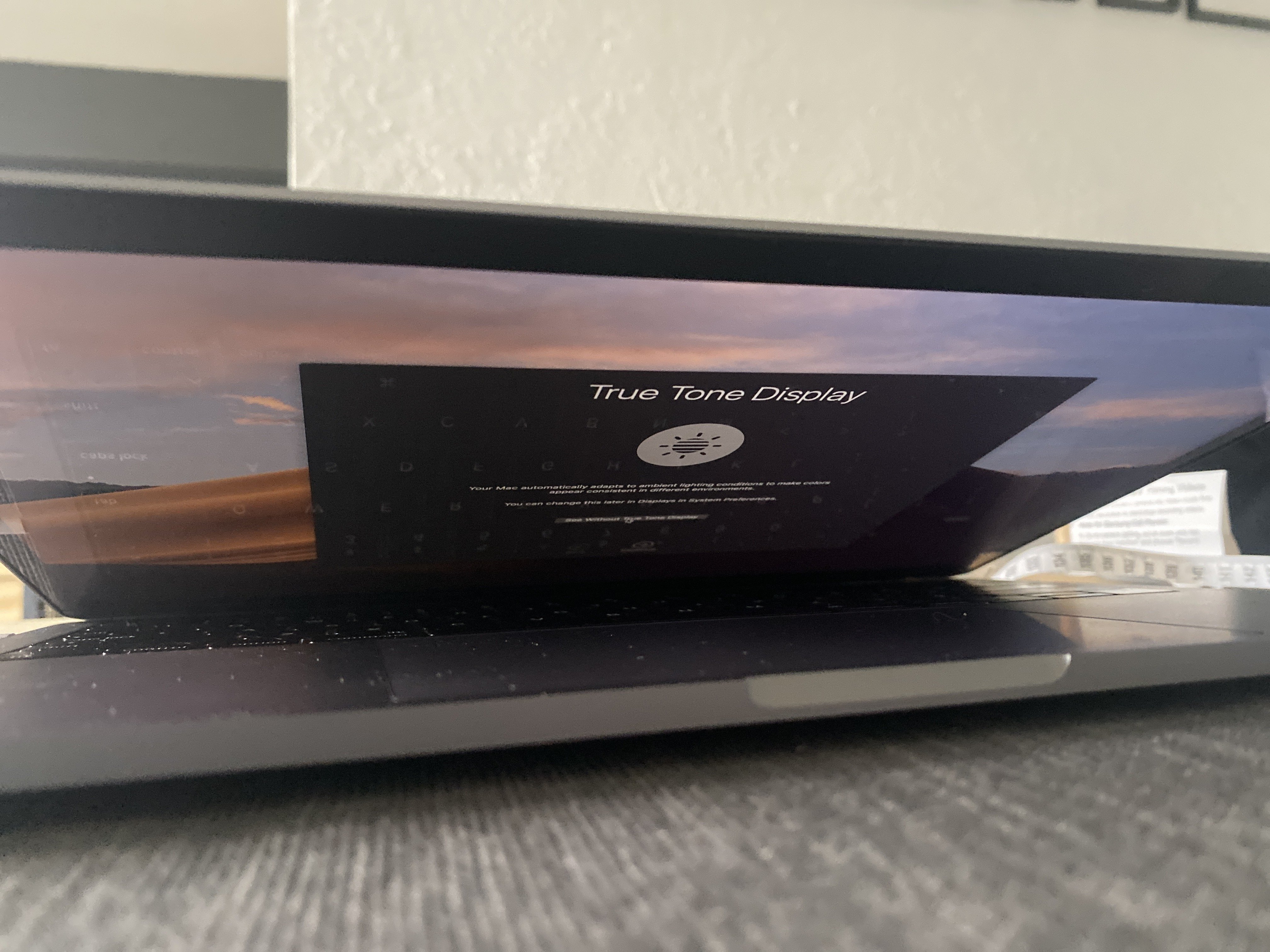

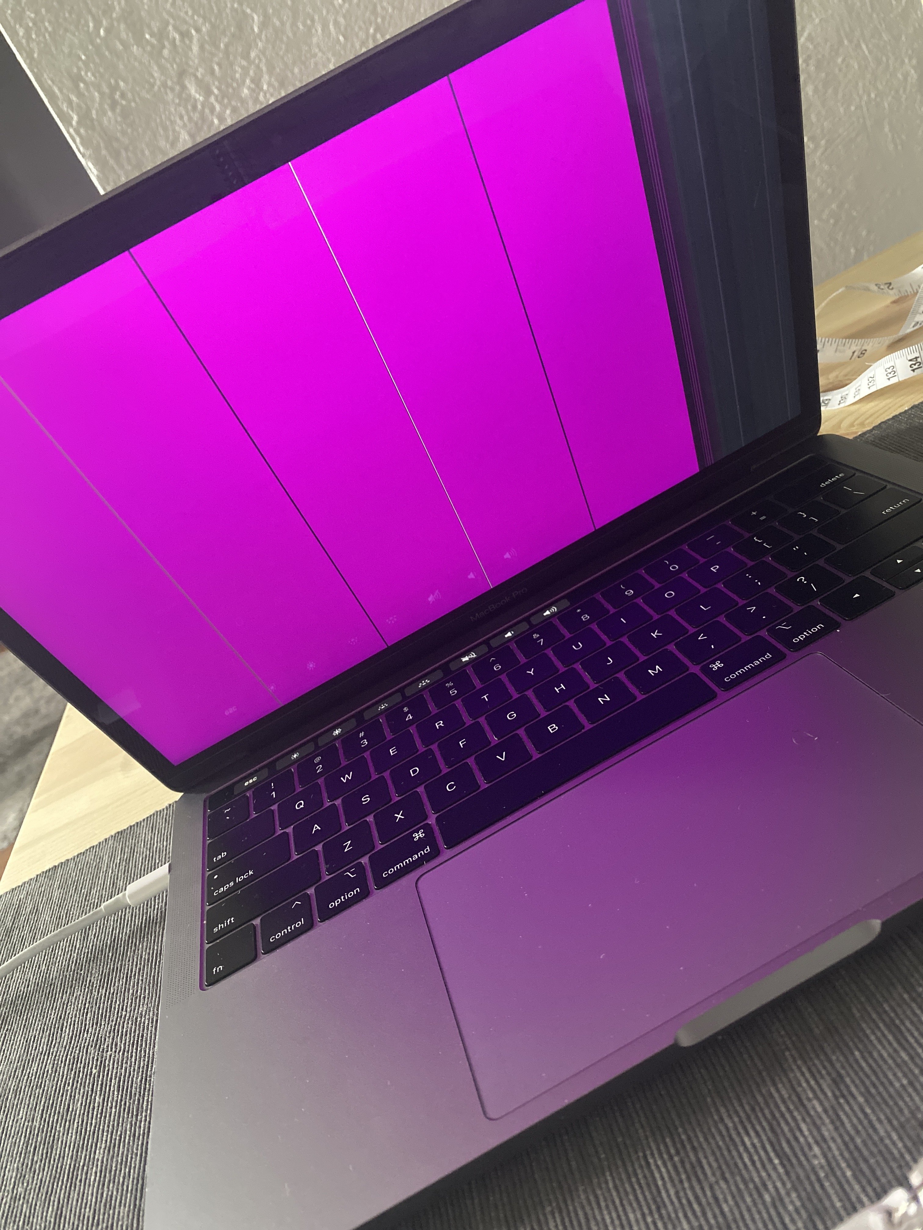

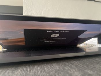

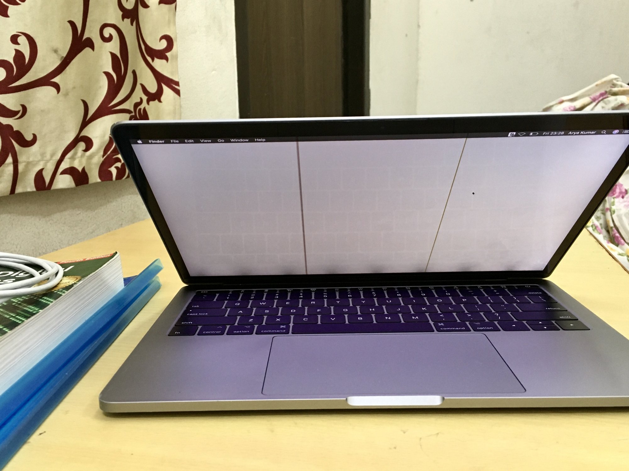

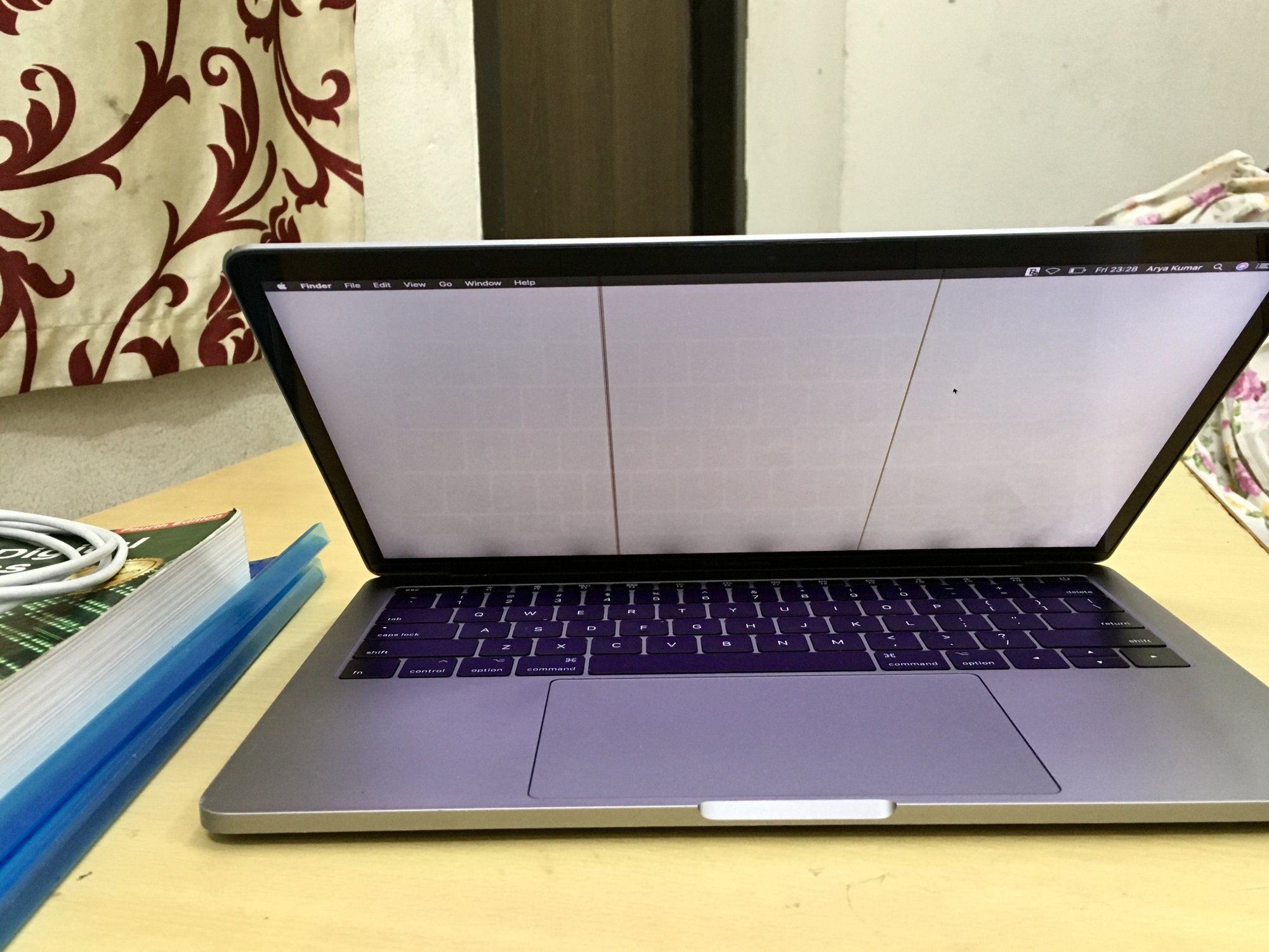

Has anyone had this problem with MB pro with Touch Bar late 2018? I’ve never got the stage light issues, but instead I’m having this problem with a blank screen, but in some angles it might work normally. I took it to the Genius Bar today and the technician suggested to replace the cable first, but if that didn’t work I would have to replace the whole screen. It’s out of warranty, so if the cable works I have to pay “only” $67 plus $110 for labor, but if it doesn’t the screen replacement is almost $600. I live in Toronto btw.
Anyone thinks my issue can be related to this Flexgate, even though it’s a 2018 machine? Any chances I can get this screen replacement for free?
Now you’re scaring me- I specifically got a 2018 last year to avoid Flexgate!

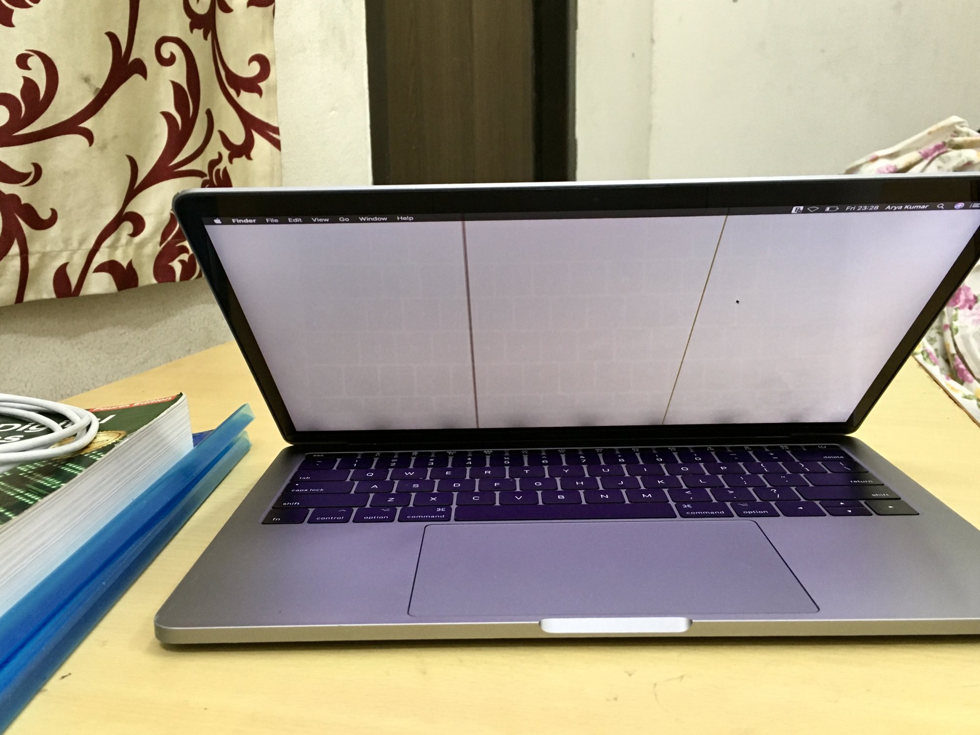

Has anyone had problems with a MacBook Pro 13 nTB model (2017) manufactured in late 2018? Mine was manufactured in late 2018 and my machine has been working great so far, but I only use it for a few hours a week and I take extremely good care of my laptop.
Since it was manufactured in late 2018 I wonder if the display cable is as long as the cable in the 2018 model...
Reactions: Arya Kumar

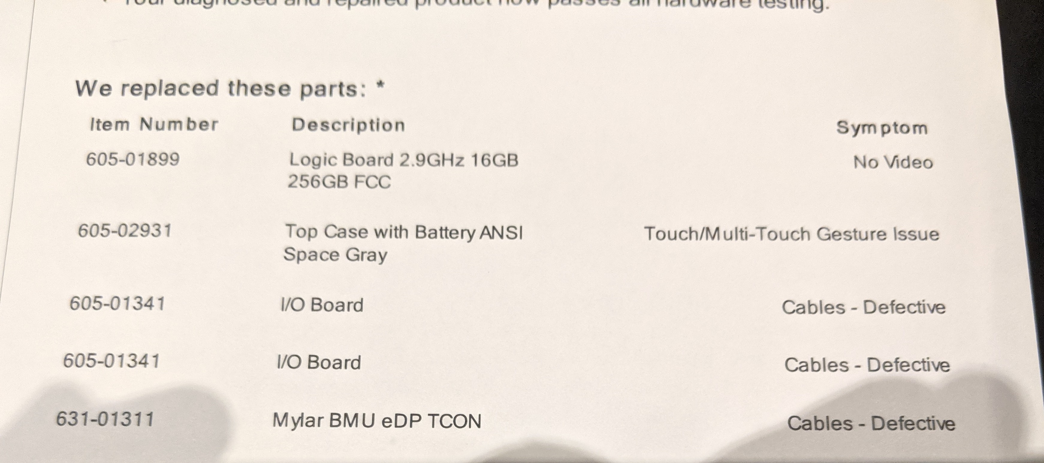

2016 MBP 15. Display just went dark and never came back; the rest seemed to work. 1 month remaining on Applecare. Took it to a store and they sent it off for repair. Fedexed to me at home after replacing top case, a cable, and the logic board.
