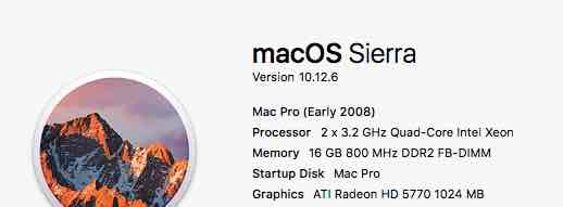

Was able to update 3.1 2008 Mac Pro to 10.12.6 via the AppStore with no issues.
The original owner of the Mac Pro here...hate to give it up quite yet!
Fresh install of 10.12.4 then updated via the Appstore on my 2008 MacPro with no issues as well. Native RX570 support is nice!
