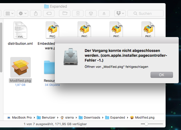

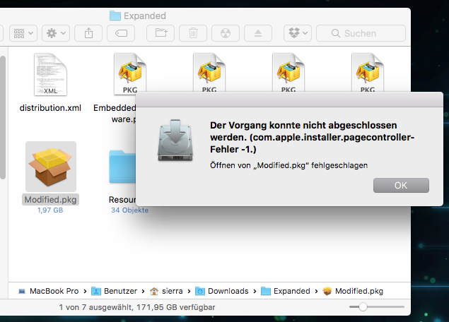

I have MBP 5,5 and i edited the *.xml File. When i open the pkg for install 10.12.6, comes error message! What is wrong?
The modified package should be on the desktop not within expanded, try moving it and see if it will install.
Can you translate the error message please.
Starting Install-Package on Desktop, i have the same error message (Google Translate: The operation could not be completed.).
[doublepost=1500553251][/doublepost]I have found the error! I remove the *.xml Extension. But in file-Information was *.xml present. After remove *.xml Extension in File-Information and repackage fixed my problem. Install and 10.12.6 works fine.

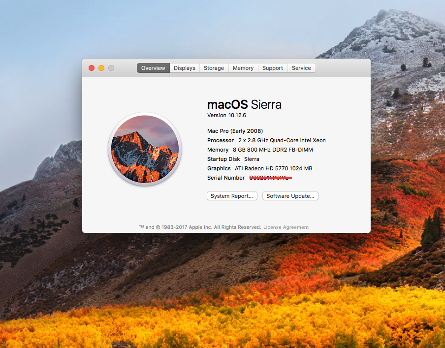

Mac Pro 2008 updated macOS 10.12.6 via App Store.
No problems..
