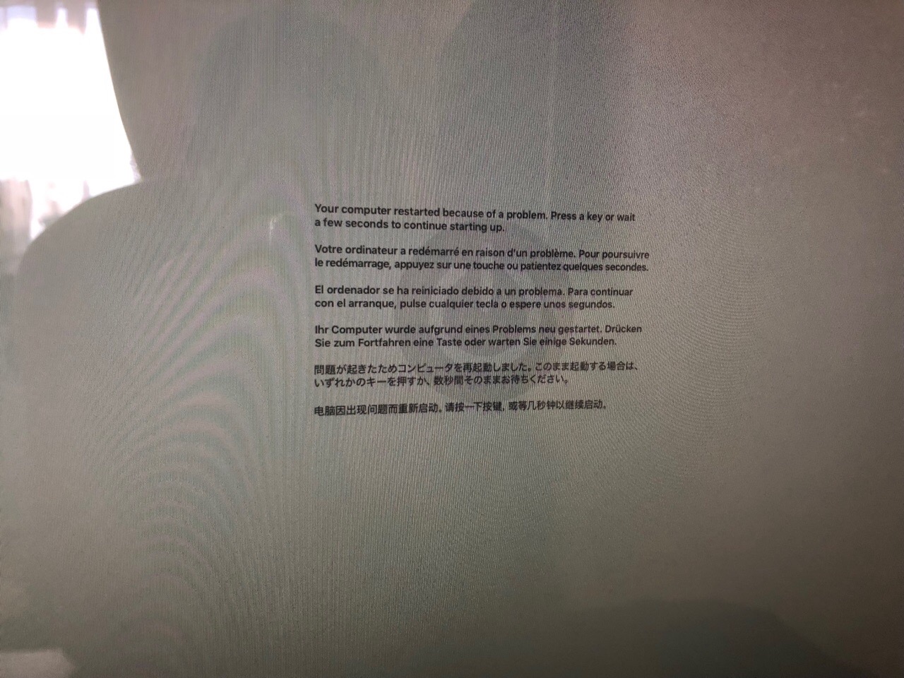

iMac 27/2011 при загрузке выкидывает окно предупреждение, подскажите в чем дело?

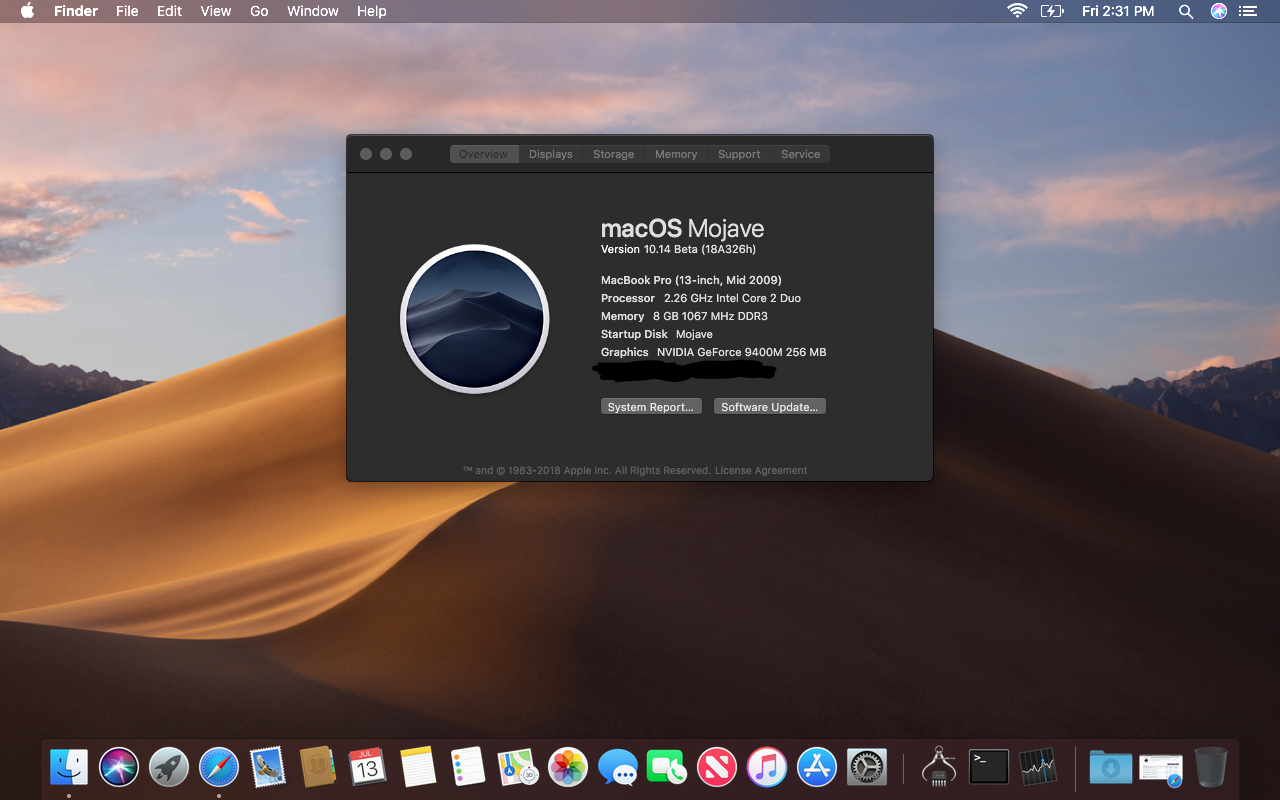

No... It's definitely in there...
EDIT: Xcode tried to link it for some reason, even though it was only supposed to copy it as a resource. Fixed now (version number unchanged).
Yep... all working now. Thanks :)
