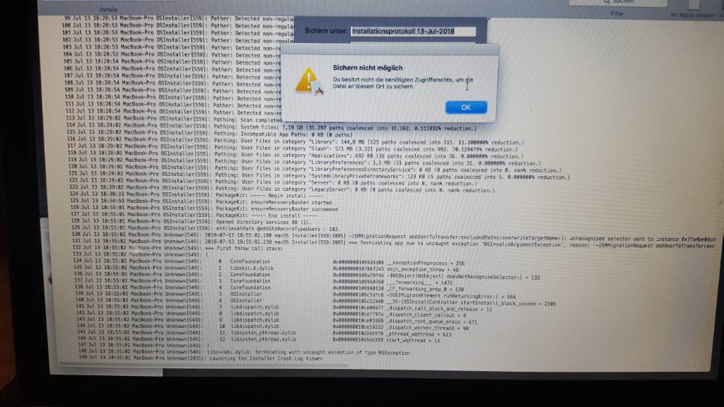

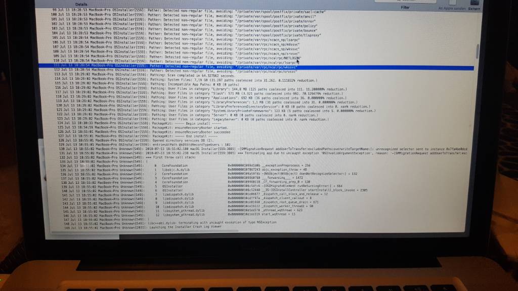

-Hi, again. I tried to upgrade my High Sierra installation but it crashes. Shows this:

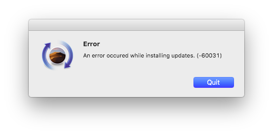

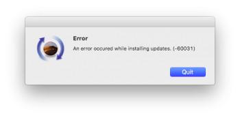

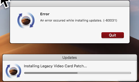

So I get this when I try to install any of the patches. What can I do?

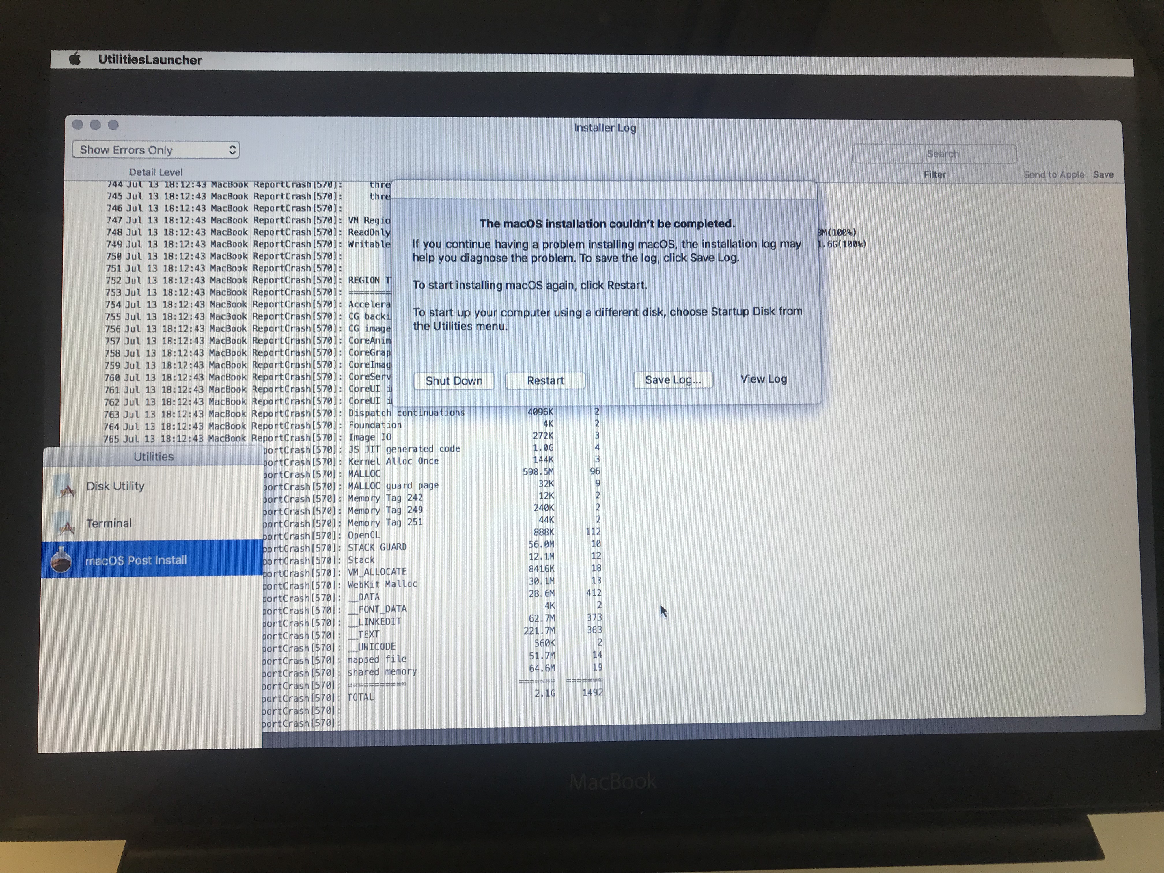

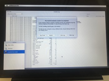

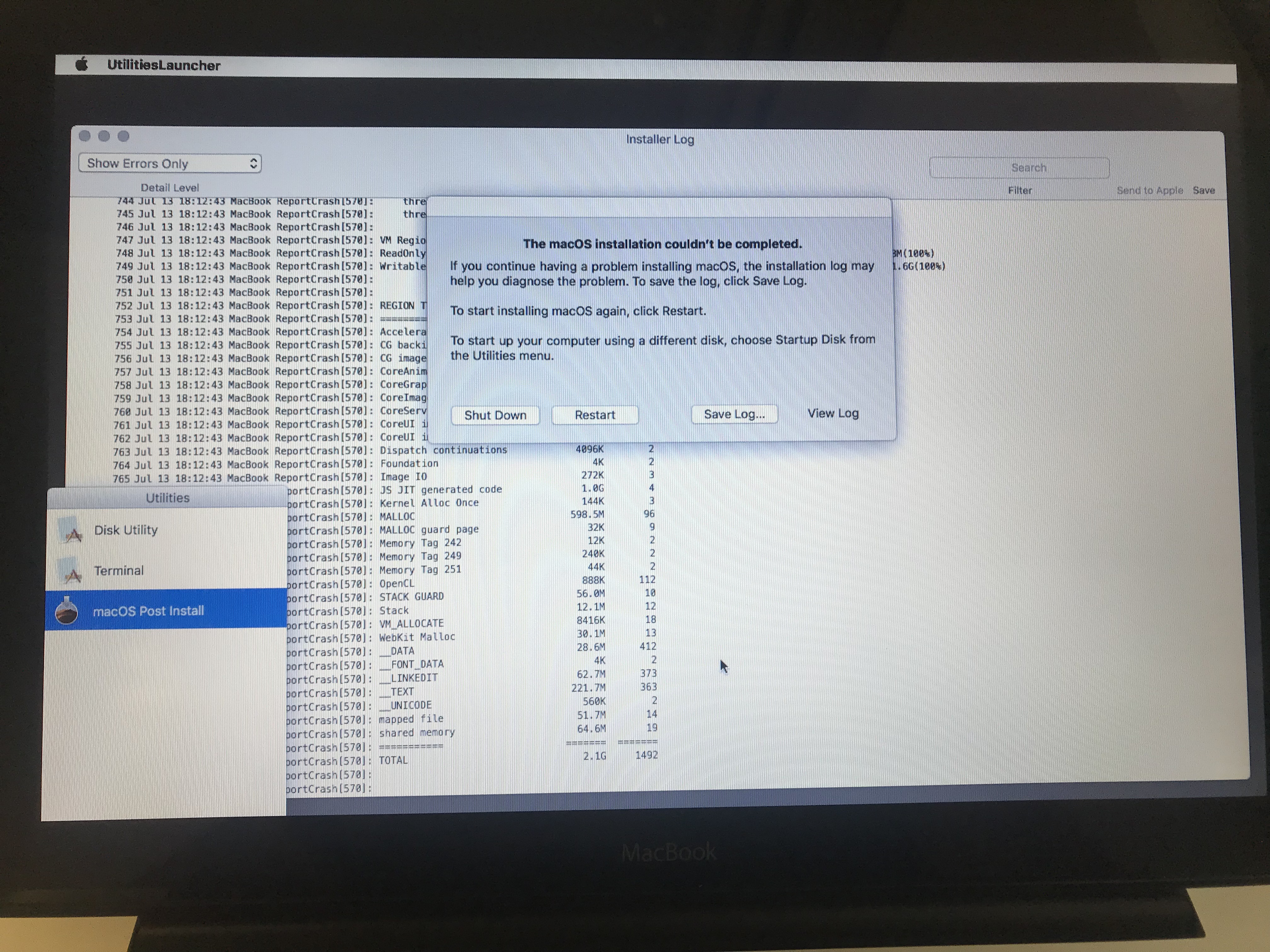

Hi hi!
Tried it today on a mid 2009 MBP.
Get this, and no boot with old high sierra...
Any ideas?
I dont have any other apple product.
Thanks ctaylora1231. That is the solution (you need to name the USB to OS X Base System). It looks like a rare bug in the USB installer creation code. I've seen it once before this occasion.
Perhaps I can help because I was able
to get mine to work after all. What my problem was, when the patcher is creating the USB installer, the USB was being renamed to OS X Base System and when the patcher is re-mounting the drive it was still looking for the name that I named the drive, not OS X Basic System. So either you need to name the USB to OS X Base System or if your first go around fails but it renamed the USB drive, just run the patcher again, took me three tries in a row before it completed without any errors .

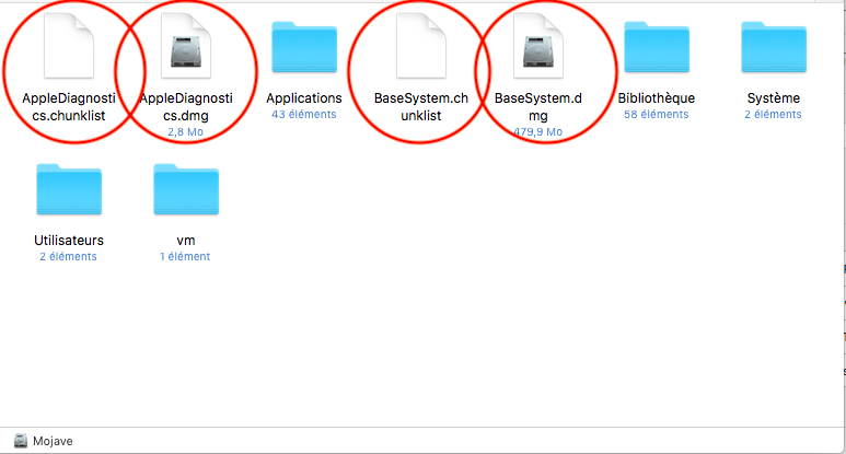

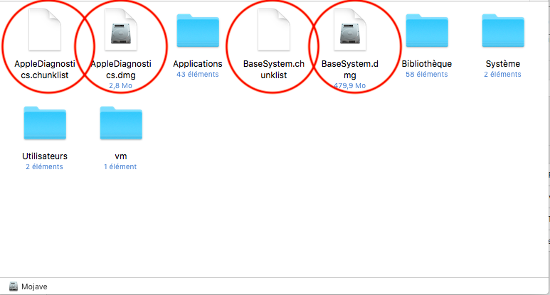

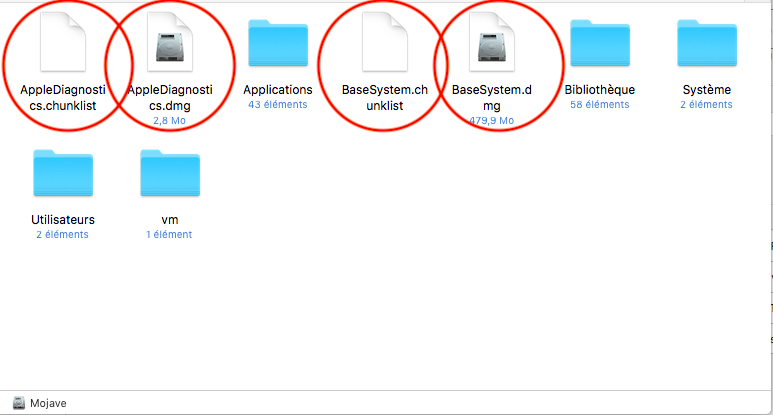

@dosdude1
is it safe to delete these files from the root after installation and post-patching?
Thank you again this tool and for your time !
You ran the patch on a USB drive, right? NOT on the volume you intended to install macOS onto? Those files are copied to the drive used as the installer. If those files are in the root of your hard disk, then yes, you can delete them.
