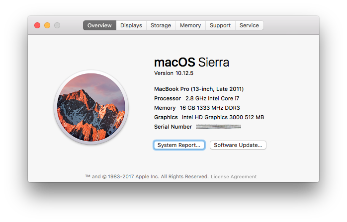

I'm using a MBP late 2011 and had no issues installing 10.14 on a High Sierra VM in Parallels.
The only problem is that once installed the macOS software becomes unresponsive?
Has anyone else tried this or know what the problem is?
Here are my specs:
It appears to be working here:
In VM there is not hardware acceleration, so it is the unresponsiveness.

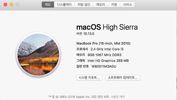

well, i have a question.
im using macbook pro 2010 i5 with intel HD Graphics 288M.
if i using mojave with host os, Can I enable openGL when i booting with safe mode?
or
Can I use mojave with vmware Fusion?
or
You have an Intel HD Graphics former to HD3000. I guess that it would load the Intel kexts, but I don't know if it would be effective. Remember that the kext load is a requirement for starting to work in OpenGL compatibility.
You can use Mojave with VMWare, but remember that it's slow currently.

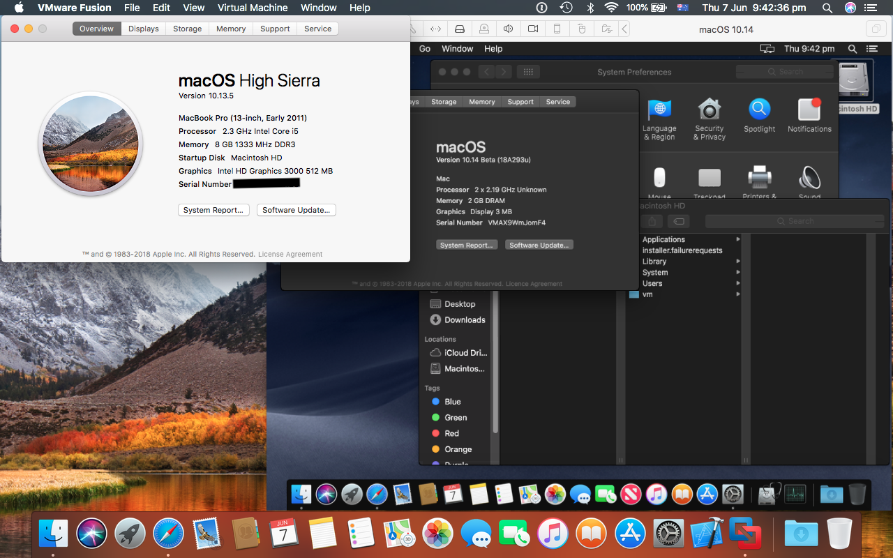

Okay yeah, but in the screenshot the guy had it working, and I have better specs than them?
Interesting question, yes. I would want to know what method used to do this.

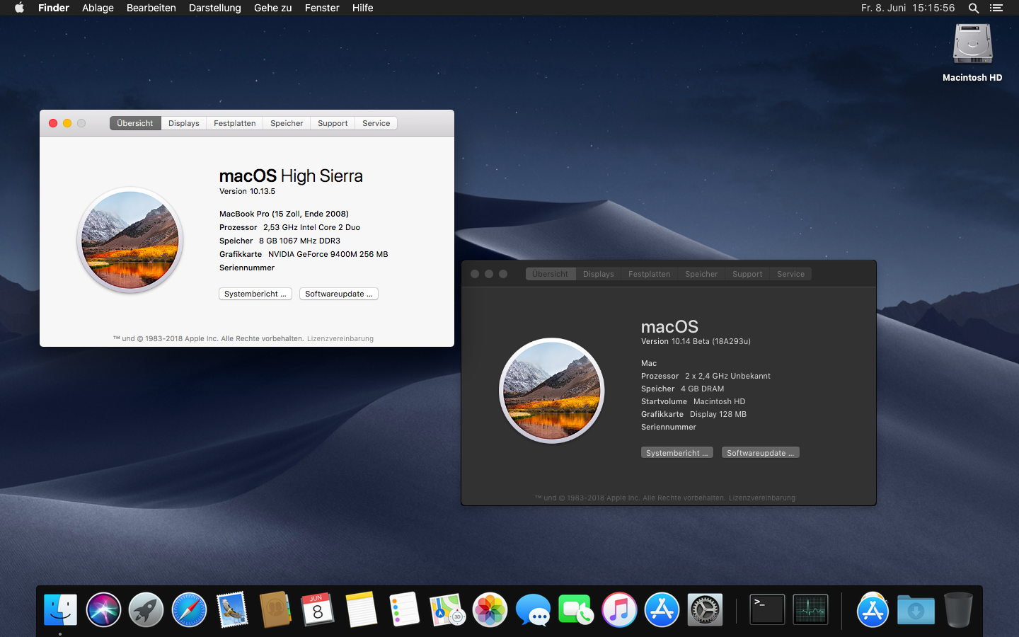

is it possible to get this working on the MacBook5,2? since it has an Nvidia 9400M GPu in it
Maybe but we're concentrating on the computers which are newly unsupported.
