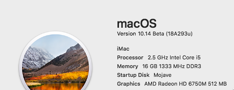

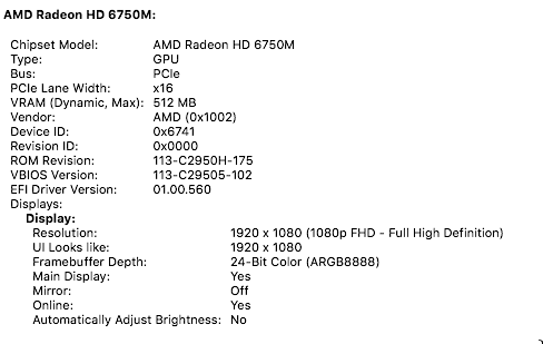

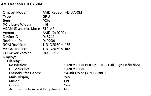

I took Mojave beta 1 for a spin on my 2011 iMac which isn't supported. The WIFI card isn't found and the graphics driver are not loaded probably due to the Metal requirement. Otherwise, it didn't look too bad. The stocks.app using UIKit(?) loaded with a blank window only but the menus were functional.
I have the same computer. How did you accomplish this ? Did you install from usb bootstick adding "-no_compat_check" to kernel boot arguments or did you install on virtual machine ? Thanks,
Clone the Mojave installation from a supported machine. Replace the PlatformSupport.plist with that from a High Sierra installation on the iMac and add the above kernel boot argument.

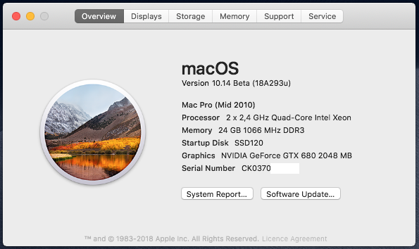

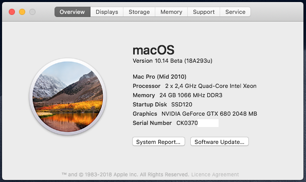

DP1 won't install on the 2010/2012 Mac Pro. Need to wait for a future beta.
It will when you have the right video card.

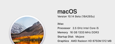

Nice, i was finally able to install Mojave DP1 on my iMac Late 2009 27".
I needed to boot in -x in order to finish the setup and get to the desktop. Finder and AirPort doesn't work.
Everything else is working fine. I can connect my KB and mouse via bt and ethernet for internet access.
