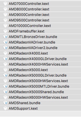

Does anyone know if the video card drivers from Mojave can be used in High Sierra? I bought a MSI RX-560 card (one of the 2 cards officially supported for Mojave in a 2010 Mac Pro) and it works very well in the PB Mojave, but it has significant problems in HS, both when performance stressed and when the Civ4/5 game's 1080p full-screen mode is used (under no stress).
I notice the AMD drivers are a different version in Mojave than HS (version 2.0.36 Aug 23, 2018 versus version 1.68.20 Jun 29 2018 for HS). I'm thinking the Mojave versions may have been optimized/fixed for using the RX-560 in the 2010 Mac Pro because that card is officially supported, but not in the HS versions because it's not officially supported. I don't know which of the Mojave AMD drivers (listed below) would apply to the RX-560 card. Can anyone advise if its possible to copy and paste them into HS, and which drivers would apply to this card?
Nope, two reasons.

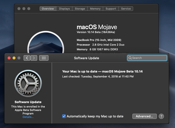

My Mojave boot partition is APFS. I thought it was the other way around - software update if APFS, install and patch if HFS+. Anyways, I went ahead and did the install/patch process to implement the update.

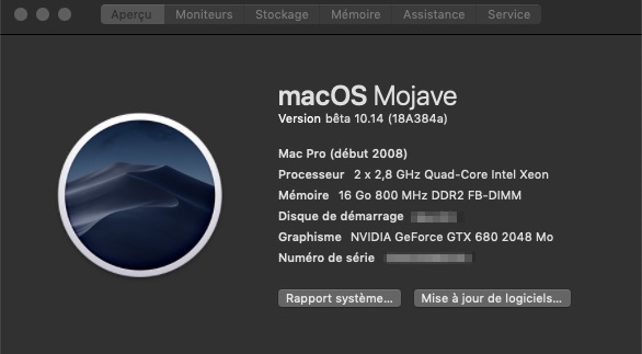

Has anyone downloaded the Installer from dosdude1's Mojave Patcher? Is it the DP10? The reason I ask is that if I download that, I can use it on all 3 laptops I have - 2 unsupported, 1 supported. No point in downloading thru the updates when I can use one installer on all of them. Thanks.
Yes, it's DP10. Downloaded and installed last night on my MBP 5,5, build 18A384a installed.

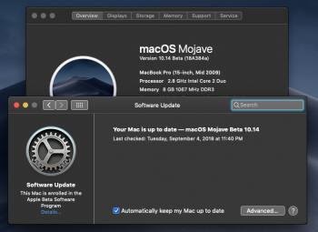

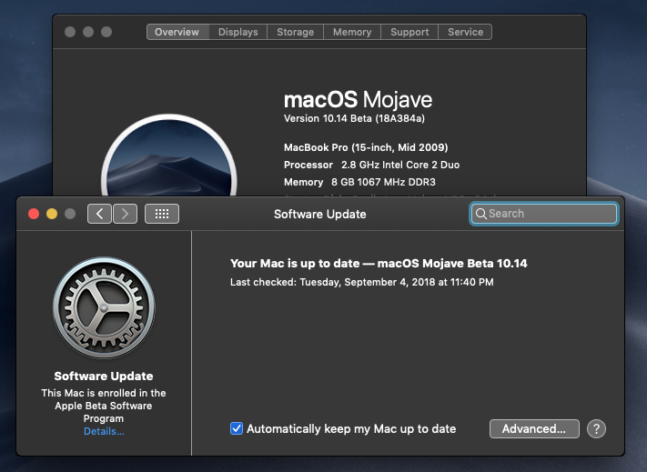

Hi :) I'm running 18A326h on MacBook5,1, any suggestion about updating to 18A384a, System Update not showing any update
