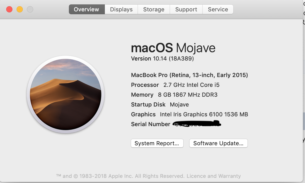

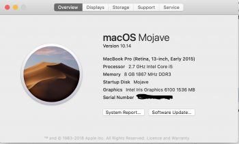

Mojave Developer Preview 11 successfully updated via SystemPreferences|SoftwareUpdate
The build number does not show this time,
Click on 10.14 under MacOS Mojave in the About Mac dialogue and the build number will appear.

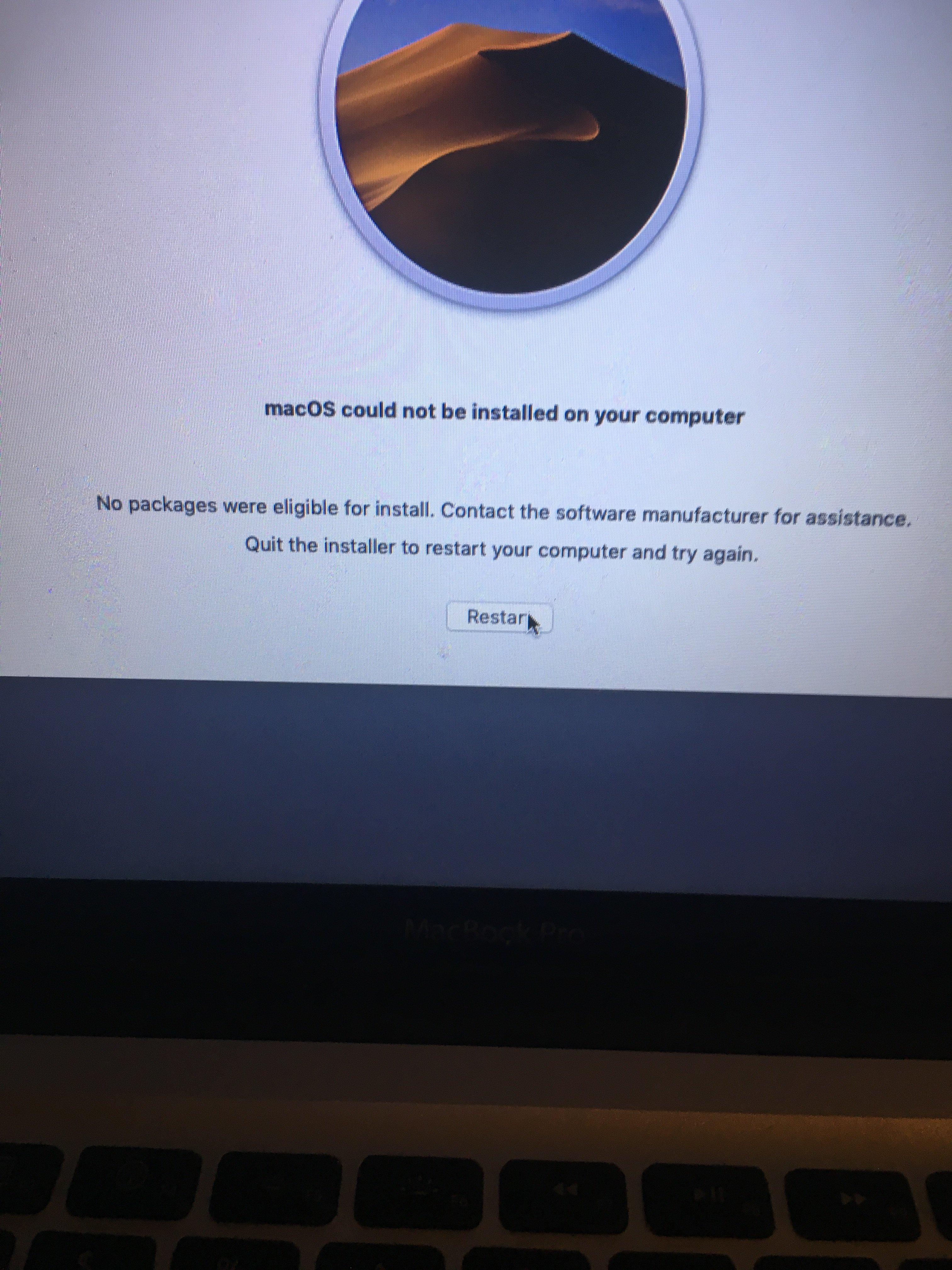

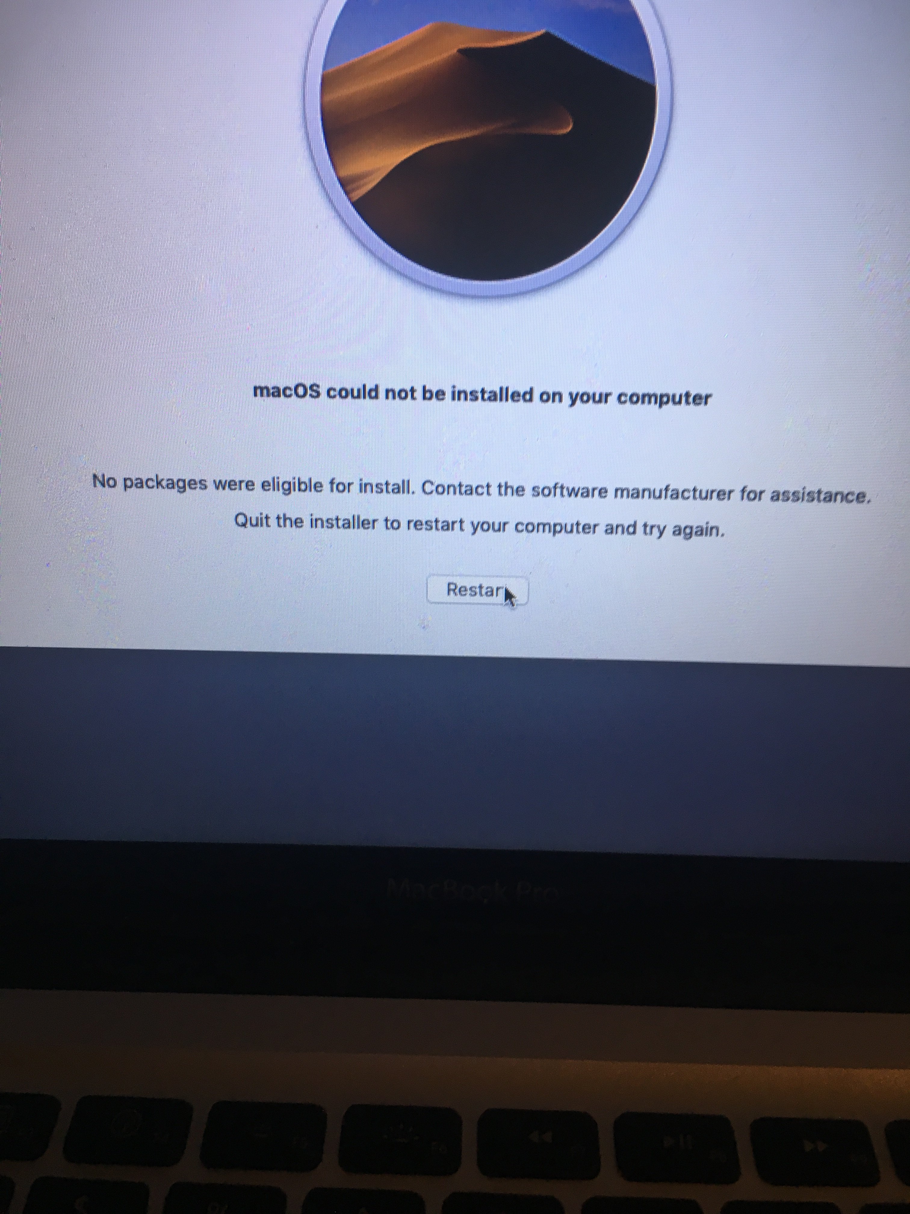

I tried to install macOS Mojave Beta 11 in the meantime on my MacBook Pro 15 inch 2009 and I got this (Attached Picture). I don't know what is going on?
Reactions: TimothyR734
Did you use Mojave Patcher to convert the Mojave Beta 11 into a patched usb installer that would be usable on unsupported machines?
