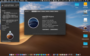

@dosdude1 Your app is not set to download the full installer app of PB 10 or DP 11? The version number is 14.0.21 , like in PB 9/ DP 10 .
I have version 1.2.0 of the patcher it downloaded and installed the latest beta

There isn't a full installer from Apple for beta 11. Everyone is using some variant of scripting to pull down the component installers and build a full installer.
https://github.com/munki/macadmin-scripts/blob/master/installinstallmacos.py
There is. Otherwise installinstallmacos.py would not work.

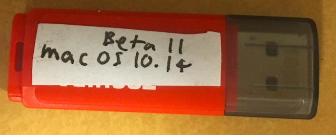

I have a bootable usb of beta 11 to prove it. And I used it to install beta 11 onto 2 computers.
So the full installer definitely exists. It's just that some have had difficulty getting it - and that is where installinstallmacos.py comes in handy to get it via terminal instead of trying via the mac app store or system update preference pane.

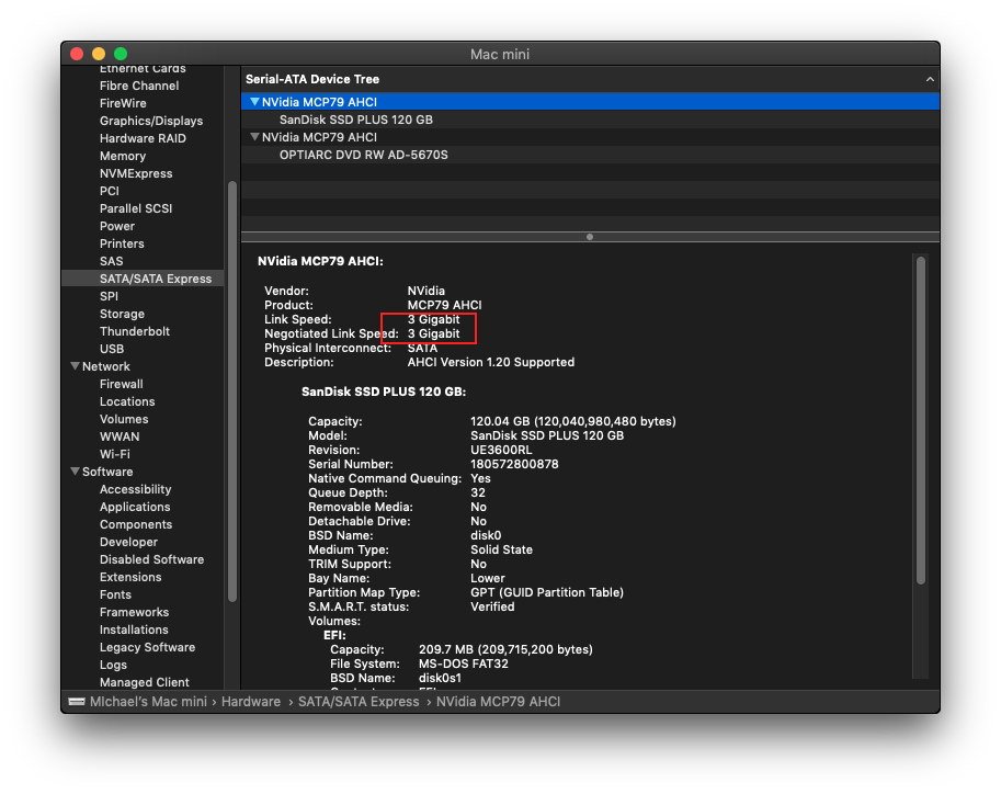

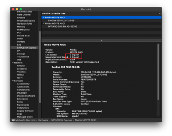

I did a post about the "Negotiated Speed" that is the effective speed you have to verify on a Mac SATA SSD.
I looked at your article, so how do I find out? This looks way above my skill set. I have an SSD on my MacBook Pro Mid 2010 7,1 and I just did the install. Is there a way to test that one and then find out about the Mini?
You won't have a mac with more than 3 Gigabit link speed unless it's a 2011 mac or newer. It started with Sandy bridge chipsets.

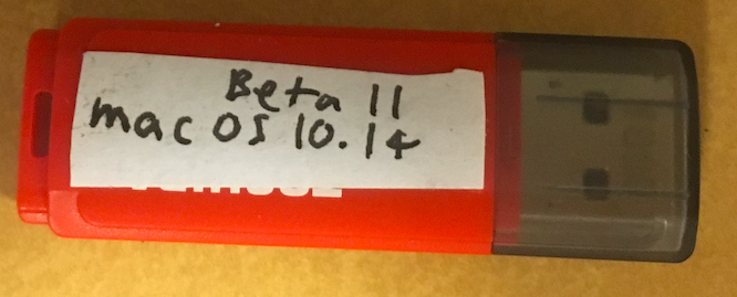

Agree, in fact I wrote MCP79 is SATA2 controller, it's not said that every Sandisk SSD will negotiate 3 Gbps, probably the most recent you buy today could give 1,5 Gbps , while instead older controllers work better with older logic boards.

Theoretically you could buy the same SSD you use on MBP 2010, but that's MCP89 AHCI a new revision, but I said between lines, you can buy even the cheapest SSD for your mini and it will work, but probably at 1.5 Gbps Negotiated speed that is half of its capability and efficiency. Even on amazon products reviews you can find advices for old macs using newer SSDs.
The most important feature to me when installing a SATA SSD into an old mac is Negotiated Link Speed rather than "Link Speed" (that is a fixed value based on the logic board controller).
On a MacPro 3,1, the SanDisk 3D Ultra negotiates 3 Gbps under both patched High Sierra and Mojave.
