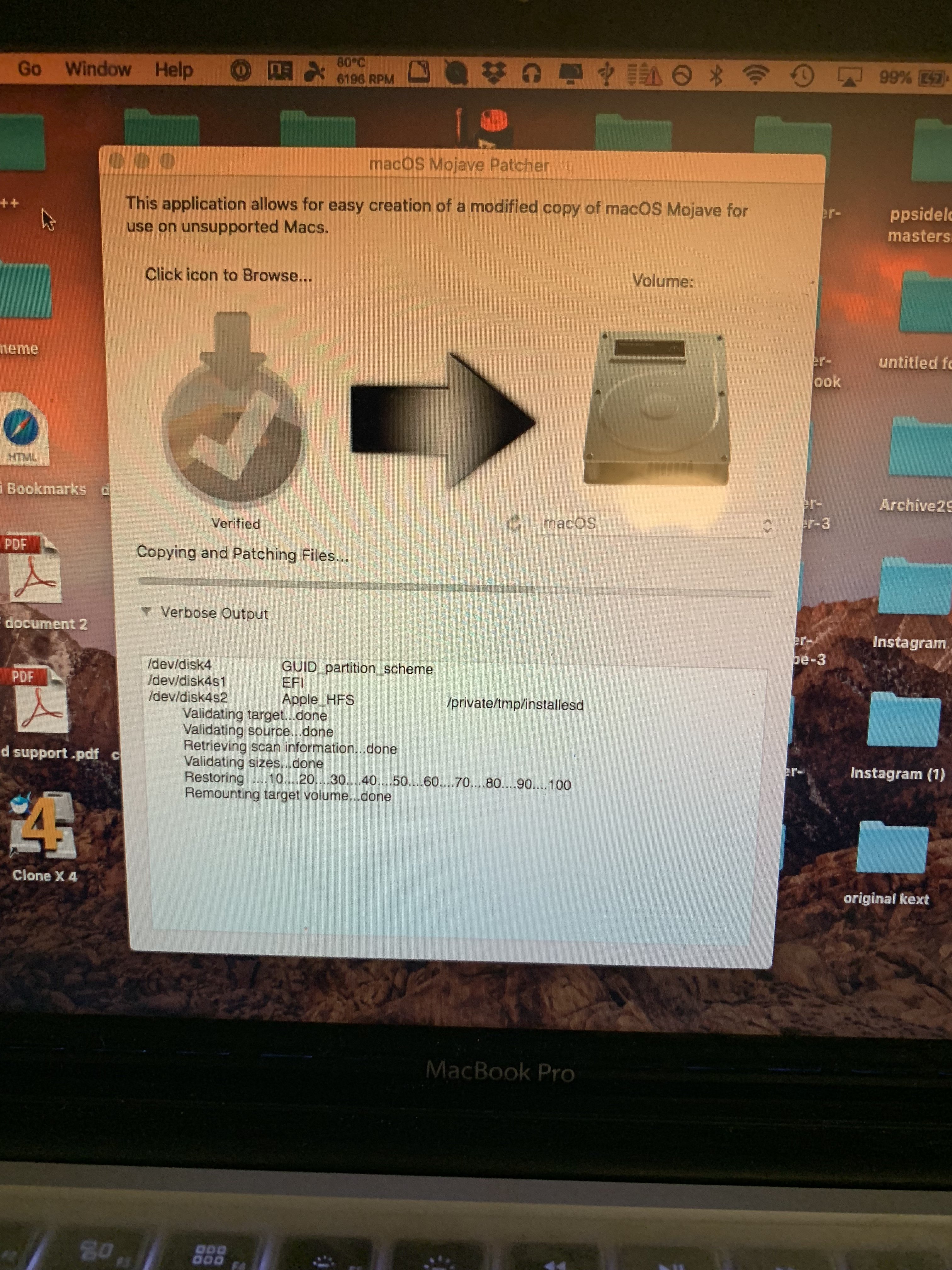

Can someone help me get past this

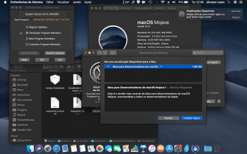

Hi there, today I got the message that I had an update, (I'm enrolled as a developer) 10.14.1 I downloaded the file 1.99 gb let the system reboot, installed the upgrade and reboot again the progress bar was at 100%, and stayed like that for about 45 minutes, so I decided to reboot again and the system would boot to full progress bar and do nothing, then I applied the patch and nothing changed, the solution was to re-install Mojave 10.14 from the usb with all the patches, guess I have to wait until someone finds out what this update is breaking.
It has already been noted that the 10.14.1 update contains boot rom updates for the supported machines. This always breaks the update process on unsupported machines. So the 10.14.1 release will likely have to be installed via the full installer.

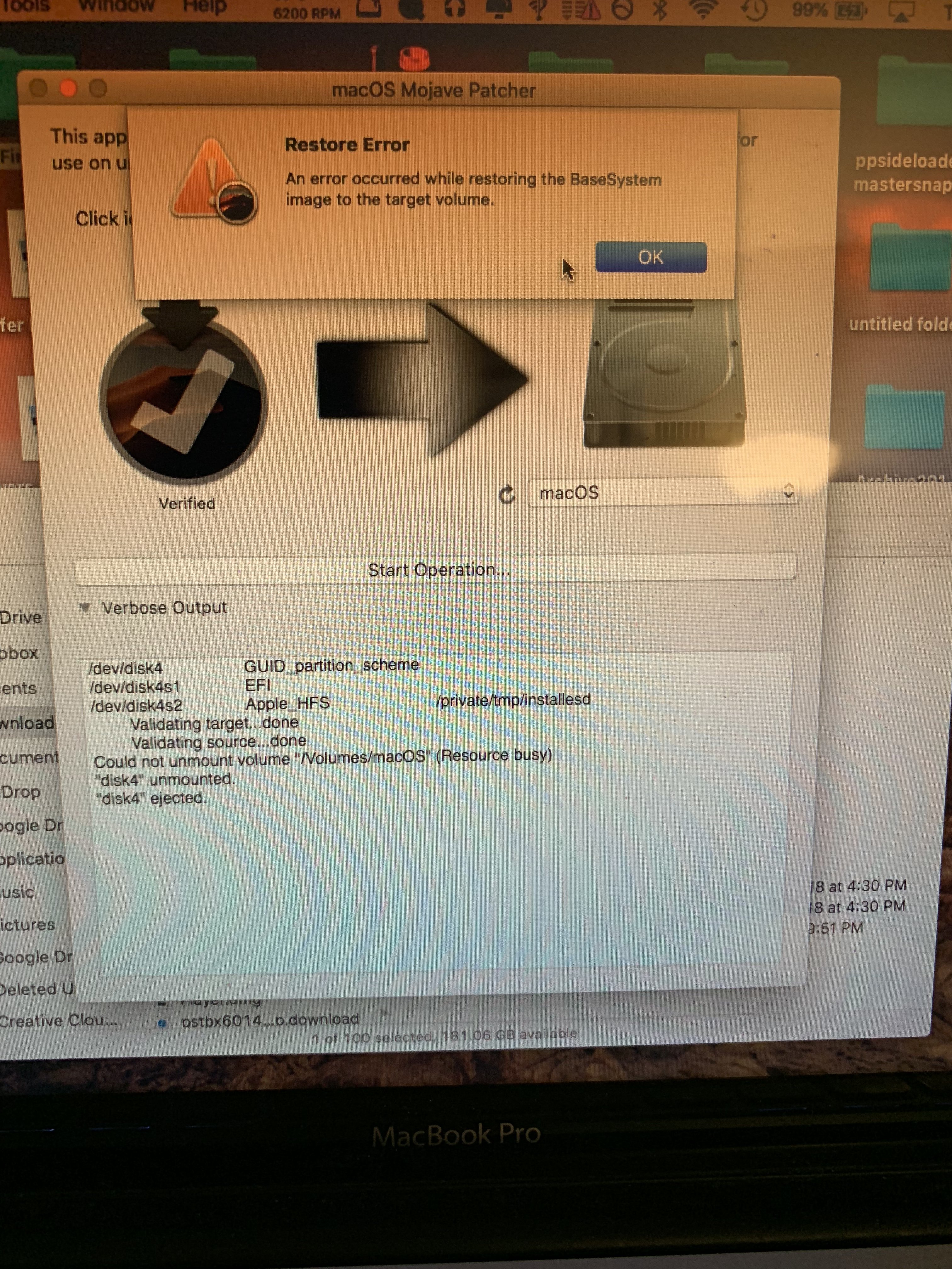

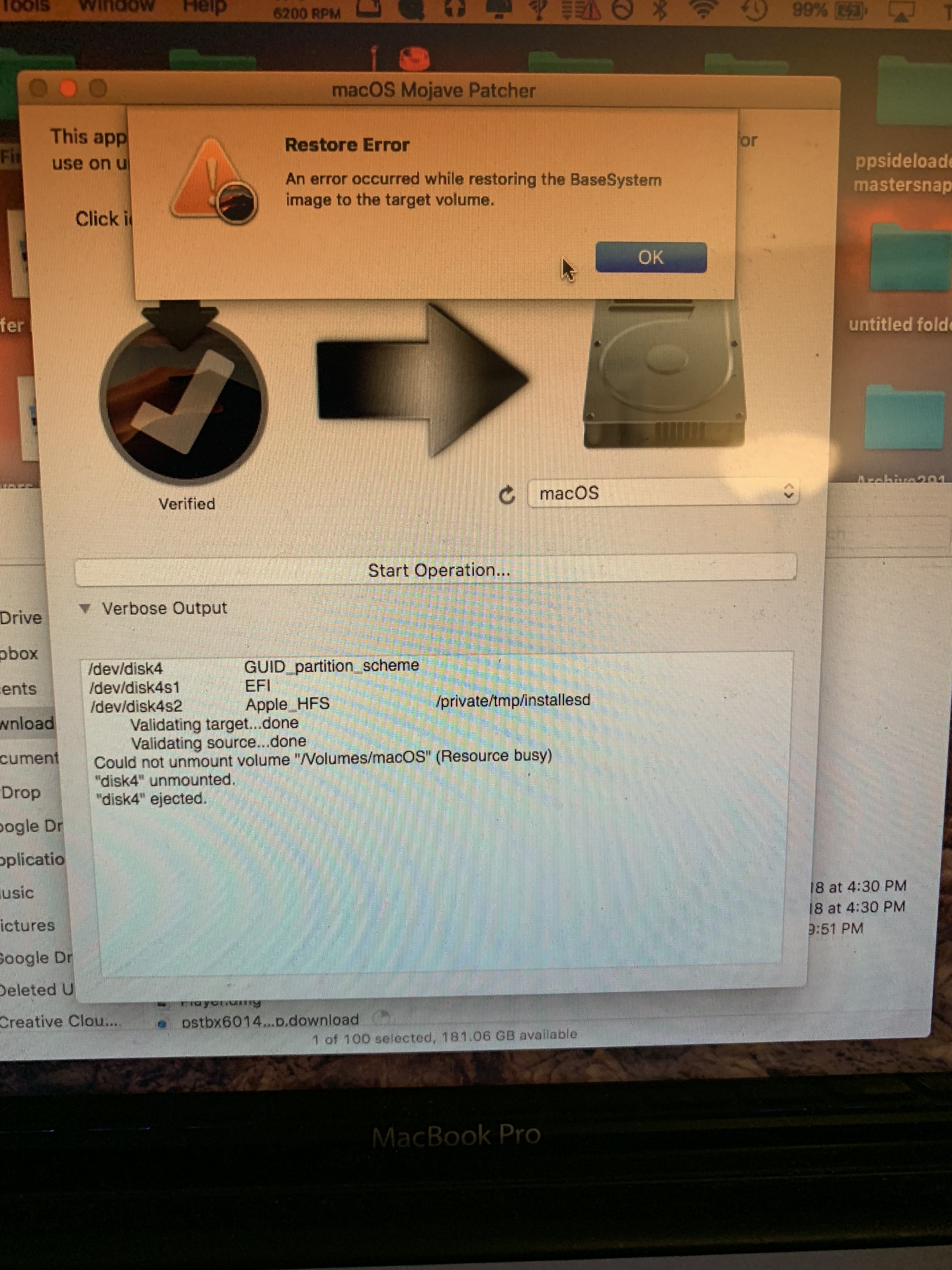

Looks like it can't unmount the external drive that you're making the boot disk on. Something's trying to use it, which prevents it from unmounting. A reboot will almost certainly solve this.
You the man
Reactions: TimothyR734

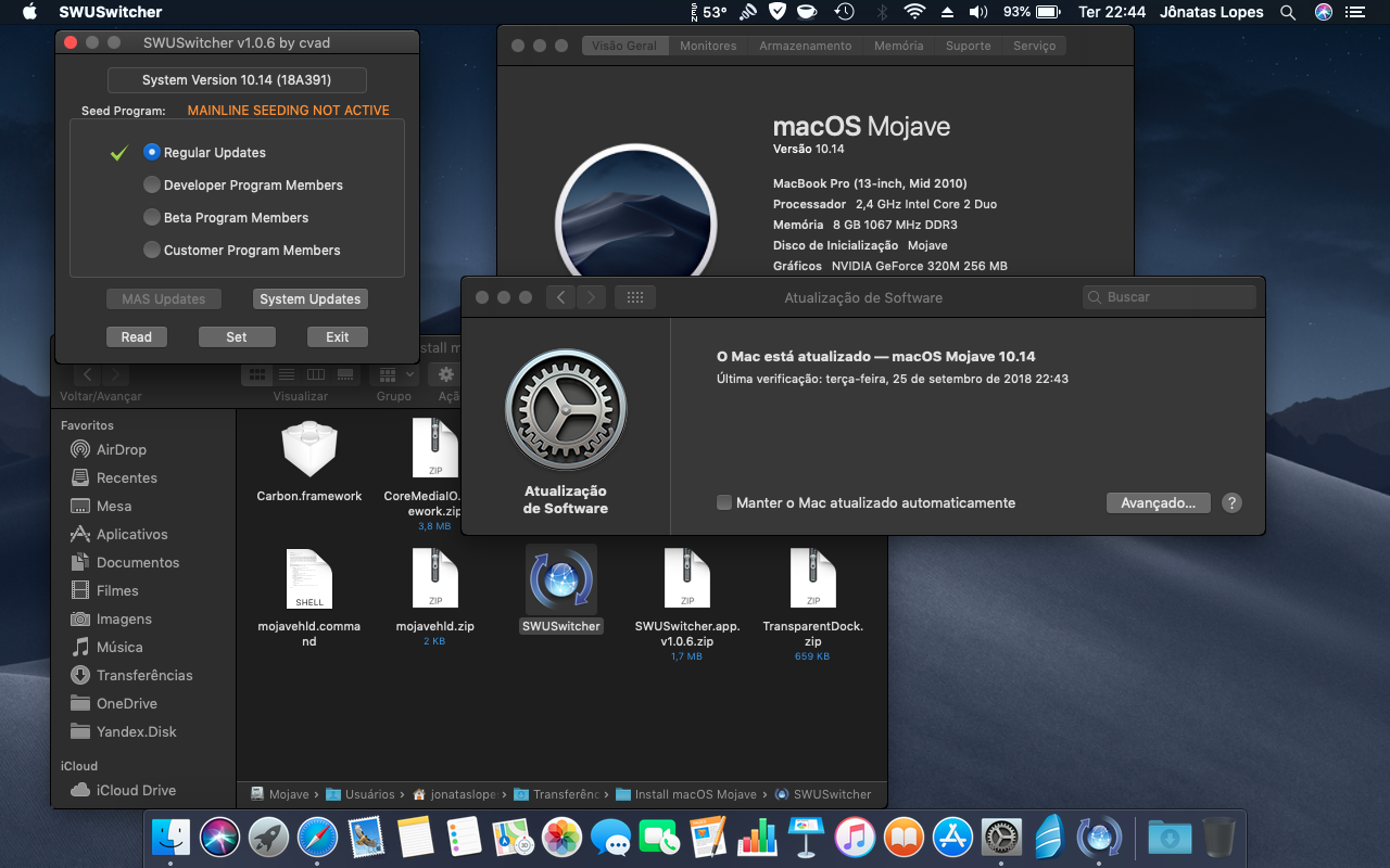

InsanelyMac - Software Update Switcher 10.8-10.14
[doublepost=1537926540][/doublepost]Working ...

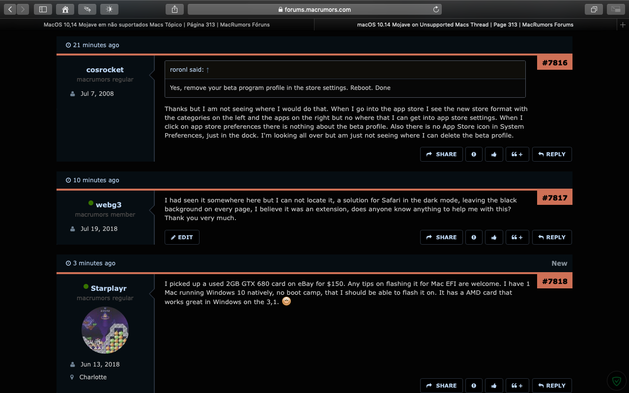

Yes, remove your beta program profile in the store settings. Reboot. Done
Thanks but I am not seeing where I would do that. When I go into the app store I see the new store format with the categories on the left and the apps on the right but no where that I can get into app store settings. When I click on app store preferences there is nothing about the beta profile. Also there is no App Store icon in System Preferences, just in the dock. I'm looking all over but am just not seeing where I can delete the beta profile.
Try this. Go to the Apple Menu. Select App Store. Search for Mojave. Click Get. Then it should search for Mojave and active the downloader in System Preferences. Then you can use the Installer found in /Applications/Install macOS Mojave and copy that to another drive or desktop and link that to the Dosdude1 patcher. Make a new patch disk. done. This is assuming you are on an earlier version of Mojave (pre-release).

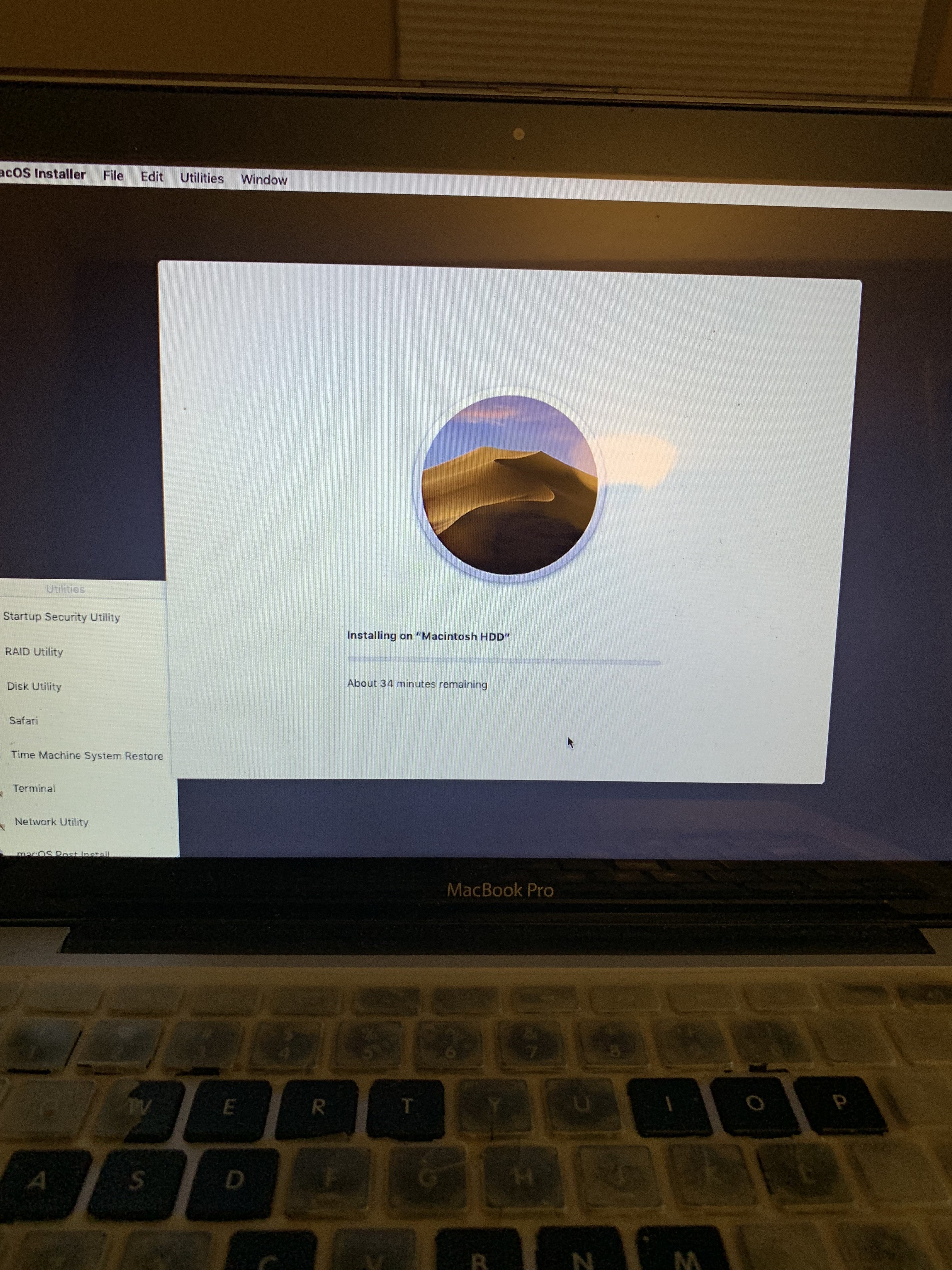

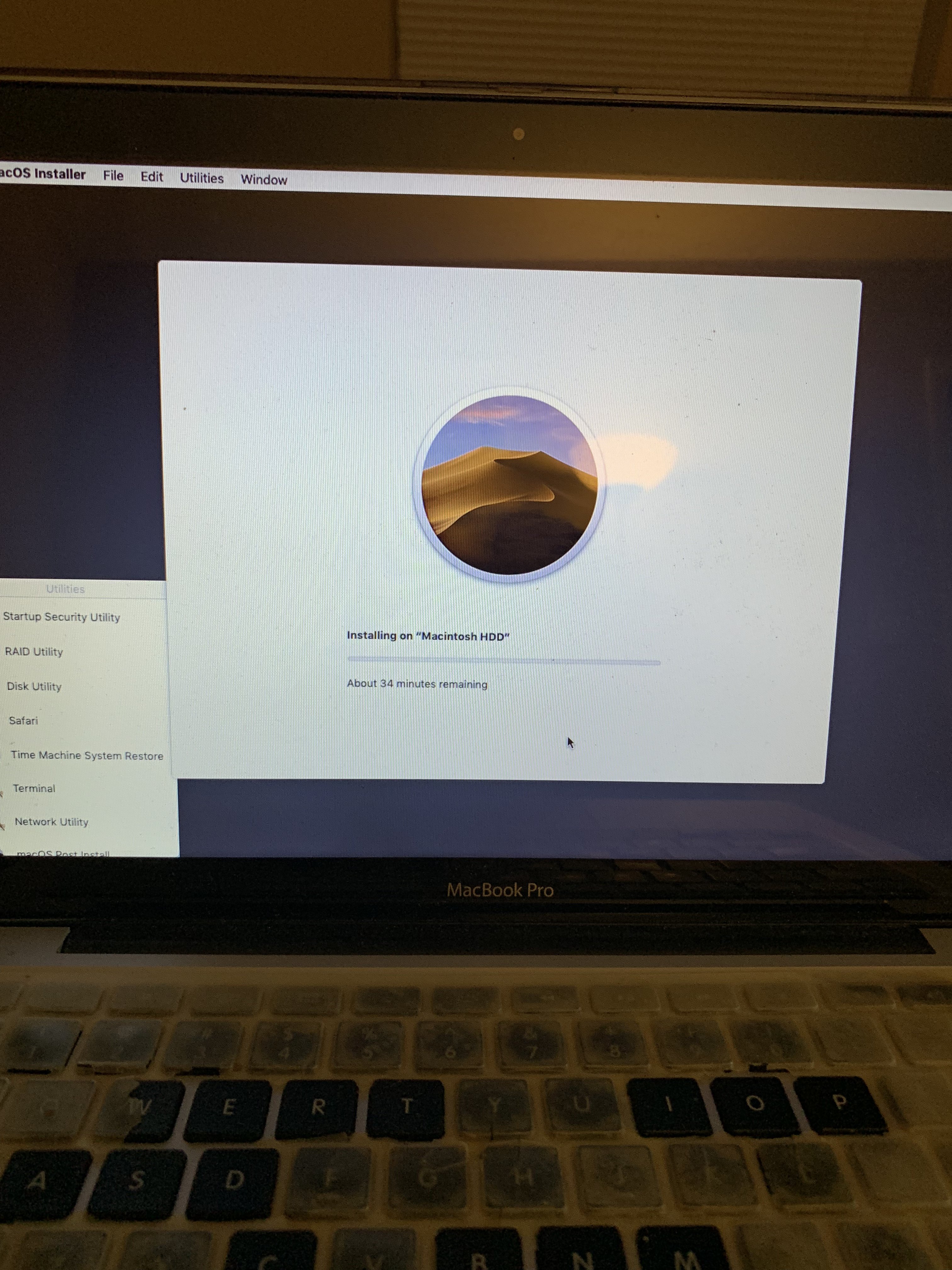

Hey my install being saying this for about 30 minutes and I haven’t seen anything going on with the usb drive lights ,do I have to install it on a SSD drive or can I use the HDD
To remove beta profile go to System Preferences>Software Update, then on the lower left after it runs you will see in Blue details. click that and you get the removal option.

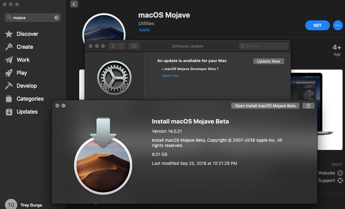

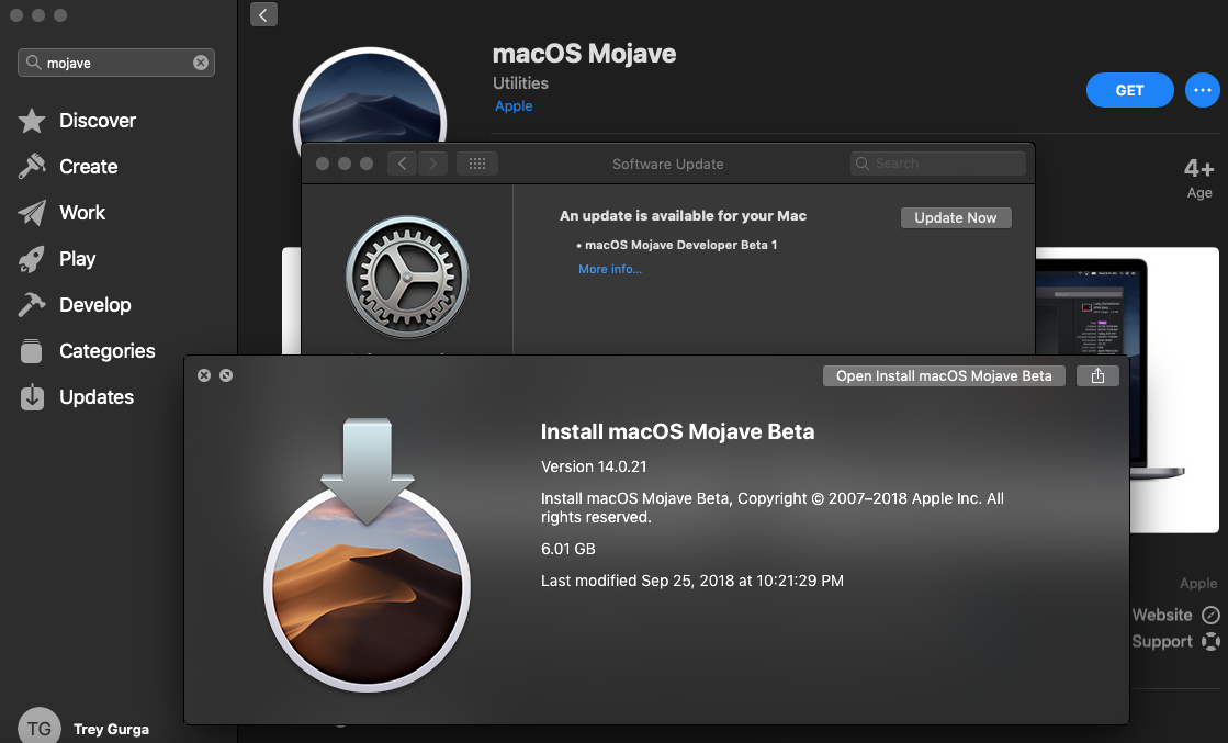

Very confused about something. Currently on the GM, not the final release. Went to the app store, searched Mojave, clicked Get, downloaded the installer from system update. However, it seems to be downloading "Install macOS Mojave Beta" Installer 14.0.21, not "Install macOS Mojave" Installer 14.0.22. The first time, I downloaded it and saw this, then deleted all my installers out of my applications folder to see if that was affecting it. However, after running it 2 more times, its still downloading the beta and not the public version. Am I doing something wrong? To be clear, this is downloading from the app store, not from the mojave patcher.
