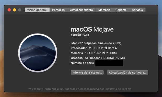

Installed on my old iMac late 2009 and it works fine, except for the camera.
Thanks!!

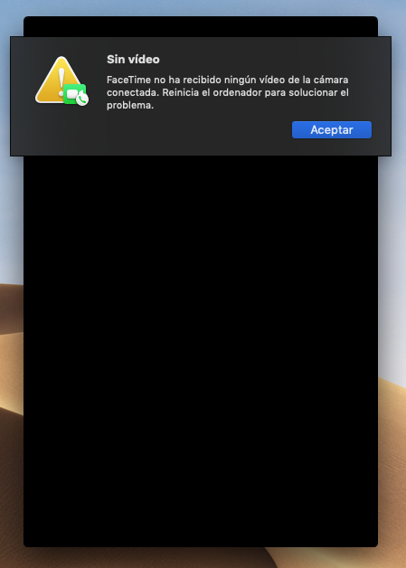

After reinstalling iSight patch several times, still can´t access to the camera for FaceTime on my iMac late 2009..

iMac 11.3. First updated from the previous version-got such problems as in the video. Then put on a pure SSD-the problem remained the same. Wrong colors, very slow work. What is it?

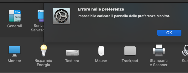

Installed flawlessly Mojave over High Sierra as an update on a 8,1 2011 MacBook Pro. Everything works out of the box, thanks. Then I searched for the Night Shift patch on GitHub, now I've the toggle in the Notification Center, it works but Monitor Settings won't open and I can't adjust the backlight with the keyboard. Someone has found a workaround?

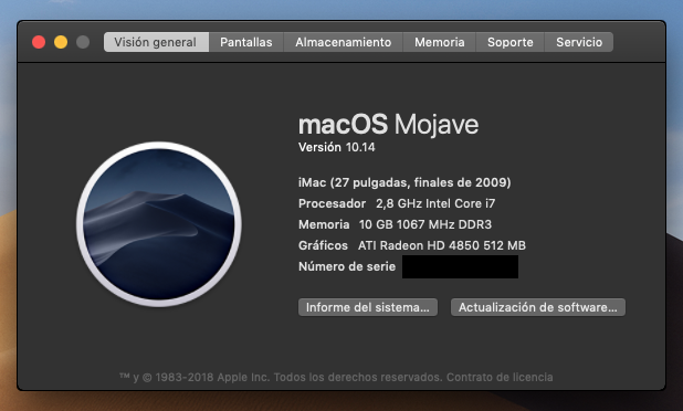

The problem is your Radeon HD 5670.
[Excerpted from http://dosdude1.com/mojave/]
Known issues:
- Graphics anomalies: Currently, pre-metal video cards used in Mojave will produce a weird darkish grey Menu Bar and Finder sidebar when using the light theme. In the dark theme, however, these anomalies are not present.
- AMD Radeon HD 5xxx/6xxx series GPU acceleration: Currently, it is not possible to get full graphics acceleration when running Mojave on a system with a Radeon HD 5xxx or 6xxx series GPU. This includes the 15" and 17" MacBook Pro systems (MacBookPro8,2 and 8,3). If you want to enable GPU acceleration on these machines, you'll need to disable the AMD GPU (This will work on MacBook Pro 8,2 and 8,3 systems ONLY. You CANNOT disable the AMD GPU in an iMac.) Weird colors will also be produced when running Mojave with one of these video cards installed/enabled. To disable the AMD GPU on a 2011 MacBook Pro 8,2 or 8,3, follow the guide found here.

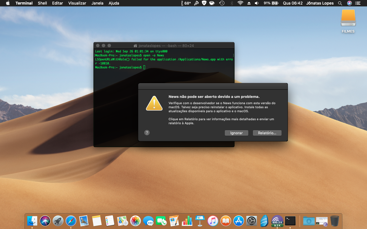

[doublepost=1537954992][/doublepost]Did you notice that Apple News is hidden? I found a site telling you how to run, but on my Mac there were errors (do not know if because of Night Shift or some other change, or even if the application only runs on Metal), can test?
Open the terminal and type:
open -a News
open -a News
The "News" app is hidden because it is only available in the USA, UK and Australia, apple have disabled for other countries, until they of course translate it, you can launch it manually from Applications folder, create an alias, and it will work in english only. Anyway if you change your main language locale in en_US (or en_GB or en_AU) the app will be no more hidden and perfectly working.

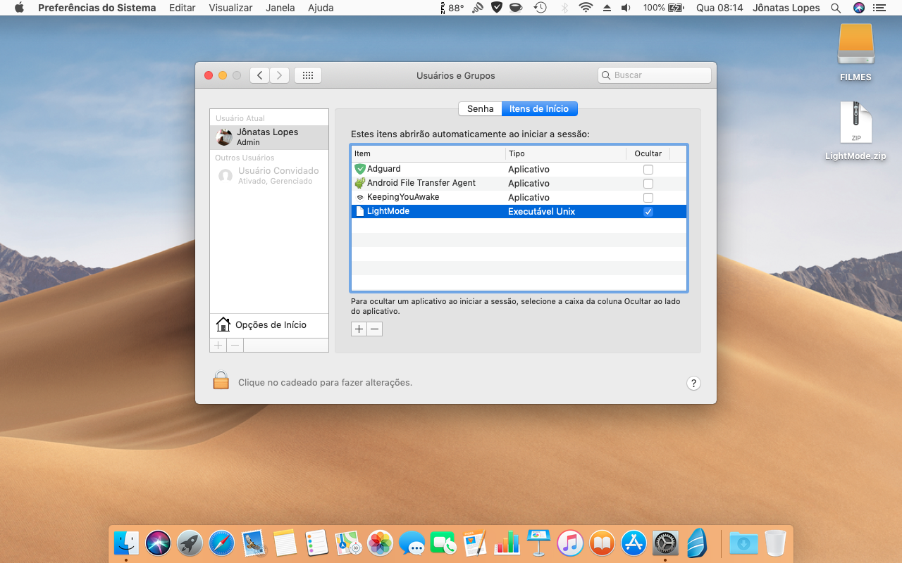

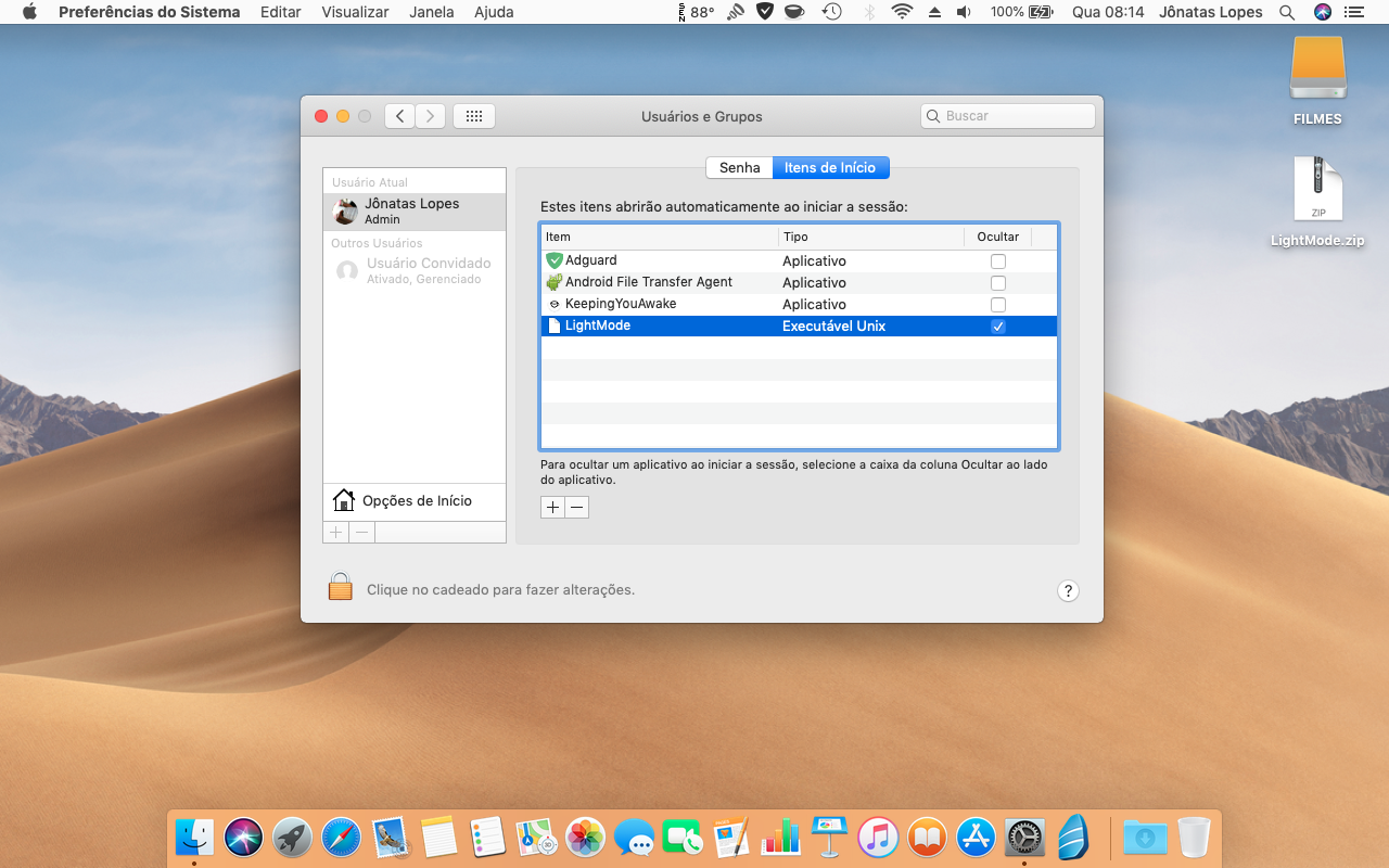

New File (script)
[doublepost=1537960700][/doublepost]I was able to do it automatically when I logged in.
Just added as per the screenshot.

New File (script)
