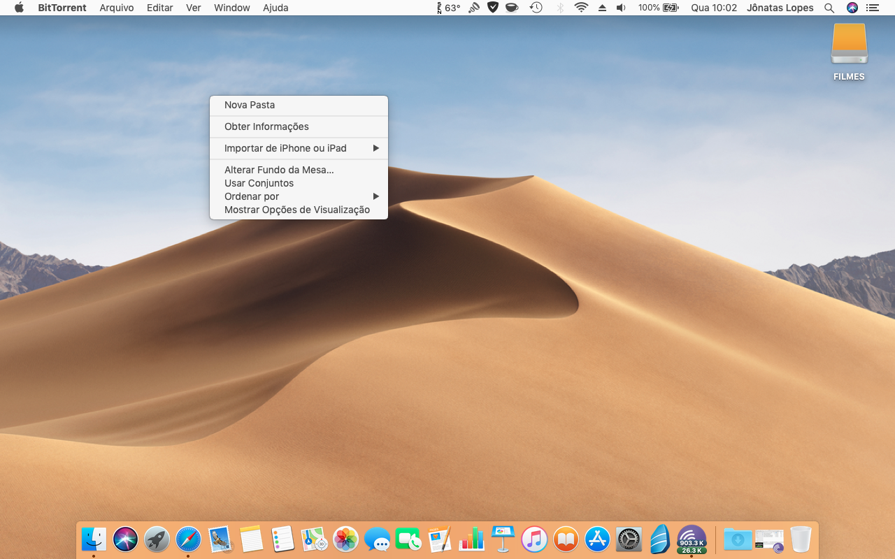

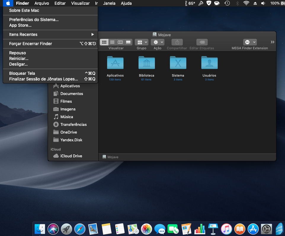

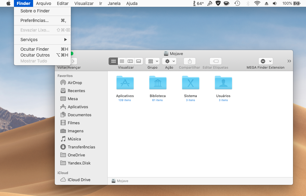

but is it permanent? also solve the grey color in submenus with the right button too?
Yes, Yes, It is not permanent, can be reversible by removing the file from the startup.

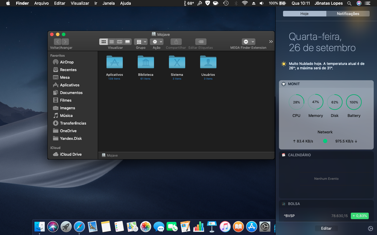

It also works in Dark Mode, but it does not have transparency in the Finder and Menu, losing some of its charm.
[doublepost=1537967935][/doublepost]I did not even know how to create this script, it's very simple for you, but for me it was a bit of work, searching and finding the right way to do it. The secret is not giving up until you can. My thanks to everyone who contribute daily.
To you, thank you.
