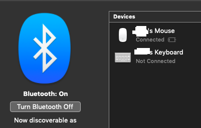

@dosdude1 Have installed Mojave on my MacBook Air 4.2 (mid 2011) by a Mojave Patcher tool 1.2.2 a couple days ago with default patcher values for my MBA rig. Used my AirPods and another stuff. All works like a charm before patch updater installed first bluetooth patch (think it was version 0).
Tried to revert IOBluetoothFamily.kext and IOBluetoothHIDDriver.kext from patched USB drive with kext rebuild but no luck. Now patcher updated Bluetooth patch to version 2. Have same problem... What should I do now to have working bluetooth?
Waiting for next patch update and thank you for all your hard work!
My list of patches in attach

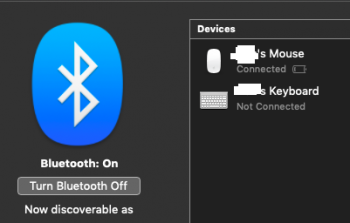

I have the same MBAir4,2 (on 10.14.1 beta 2) and did get a bluetooth version 2 update notice. Ran the patch, rebuild caches and rebooted. It's working fine for me.
Good luck to you in making it work.

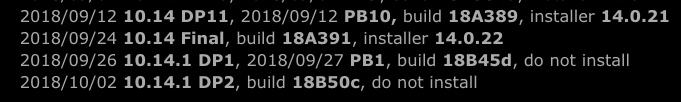

[doublepost=1538799349][/doublepost]@dosdude1, can I go ahead and update the OP with the listing below to say "do not install" to "install at your own risk (or something to the effect that you can try but might not work on you unsupported mac)".
It did work work for me using your patch process.
Let me know if it's appropriate and thanks for your patch app.

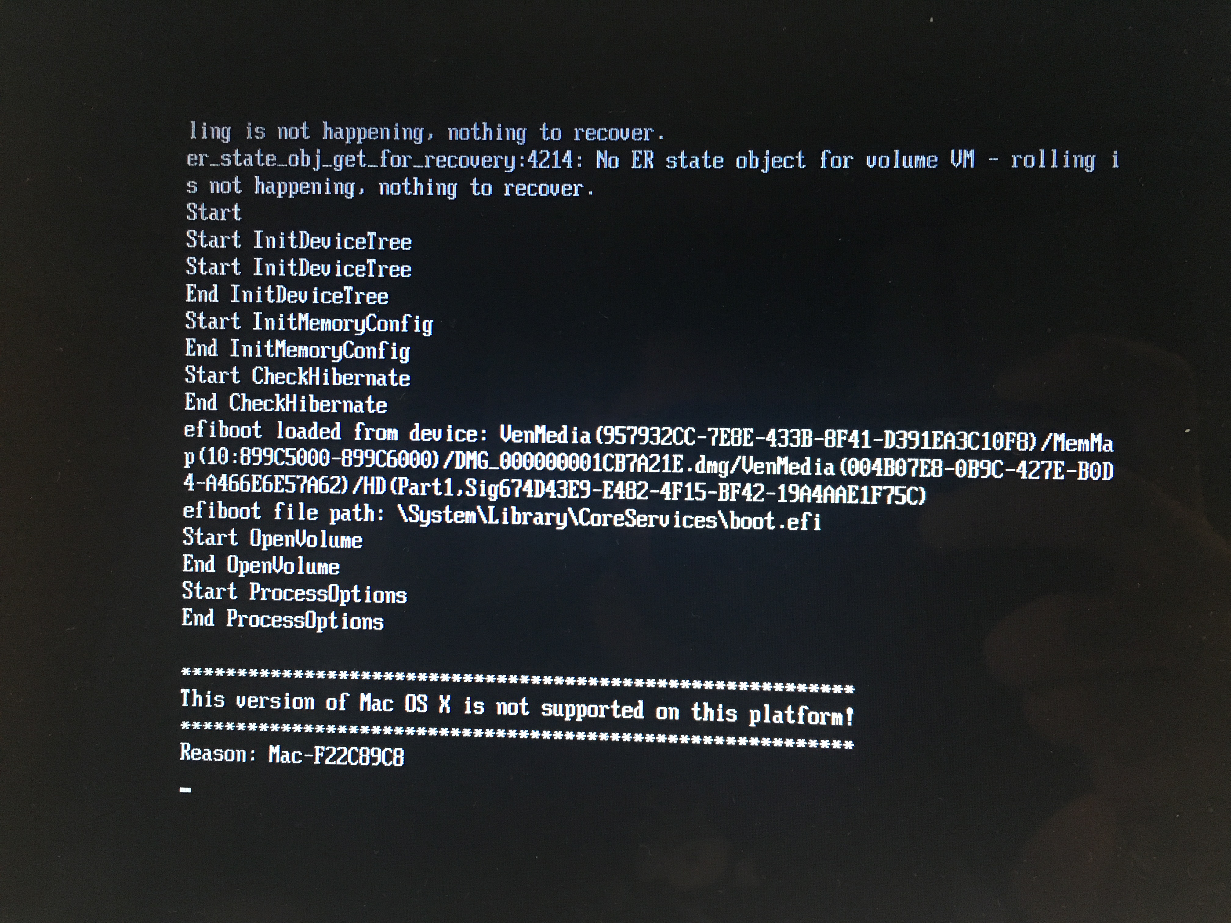

I tried and this is what i get:
And now it boot in verbose mode, how can i return to normale boot?

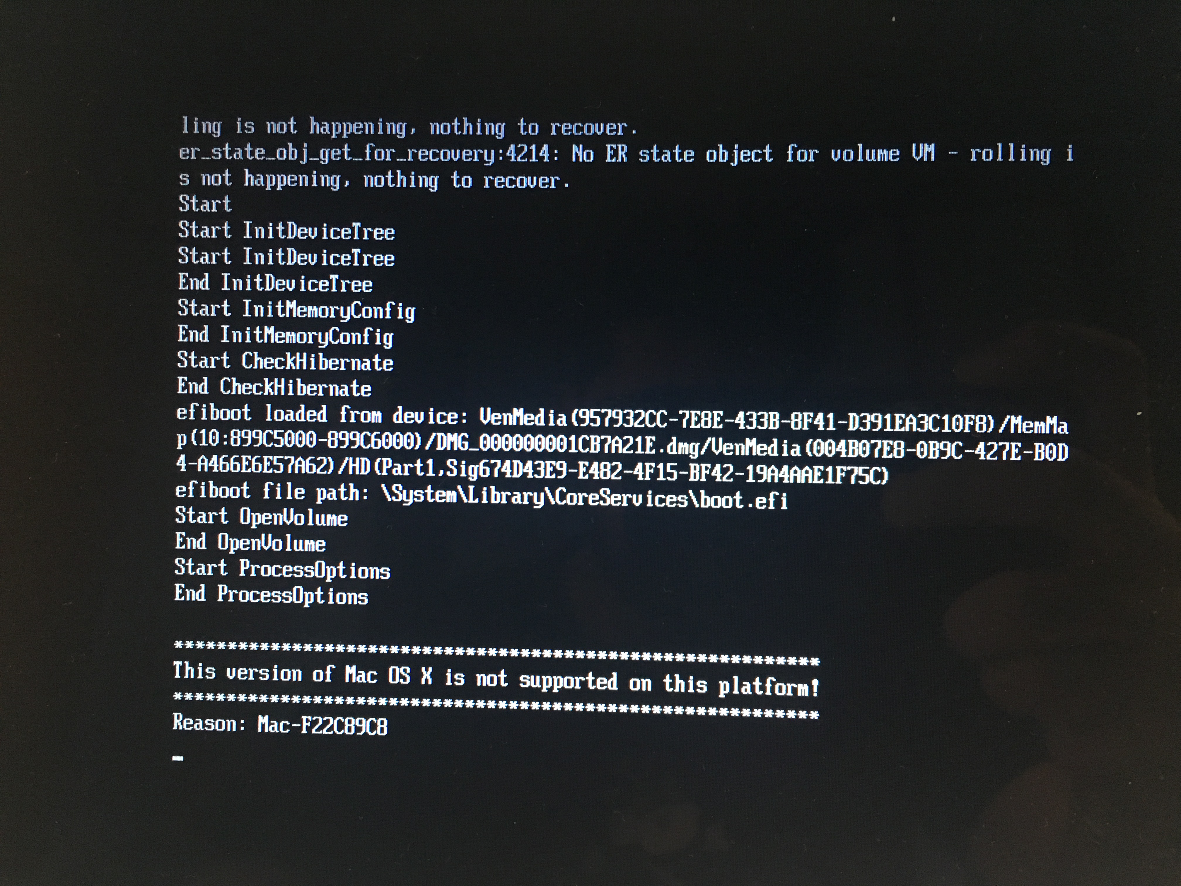

Edit: i googled and found solution to normal boot
The file.DMG and boot.efi path are wrong (it's NOT the APFS Recovery), it seems to point to another partition as main Mojave disk or Preboot or whatever else, that's why you and @baronerosso are having issues on booting the APFS Recovery, I guess on the next Mojave update 10.14.1 or 10.14.2 it will be fixed automatically or by reinstalling Mojave, and then you have to repeat my early steps to "fix" the APFS Recovery editing those 3 files and so on.
I don't know yet how to correctly re-bless the APFS scheme, so only updating Mojave could fix it.
Yes, to boot normal apple logo mode, just drop "-v" from nvram-boot-args.
edit:
I guess your screenshot could represent a call for an "Internet Online Recovery" that will fail of course because of Mojave on unsupported mac, I bet a Mojave reinstallation or version update will auto fix that bringing back the "offline Recovery".
The file.DMG and boot.efi path are wrong (it's NOT the APFS Recovery one), it seems to point to another partition as main Mojave disk or Preboot or whatever else, that's why you and @baronerosso are having issues on booting the APFS Recovery, I guess on the next Mojave update 10.14.1 or 10.14.2 it will be fixed automatically or by reinstalling Mojave, and then you have to repeat my early steps to "fix" the APFS Recovery editing those 3 files and so on.
Ah ok, thank you man!
Patching recovery mode will not allow you to reinstall macOS. Only use the utilities.
Yes, mostly because the macOS recoveries do a check through Internet on machine before allow to download the Installer (again) into the disk, maybe this check is patchable too, but then would remain a non-patched Installer with dangerous firmware.pkg inside (and without Post-Install), so both the HFS and APFS Recovery are just for Utilities fun, anyway from a Recovery Terminal can do a lot of things, even a partial manual patching of Mojave.
