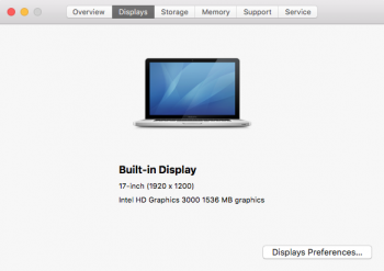

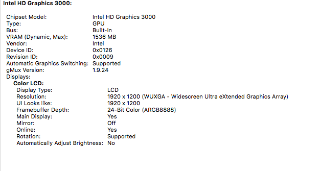

@arqueox try these steps they 100% work this time to increase from stock 512 MB to 1536 MB VRAM:
cd /S*/L*/Ext*/AppleIntelSNBGraphicsFB.kext/C*/M*
sudo cp AppleIntelSNBGraphicsFB AppleIntelSNBGraphicsFB.backup
sudo perl -pi -e 's|\xC7\x45\xD0\x00\x00\x00\x20|\xC7\x45\xD0\x00\x00\x00\x60|g' AppleIntelSNBGraphicsFB
sudo touch /S*/L*/Extensions
edit:
thanks to @arqueox for having tested the Info.plist
before reboot/restart you have to edit this file:
/System/Library/Extensions/AppleIntelHD3000Graphics.kext/Contents/Info.plist
Adding after these strings,
this part:
<key>VRAMMethod</key>
<integer>0</integer>
<key>VRAMOverride</key>
<key>VRAMSize</key>
<integer>1536</integer>
after edited the plist from Terminal type:
sudo chown -R 0:0 /System/Library/Extensions && sudo chmod -R 755 /System/Library/Extensions
sudo kextcache -i /
sudo reboot

Dear All:
Im very happy with it. I don not want install Majave yet becase use VectorWorks 2017 that is not supported by 10.14.
My MacBook Pro is a 17" early 2011, and its AMD GPU have failed three times. Then disconnected at all by software.
My choice was add more shared VRAM using your advice!! and WORKS!!!!
Thanks a lot to all who help me.
Regards
Yes, it works, instead of manual patching, you can use this: IntelHD3000 already patched VRAM combinations for Mojave

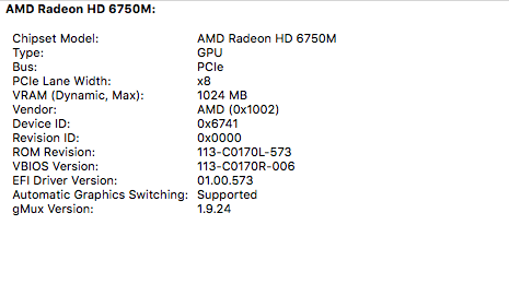

Hello:
I patched my Integrated GPU and now works from 512 to 1536 Mb.
Using GFXCard Status 2.4.4i I set Integrated Only.
Then Open VectorWorks and all start Ok until change the view Model for example: to Front.
Then the screen produce only garbage and can't quits or restart. The mouse cursor is shown.
I will try again and if doesn't work will use the AMD card again.
Regards.

One minor issue: Switching from the dGPU back to the integrated GPU does not appear to work. Gets stuck on a black screen. MacbookPro5,2
