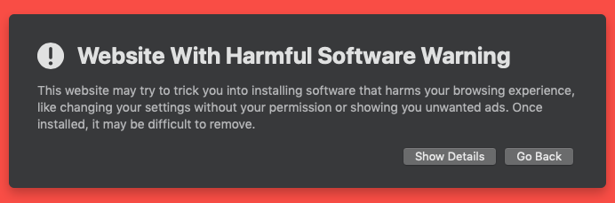

[doublepost=1539205029][/doublepost]Anybody else getting a warning in Safari when you go to this specific thread on MacRumors? It almost looks like Apple is finally making an attempt to interfere.
No other MacRumors forum thread show such a message...
With all the random scripts that people post here, it is not unexpected that some of them could be harmful. That's why I suggested that @dosdude1 should consider open sourcing the patches to be peer reviewed by the community.

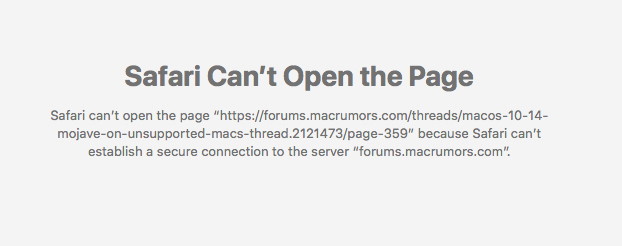

Still having random issues with this thread, I can view then when trying to refresh I get an error, seems to be no rhyme or reason aside from possible malware which I believe was not correct as @dosdude1 removed said file. Doesn't seem to limited to a specific browser.

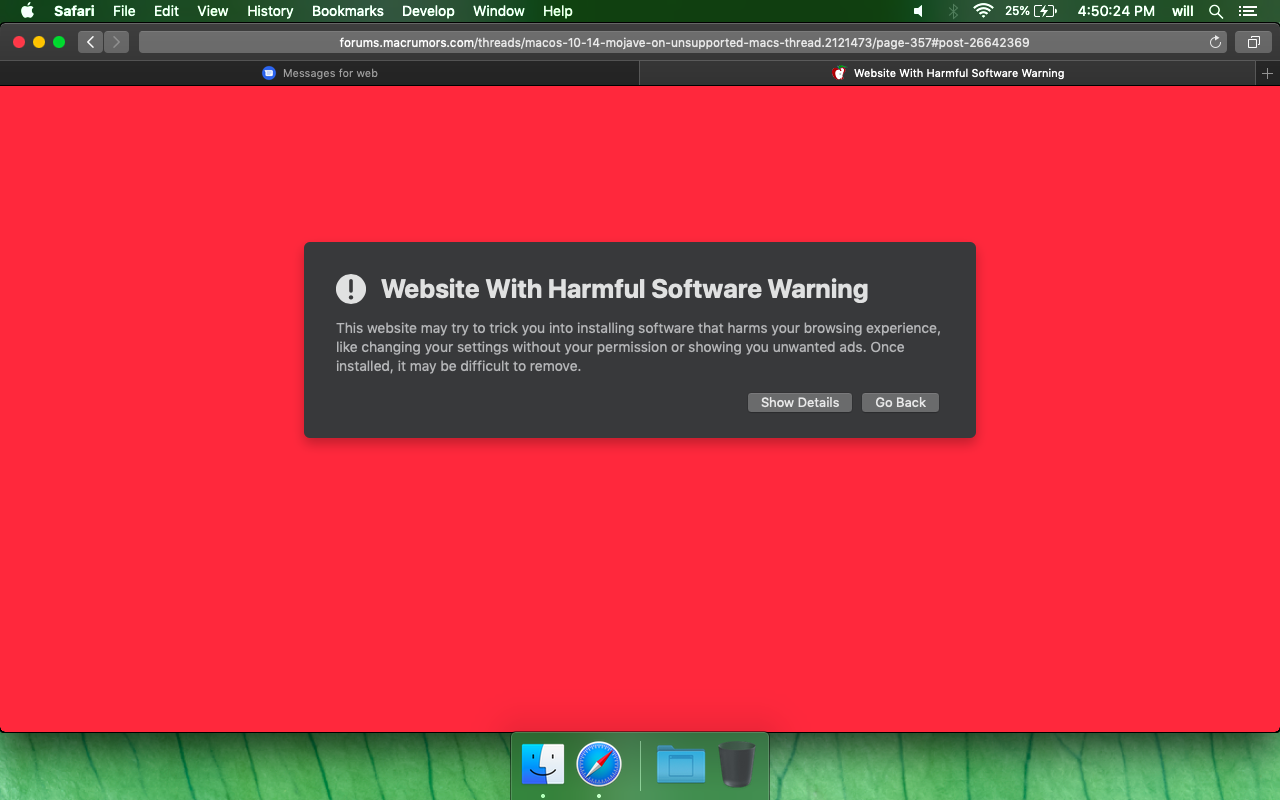

There was a link to an IP address download that looked suspicious on page 3 of the thread. I’ve removed it and am submitting it back to google to remove from this database.
Unfortunately I found the issue. @dosdude1's site seems to be flagged by google. I had to remove his links in the meanwhile. We are getting dinged just by linking to his site.
Enter that site in here "dosdude1 dot com", and you'll see it.
https://transparencyreport.google.com/safe-browsing/search
Strange, even though dosdude1's site is no longer flagged as dangerous, this thread still is.

Yes, I certainly am too, starting this morning. Don't think it has anything to do with Apple, though. Safari (and most other browsers) use Google Safe Browsing data to block fraudulent web sites, so I'd blame Google. It could be that Google has identified the download links to macOS Mojave Patcher as potentially dangerous.
This is beyond annoying 'cause, even if you click on the link in the warning to proceed to the web page, you can't do anything once you get here (like refresh the page or click on a link to another page in the thread) without getting the damn warning page blocking your access again! The only solution, for now, is to go into Safari Preferences' Security tab and uncheck the Fraudulent Sites option.
Just discovered that myself trying to get back here. Sure would be nice if Safari had a whitelist option.

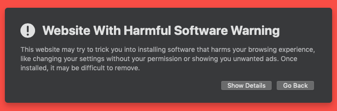

That's odd. As far as I know, that's not the error most of us are seeing -- which is this:
Clicking on the Show Details link in that warning takes you to another dialog where you can proceed to the blocked page (just once) but cannot refresh it without the above warning reappearing. (This warning can be got rid of by unchecking the Fraudulent Sites checkbox in the Security tab of Safari Preferences.)
No idea what's causing your error message but you might try clearing your history (from the Safari menu) -- and, maybe, your cache (enable the Develop menu in Safari Preferences, if it isn't already enabled, and from the Develop menu click on Empty Caches).
