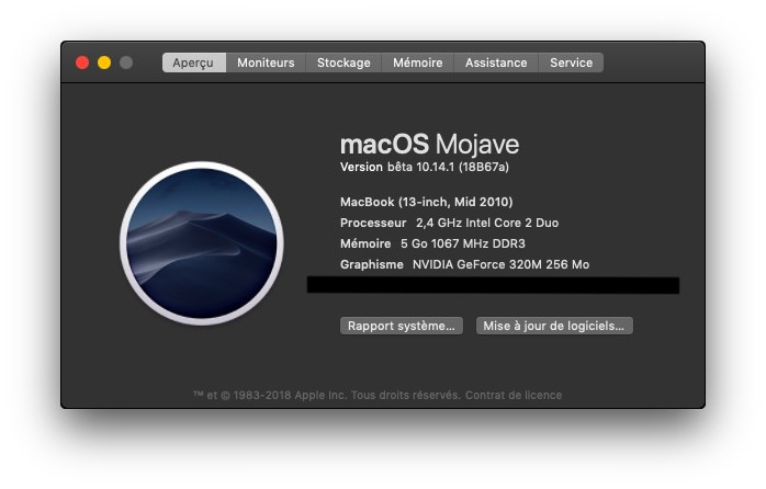

10.14.1 bêta 4 !

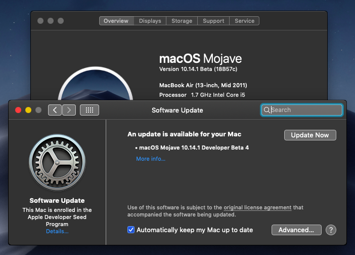

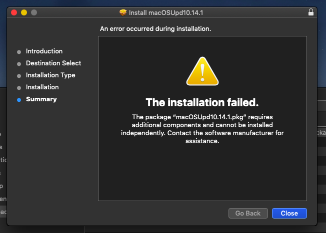

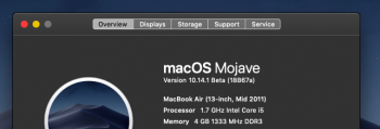

Thanks @ASentientBot for the reference to the software catalog download.
Tried it and downloaded a 1.6gb pkg file. Upon running it, I got this message:
So I tried OTA and downloaded a 2.16gb instead.

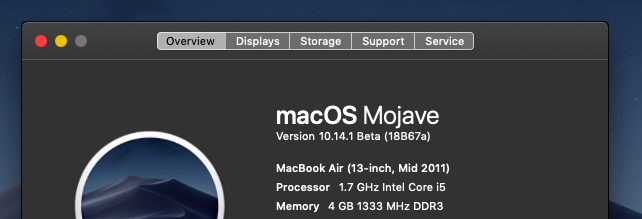

Update successful on my unsupported MBAir.
FYI. Thanks again.

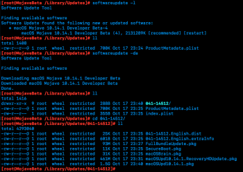

FYI
If you need to download (but not yet install) all the packages required or included in the update for 10.14.1 beta 4, you can do these steps in Terminal.
Hope this helps.
