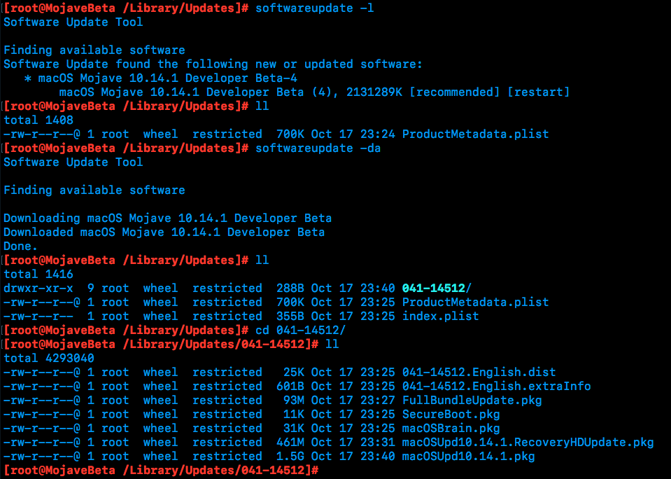

FYI
If you need to download (but not yet install) all the packages required or included in the update for 10.14.1 beta 4, you can do these steps in Terminal.
Hope this helps.
This is good to know. Now perhaps experts in this thread can figure out how to create a full install instead of OTA update/upgrade for the beta versions.
