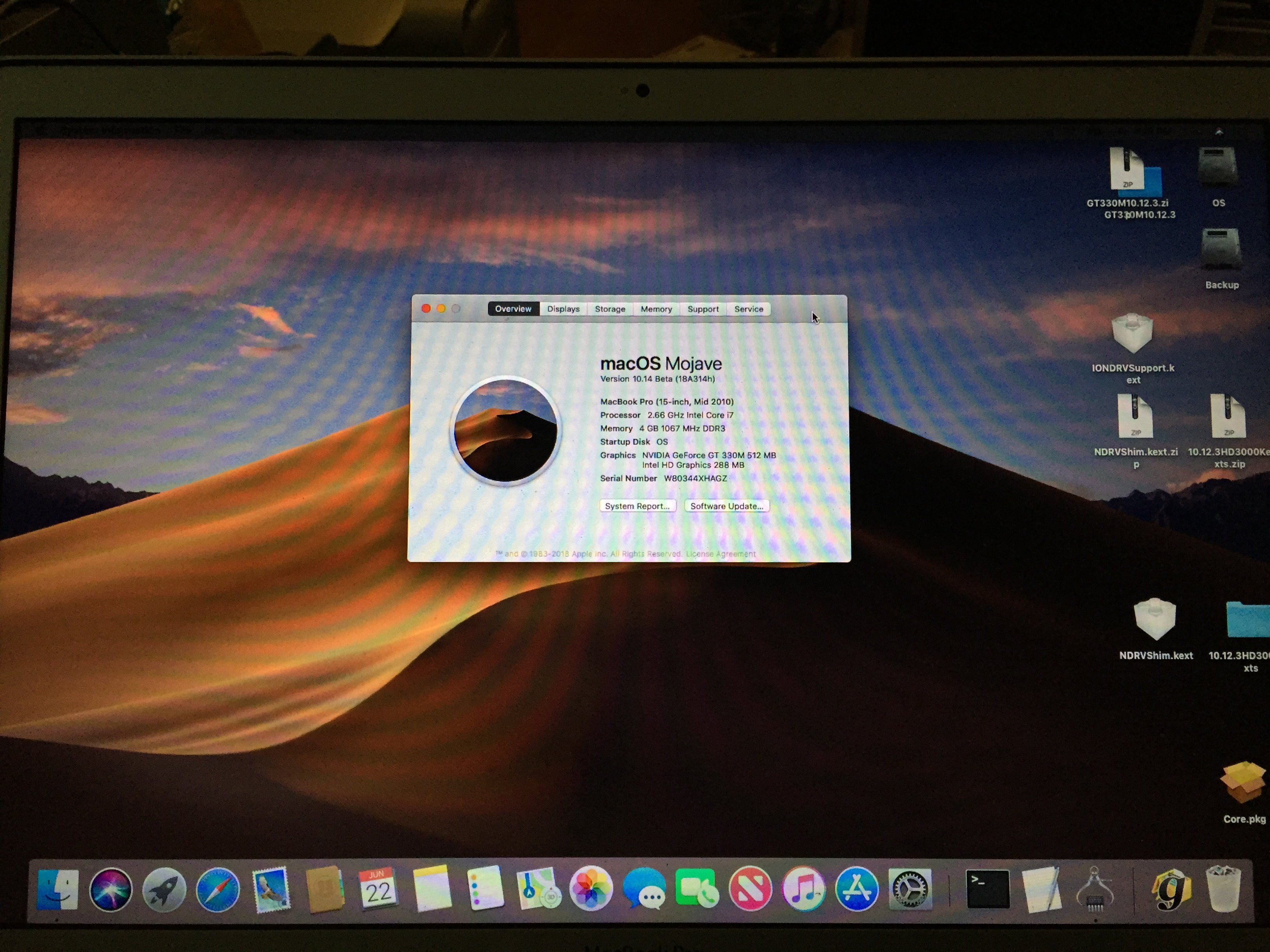

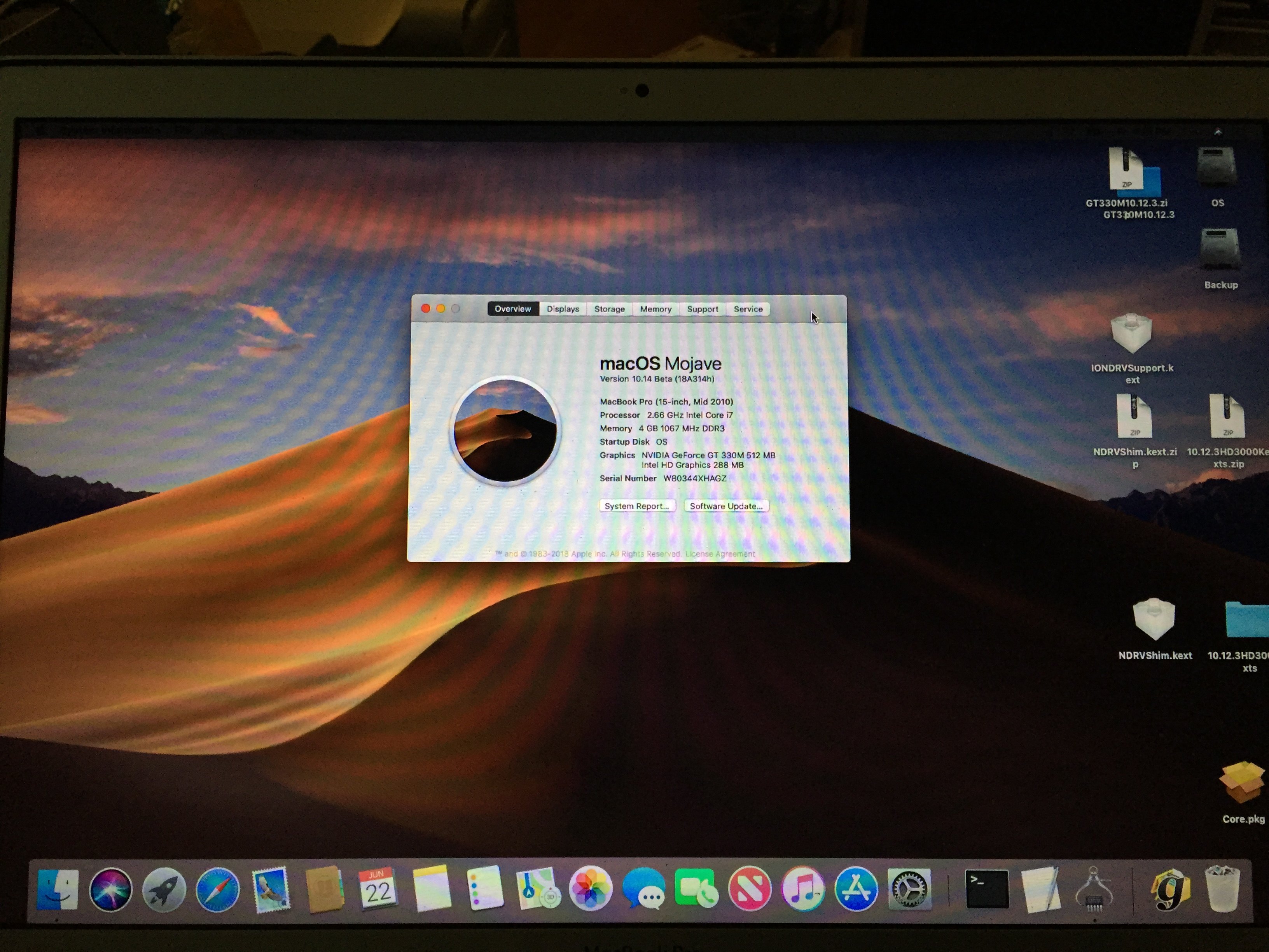

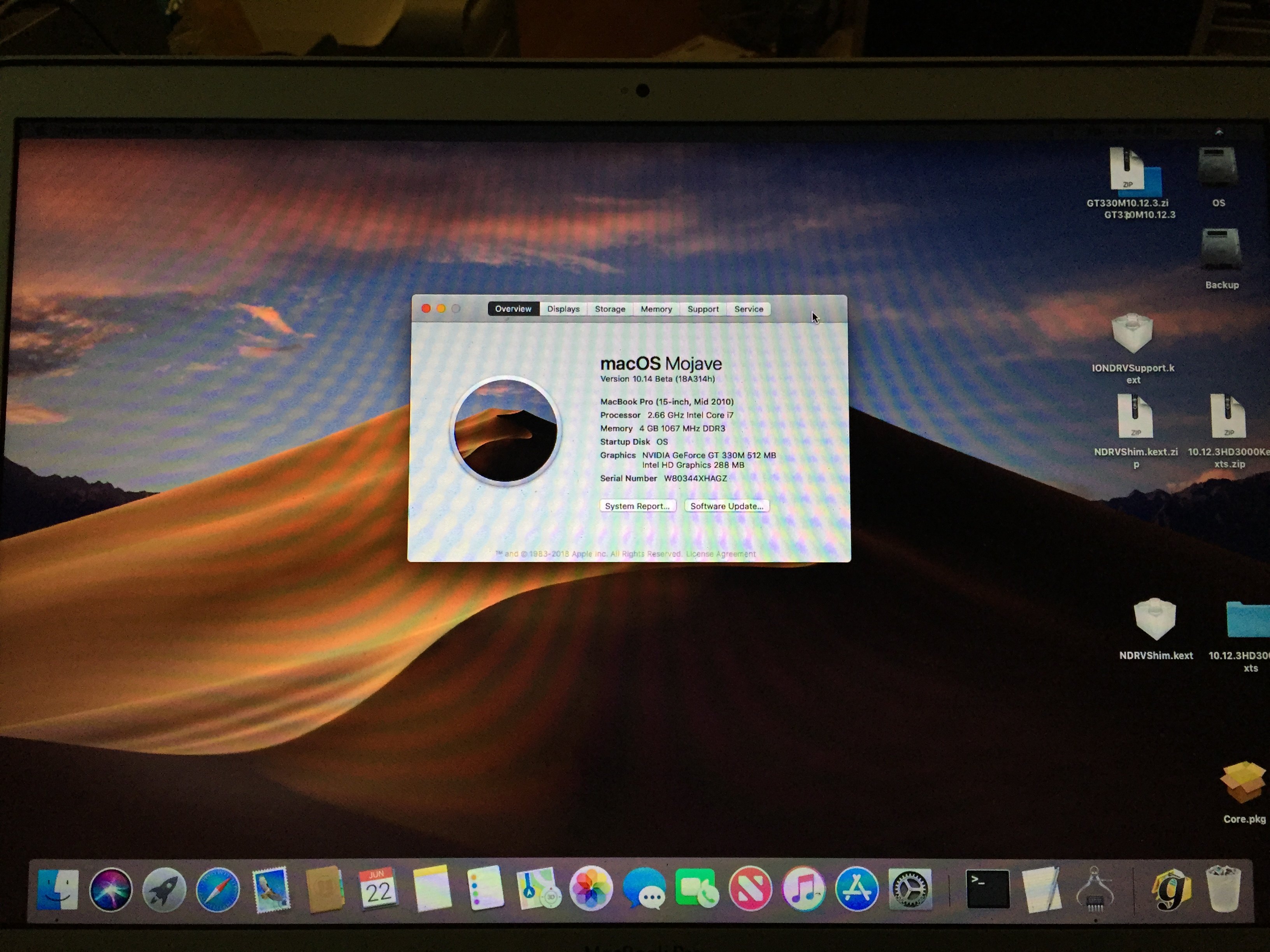

Another update: @parrotgeek1 and I got acceleration (mostly) working on this Mid-2010 15" Arrandale-based MBP, with Intel HD Graphics and GeForce GT 330M. Everything works, including hardware gMux GPU switching! The only issue right now is the system will randomly kernel panic when using the nVidia GPU, but hopefully that will be worked out soon.

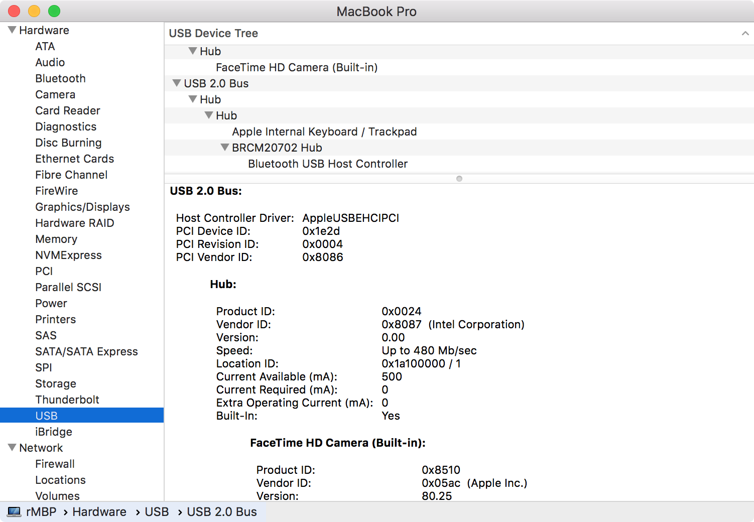

There is a defer usb boot flag. Not sure if that will help you guys but wanted to point it out.
The boot flag is
-gux-defer-usb2.
I’m using fix usb on Clover which is probably why my USB works natively. Will try it w/o later.

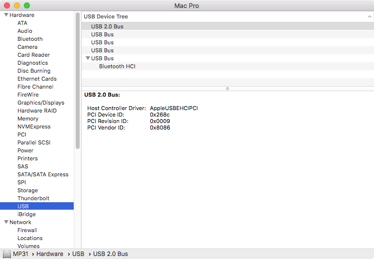

Mac Pro 3,1

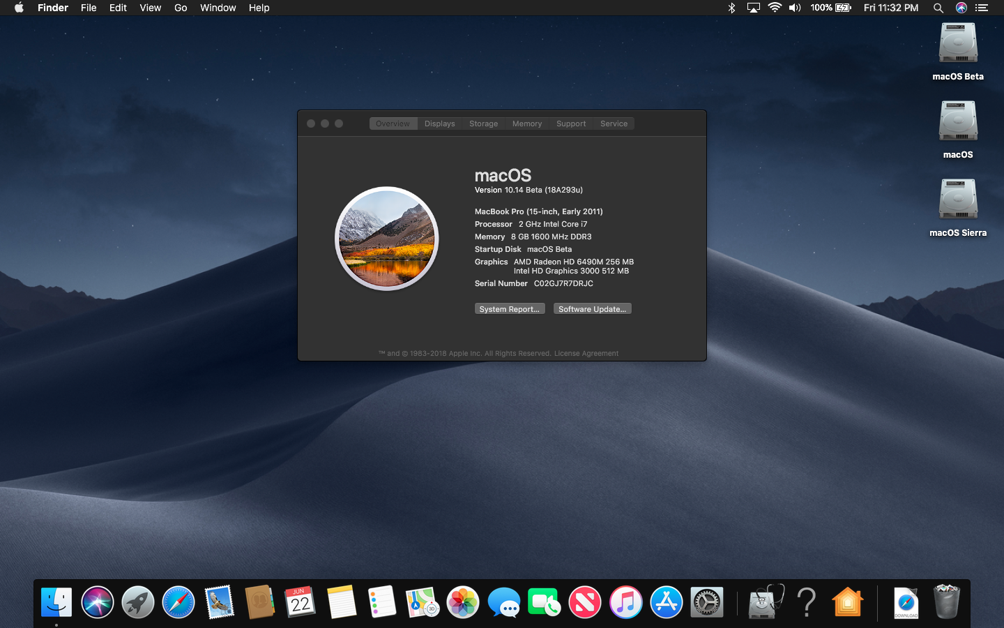

well I don't have access to the latest version of Sierra, I only have access to the beta, and apparently they don't work, well partially, I now have the intelHD 3000 in "About this Mac" but I don't have full acceleration still

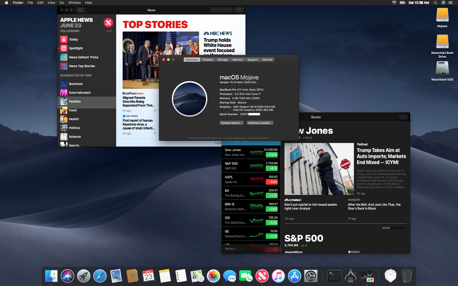

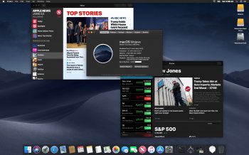

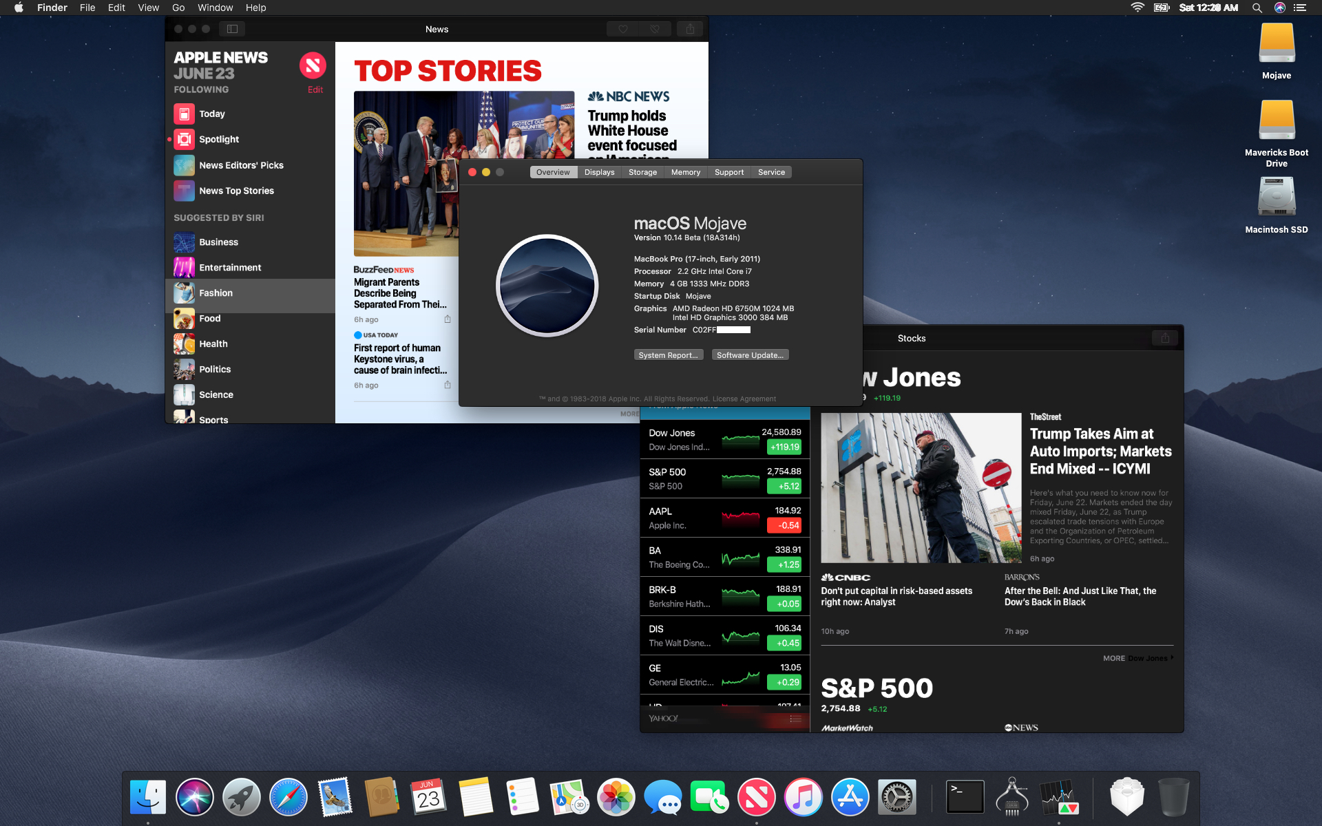

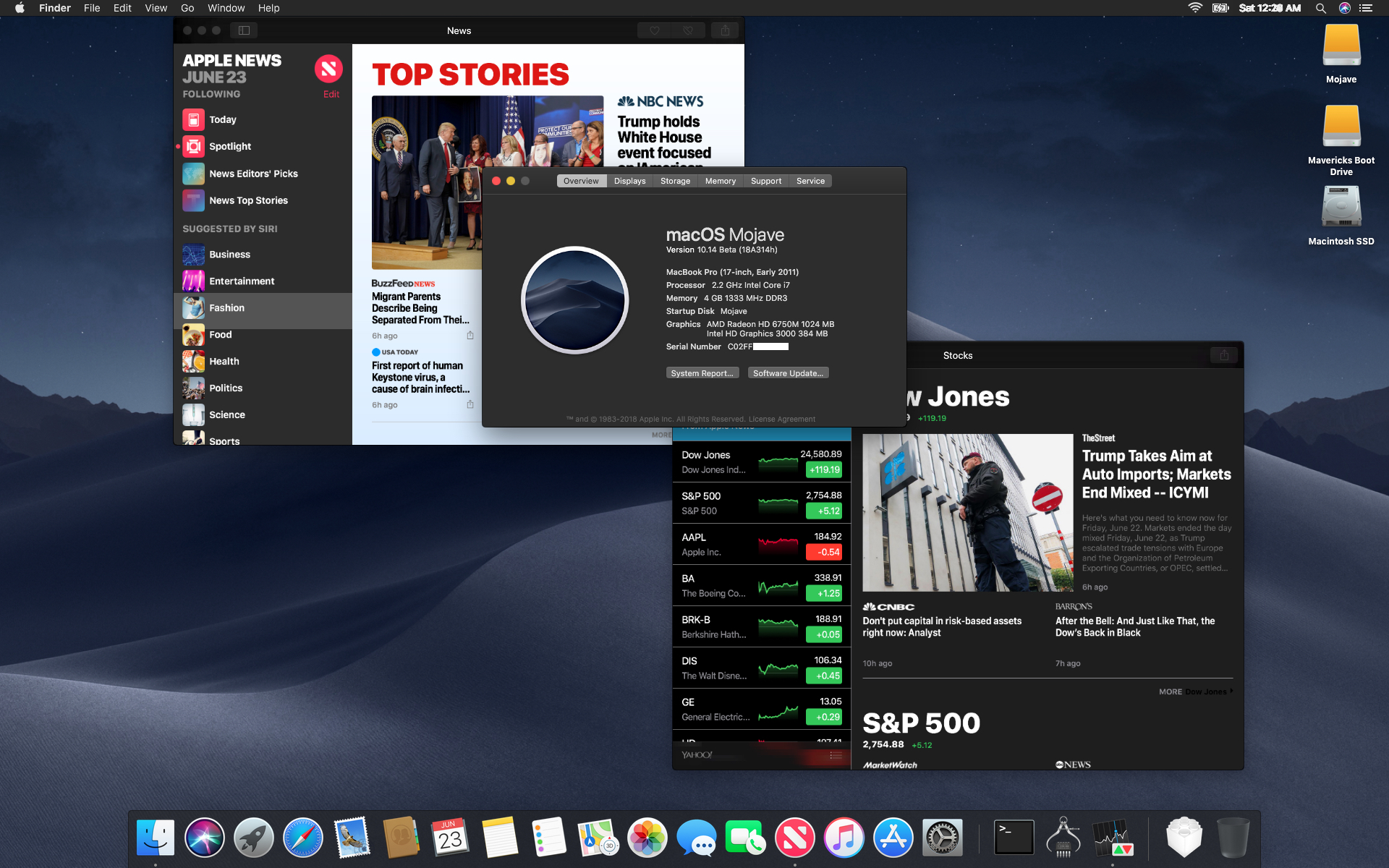

AppleIntelHD3000Graphics and AMD6000Controller kexts from 10.12.6 both show as loaded, however it's worth noting I do not yet have full acceleration, only partial. I was under the impression that the News and other iOS apps would require Metal, but to my surprise they actually do work on here. Should be yet another blow to those who insist on defending Apple's decision to drop these Macs. 🙂
