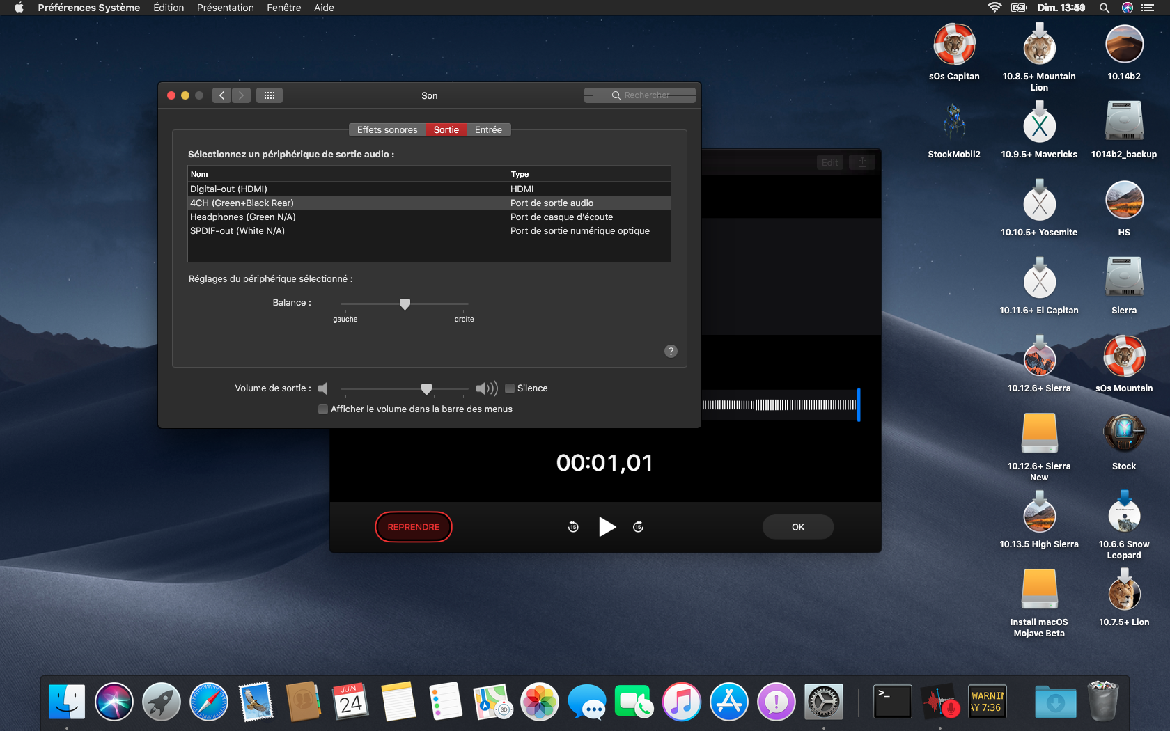

I successfully installed Mojave on MacBook Pro Early 2011, got Intel Graphics working(kexts from High Sierra), AMD is without QE/CI, and sound is not working. Is there any way to fix it?(either AMD or sound or both).. I tried AppleHDA.kext from High Sierra but nothing.
but graphics works only when booting with Clover.
Try use this for sound : https://github.com/chris1111/VoodooHDA-2.9.0-Clover-V12

I tried that Classic version but with no luck, should I try that Clover version?
Download & Install VoodooHDA in Classic Options / mojave & Reboot
Next go in Sound Pref System / output / select 4CH output.

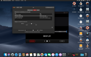

MacBook Pro Early 2011 15'
Have you set the sound output destination to "Speaker (unknown)" ?
This worked here on my MB Air with the classic installation method.

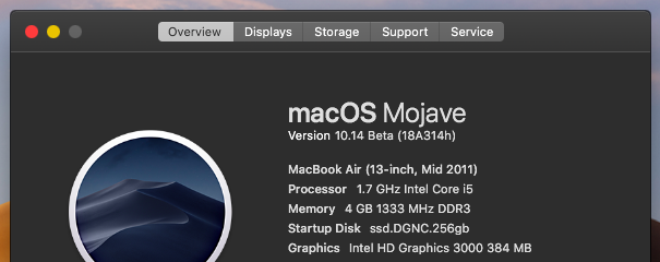

[doublepost=1529842186][/doublepost]I can confirm a working 10.14.0 on MacBook Air 4,1 (Mid 2011) - i5, Intel HD3000 384MB graphics.
Started with the patched installer (YSsystems, DL link somewhere on pages 37..38 here).
Then copied the AppleIntelHD3000.* files and the AppleIntelSNBGraphicsFB and AppleIntelSNBVA from the 10.13.6 (beta 3) extensions.
VoodooHDA in classic install method gives sound output. Graphics buffer and HD3000 is now recognized (384MB). Acceleration is only partly working, though. iOS stuff does not work, only blank windows or App crashes.
Menu bar normal in both modes, no tint or opaque blur.
Software Update does not show beta 2 - despite being registered as development system. Any hint on that, is there some delta (combo) yet to download manually?
[doublepost=1529843212][/doublepost]Additional observation on that MBAir 4,1: Change of screen brightness and keyboard illum. both work.

...well, sound works just fine with the voodoo output.

I tried VoodooHDA again, now it works but the sound is kinda flat(Boom didn't help)..
And graphics works now even without Clover. I'm pretty impressed as it was really really easy to install it. I was installing it with Clover, and there were NO problems. Just changed SMBios to fake MacBook Pro 2012 and it let me to install it.
