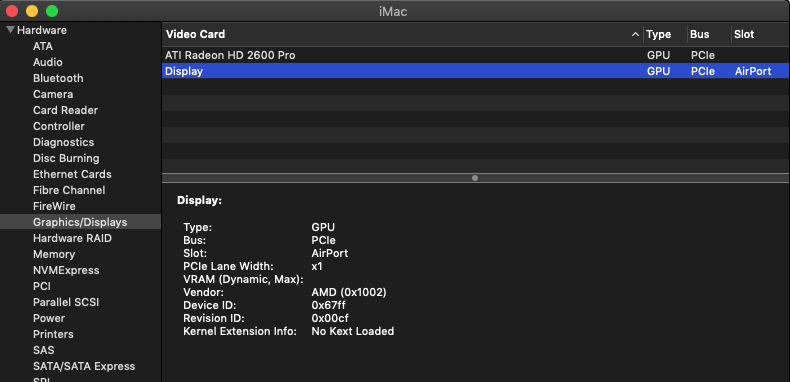

I have built an eGpu for my iMac 7,1, as described in this other thread
https://forums.macrumors.com/thread...expresscard-slot.2135898/page-2#post-26473168
where Larsvonhier managed to make it work on an iMac 8,1.
For mine, I used an MSI Radeon RX 560 Aero ITX 4GB.
The ONLY moment when the card worked was when I booted from the USB stick with Dosdude's Mojave Patcher (1.2.2): my external display showed the same background as the main screen. EVERY other moment, the display had no signal at all. I guess that there is something in that installer that recognized my card.
BUT after I installed Mojave and applied all the patches, the card didn't work at all. As you can see in my screenshot, it's recognized as an AMD GPU, but it doesn't have a name and in the Kernel Extension Info it says "No Kext loaded".
One of the post-install patches that I installed (it was pre-selected for my iMac) was the "Legacy Video Card Patch". Have this something to do with my problem?
I hope you can help me!
I hope you can help me!View attachment 799289
You can't load the drivers for that GPU on that system, as the CPU doesn't support SSE4.2. You will only be able to use an nVidia card.
Thank you for your reply. Do you mean ANY nVidia card or I have to be careful about that too? I was thinking of
GeForce GTX 1050Ti. Anyway, I have to wait for nVidia to release the drivers for Mojave, right?
Reactions: TimothyR734
Yes, for Maxwell and later cards, you have to wait for nVidia to release the drivers. Kepler cards (GT 6xx series/some 7xx series) and older will work just fine though.
