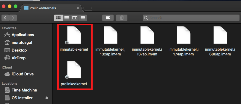

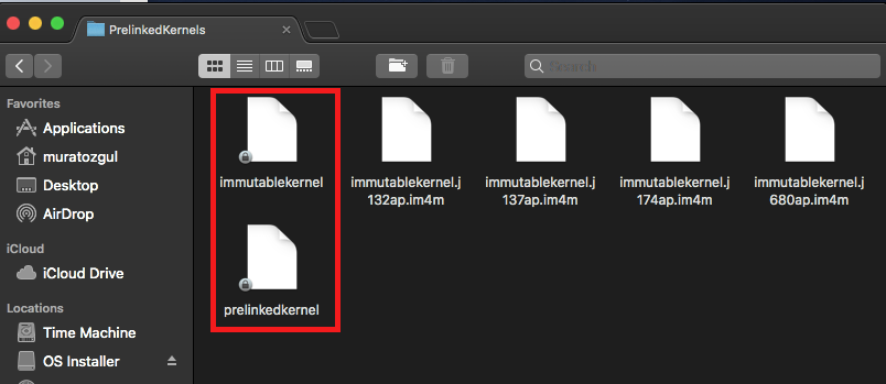

Meanwhile about fixing Bluetooth devices into the APFS Recovery try this:
Boot normally Mojave then open as you already know your /Volumes/Recovery/Random-numbers-letters/
delete the immutablekernel inside
now keeping this finder window opened, plug and open the USB Mojave Patcher and navigate into the USB path /System/Library/Prelinkedkernels/
copy the prelinkedkernel from the USB Mojave Patcher into your /Volumes/Recovery/Random-numbers-letters/
while inside /Volumes/Recovery/Random-numbers-letters/ rename this fresh copied file from prelinkedkernel to immutablekernel
reboot with CMD+R now bluetooth devices on APFS Recovery should work.
Dont get it. I deleted immutablekernel
Open USB Installer
here is the inside; There is two locked files. Should I copy those two files to /Volumes/Recovery/Random-numbers-letters/ or just prelinkedkernel?
Open USB Installer
Just highlight the locked file press CMD+i (get info) and uncheck "locked" to unlock otherwise you can't rename it after you copy.
I am not sure if dosdude1 has patched also the immutablekernel, but for safety try copy only prelinkedkernel into your /Volumes/Recovery/Random-numbers-letters/ path and rename into immutablekernel and rebooting in CMD+R check if bluetooth input devices work.

Didnt work I lost Recovery and getting same error here;
macOS 10.14 Mojave on Unsupported Macs Thread
You haven't lost nothing, you have only missed something, please check the steps:
- take (copy) the prelinkedkernel from the /USB Installer/System/Library/Prelinkedkernels/
- copy it over here /Volumes/Recovery/Random-numbers-letters/
- Inside here /Volumes/Recovery/Random-numbers-letters/ rename the fresh copied prelinkedkernel into immutablekernel
check renaming it correctly into "immutablekernel" for ex. if you typed "imutablekernel" it won't boot of course.

You haven't lost nothing, I have only missed something, please check the steps:
check renaming it correctly into "immutablekernel" if you typed "imutablekernel" it won't boot of course.
Finally it came and Magic Mouse and Keyboard are working ;) Thank you @jackluke

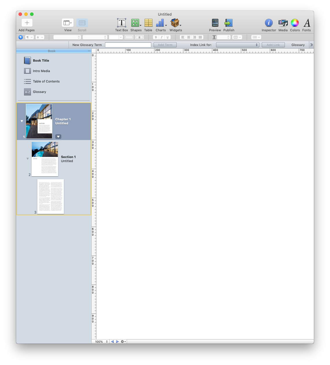

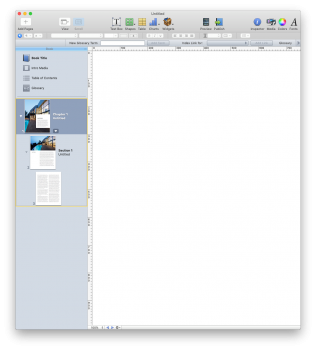

10.14.1 installed perfectly on my 2009 5,1 Mac Pro with a GT 120 (using the new tool, downloading 10.14.1 from Apple, putting it on a USB stick, and booting from it). The graphical glitches all remain, however, and iBooks Author–the one piece of software I still need–is completely unusable.
