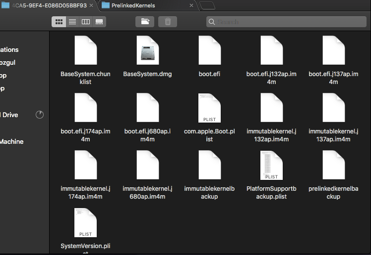

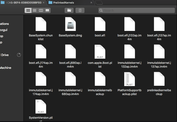

while inside this path copy the file prelinkedkernel into the previous Finder Window, exactly were you renamed those 3 files, lastly rename this fresh copied file from prelinkedkernel to immutablekernel
Is that right? Should I delete those files? I also copied PlatformSupportbackup.plist is it necesseary?
Yes, instead of deleting I suggest to rename them, and mostly you have to rename the PlatformSupport.plist to avoid the Mac model id check.
But, this is the second part of the your guide. And you are saying copy the files you already renamed and I copied the files from inside random number folder(Which I renamed it there) to PrelinkedKernels folder.
I renamed here;

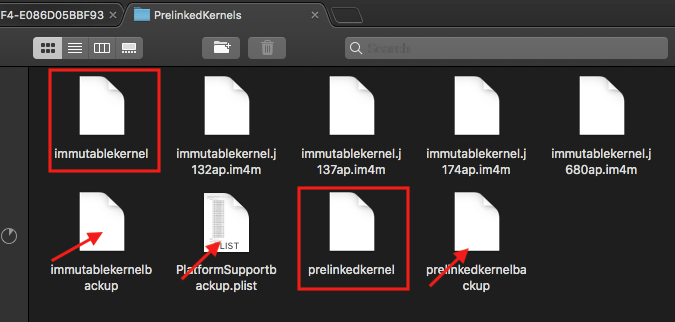

Then Copied from here;(Arrows are copied files) Then should I delete files inside red Square files right?
Edit: I deleted those files after restart press Alt but no recovery partition just EFI HD and TimeMachine Drive listed.

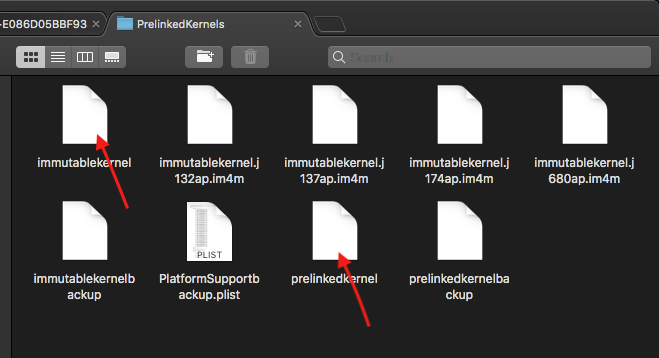

I renamed here;
No, absolutely not, don't delete they are needed to boot macOS, you have just to copy them into your Recovery and leave all there, once you applied my suggested fix try to boot with CMD+R after power-on chime , post here the screen in case it won't boot in APFS Recovery.
Till now is not possible to show APFS Recovery holding alt-option key at the startup manager, but only with Command+R .

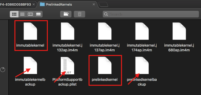

Why you deleted those files into the Prelinkedkernels folder ? I never told to delete them neither their "backup".
However it is recoverable, no need re-install and no need a timemachine, meanwhile boot with CMD+R or with any USB Mojave Installer.
Once you booted launch Terminal and type:
cd /Volumes/"Your Mojave Label"/System/Library/PrelinkedKernels/
ls
mv prelinkedkernelbackup prelinkedkernel
reboot
No, absolutely not, don't delete they are needed to boot macOS, I have just to copy them into your Recovery and leave all there, once you applied my suggested fix try to boot with CMD+R after power-on chime , post here the screen in case it won't boot in APFS Recovery.

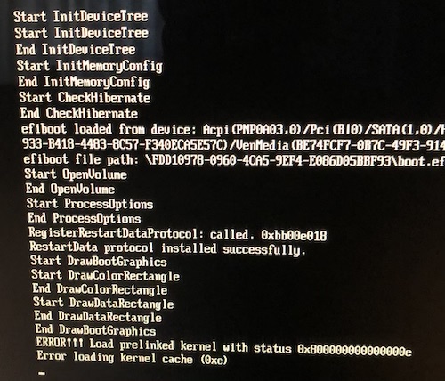

Ok. I did but it doesnt work. No recovery. I am using APFS drive. When I click to Command+R I am getting this error; After this error system boot normally but no Recovery Mode;
I didntdelete the files just move the desktop for try. After try it didnt work and you create new post and said dont delete it after reading your post I move those files to own place and restart after chime I press Command+R and getting this error.
The part2 of my "APFS Recovery fix" is intended for those who need to adjust the CMD+R feature inside their hybrid HFS/APFS partition, also the part1 is mandatory for them to apply before part2.
The part2 is not needed for those who have a only APFS container.

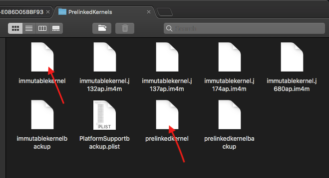

It's all right, you are almost there, it is exactly your APFS Recovery path where the boot.efi is pointing is correct, just do this copy from your /System/Library/PrelinkedKernels/ folder ONLY the file prelinkedkernel into your /Volumes/Recovery/Your-random-numbers-letters/
then ONLY inside this path /Volumes/Recovery/Your-random-numbers-letters/ simply rename the fresh copied file from prelinkedkernel to immutablekernel, that's it.
After done booting with CMD+R you will land to your APFS Recovery.
Keep in mind that from there you can't re-install Mojave, but only use the Utilities.
