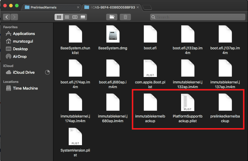

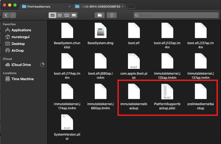

This is inside of my /Volumes/Recovery/Your-random-numbers-letters/ (As you see I already renamed those files)

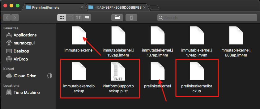

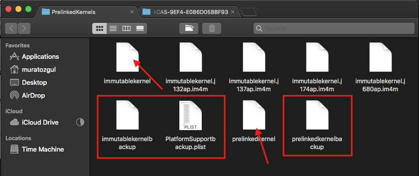

And this is inside of my PrelinkedKernels Folder (Files are inside of the square I copied from random numbers folder and arrows show you must not delete which you said) I think probem is in this folder
No, you have to don't touch your Prelinkedkernels Folder, BUT only copy from there the prelinkedkernel file into your /Volumes/Recovery/Random-numbers-letters/

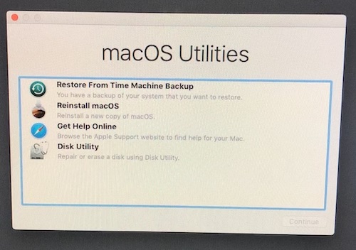

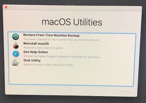

Ok, I did and Recovery came. But its useless Magic Mouse and Keyboard are not working.
