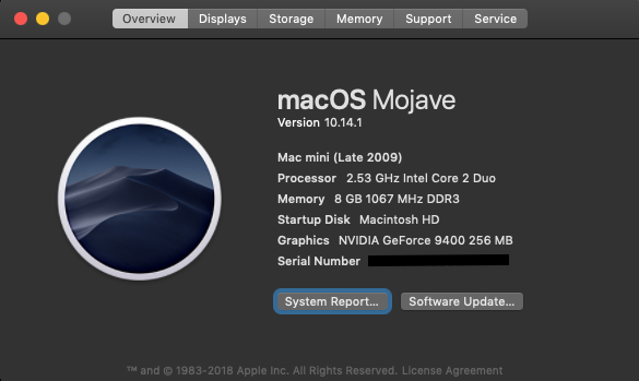

Mac Mini Late 2009 (3,1) - Samsung SSD, APFS
Running Mojave 10.14
After creating a New Patch Tool, v1.2.3, from earlier this evening,
I began Update from within System Preferences/Software Update
After normal download and installation, Mac mini was caught in a boot-up loop, where it never fully finished the boot-up to login screen.
While Mac mini was still going through boot-up loop, I attached the newly created Patch Tool, v1.2.3,
and held down option key, where I was then able to select Patch Tool and apply post-Install patches
Which immediately, Successfully upgraded to Mojave 10.14.1
Thank You @dosdude1
