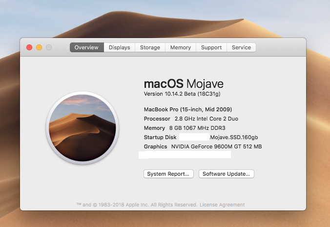

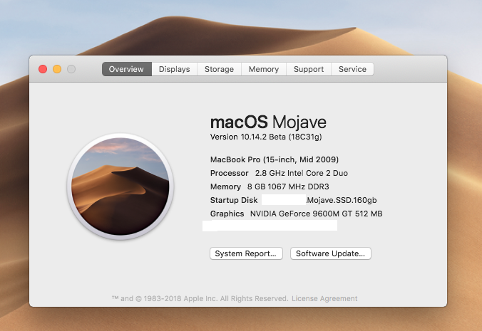

Successfully Upgraded from 10.14.1 Final to 10.14.2 Beta 1 on my Mojave unsupported MBP5,3 (core 2 duo)
OTA (System Preferences | Software Update) and used mac OS Post Install from @dosdude1's Mojave Patcher app v1.2.3.
Special Thanks to @dosdude1 and the other awesome fellows credited on the OP. Thanks as well to @TimothyR734 for his always useful/relevant info and @pkouame for his hybrid patch.

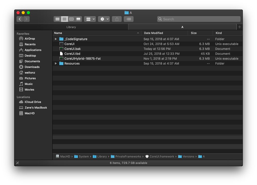

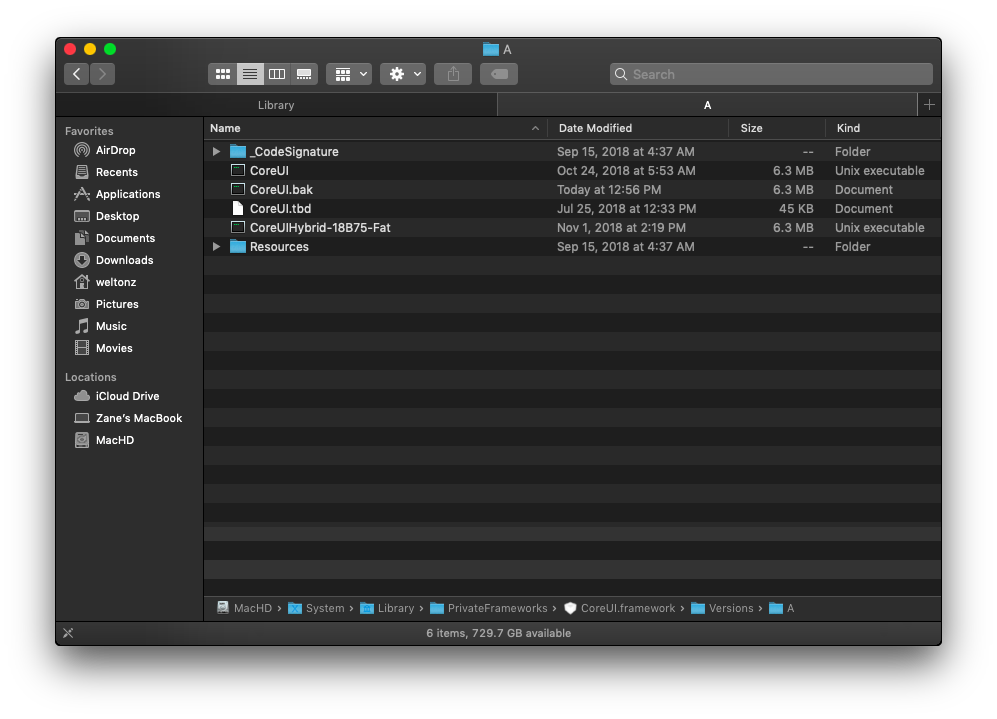

apparently it is correct, I always first copy the file I want to replace to the same folder and then rename the main file with a bak or 10.14.1 at the end of the file name, example: AppKit.bak or AppKit_10.14.1 and then rename the file modified file (patched) to the original name, AppKit example.
If you have any problems, simply enter through the Recovery (USB Installer) and undo the changes.
It is best to always change the names and files by the terminal or keep it open, if you prefer to make the changes by graphical mode (with the system in full operation).

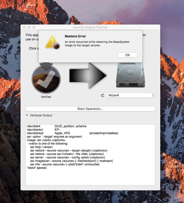

Hi everyone,
I haven't been on this forum for a while, and am too lazy to read through the hundreds and thousands of posts.
Would anyone be able to help me with this problem?
Many thanks in advance!

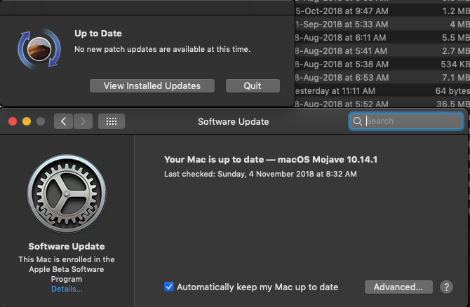

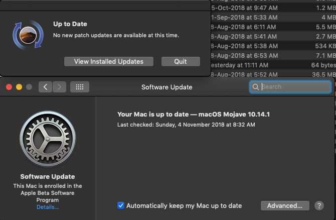

Hi Danilo,
I am using the same patch version 1.2.3, but cannot upgrade tp beta 10.14.2 beta 1. Kindly let me know how you were able to get this patch. My mac is also enrolled in Apple Beta Software Program. Attached is the file if this helps.
Thank you very much for your help.

I am currently running Mojave 10.14 and I am being prompted to install 10.14.1. I have a 2010 Mac mini and I was curious is I can install the update and then run the post patch updater without having to download the entire Mojave image and patch. Thanks!
Hi Danilo,
Is your 10.14.0 installation on an APFS formatted volume?
