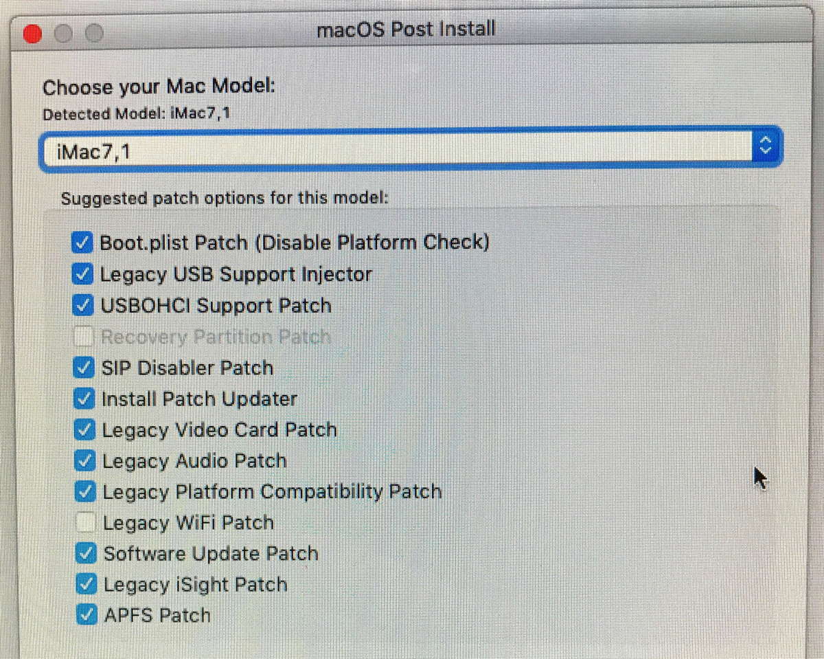

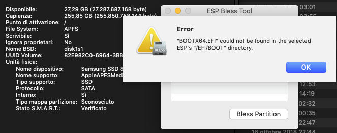

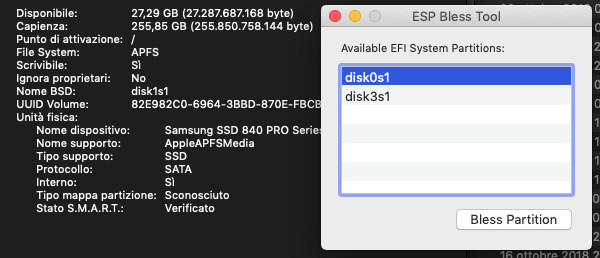

If your Mojave APFS volume is on disk1, that indicates that your main disk is disk0... APFS makes a second "virtual" disk (AKA container), which is actually on disk0... Kind of strange. The fact that it doesn't detect a BOOTX64 file indicates that you most likely did not apply the APFS patch to that volume in the post-install tool. Try doing that, and see if that helps.
I just booted from the Mojave Patcher USB disk and applied the post-install patches again, with the APFS patch (with and without rebuilding cache). After that, I launched the ESP Bless Tool 1.1 but the result is the same: in the BSD names list the internal disk with Mojave (disk1s1) is not detected and trying to bless the disk0s1 gives an error. That's crazy (because I'm writing this on that same iMac with Mojave 10.14.1), and I booted from that disk. See attached screenshots.
