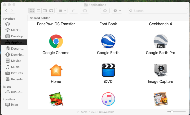

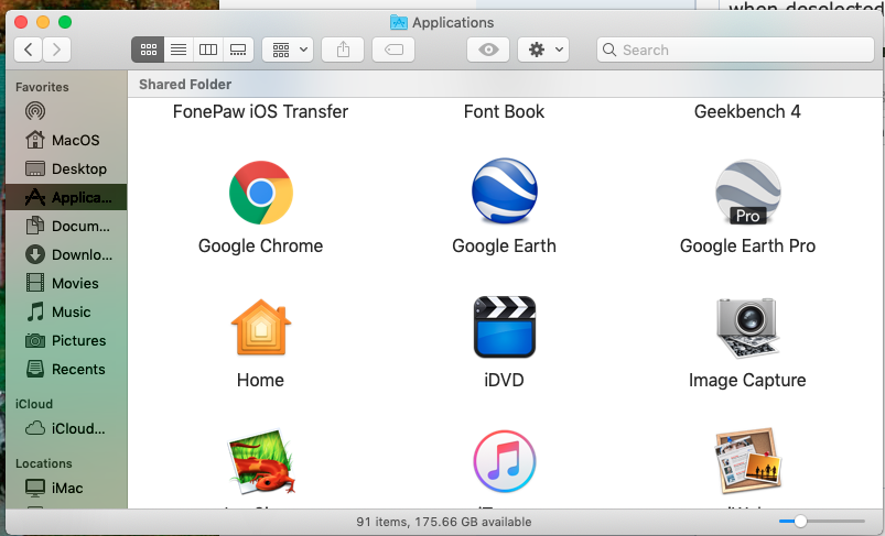

Hello pkoaume, when I install the Hybrid Mode for 10.14.1 the sidebar highlight looks dark when deselected. Instead of the gray highlight in the official screenshots. When selected it isn't gray either but a dark highlight Is there something wrong after all it worked correctly in the previous version.
