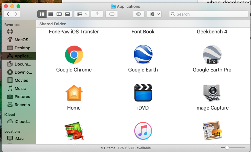

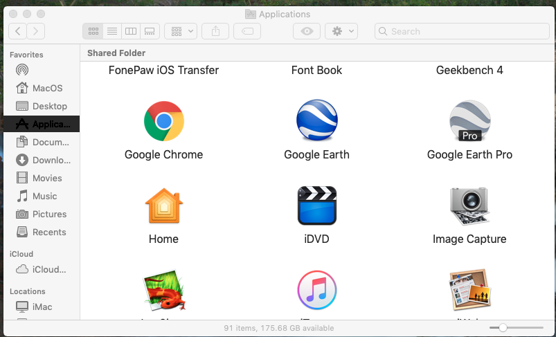

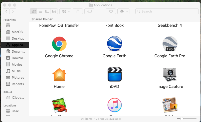

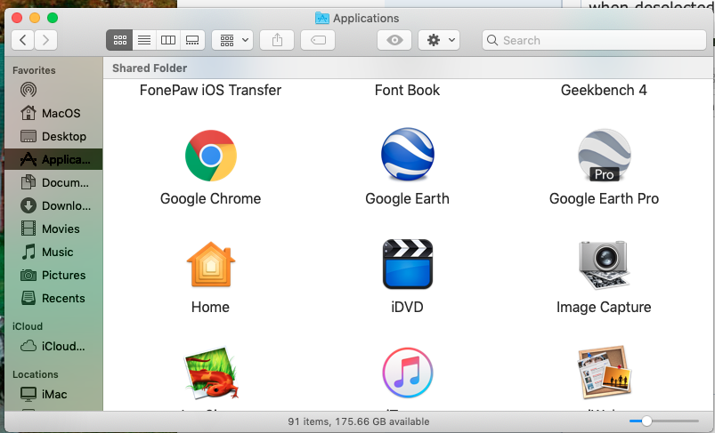

Hello pkoaume, when I install the Hybrid Mode for 10.14.1 the sidebar highlight looks dark when deselected. Instead of the gray highlight in the official screenshots. When selected it isn't gray either but a dark highlight Is there something wrong after all it worked correctly in the previous version.
View attachment 801406 View attachment 801407
That, and many other sweet fixes are on their way in v1.3 (soon). Stay tuned.
EDIT: the official github repo has a listing of all the upcoming fixes in the 1.3 milestone (no release date yet)

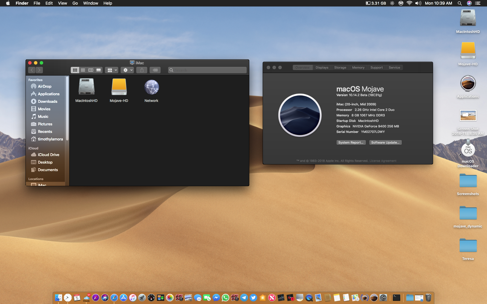

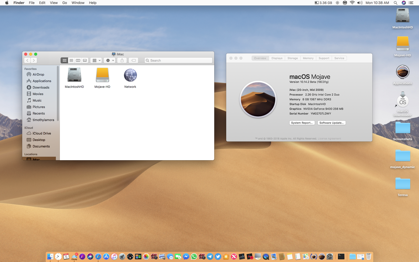

@pkouame What does Hybrid do and is it for certain systems only. Sorry to ask but I just didn't read the hundreds of posts regarding it.:(
Yes it should work for all systems I am testing on my mid 2009 iMac 9,1 and mid 2009 MacBook 5,2

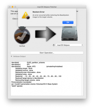

Good grief. I've been using DOSDUDE1's excellent patchers for several versions of macOS, so I'm well-versed in their use...but I can't get the Mojave patcher to successfully burn a USB stick to save my life. It gets the installer files copied to the stick just fine, but then fails trying to "personalize" the volume. Is there a command-line recipe I could follow at this point, to finish doctoring the USB stick?
I've tried reformatting the stick, tried using a partition on a hard drive, tried both 10.14 and 10.14.1 Mojave installers as sources. Same error every time.

Maybe I didn’t understand exactly what you did, but if you installed the OTA update you just have to boot from the USB disk with Dosdude’s Mojave Installer and install the Patches for your system (not the whole OS again, as you already applied the OTA update).
Hey! Thanks for trying to help! Sure, I did this after it didn't boot at first. It just never booted after patching and clearing caches and all the stuff described in the manual on the site. Tried this many times and no luck. :(
I don’t think that the USB stick with 10.14 can patch your 10.14.1, so maybe you should use another Mac to download the Mojave Patcher, download the 10.14.1 from the same Patcher, build the bootable stick and try to boot and apply the patches from that stick.
I agree. But this is my only "true" Mac, so for me it was that I took my PC laptop, installed a hypervisor, installed macOS as guest, downloaded all through that and made a new bootable USB flash with 10.14.1 Mojave and with updated patcher version 1.2.3.
