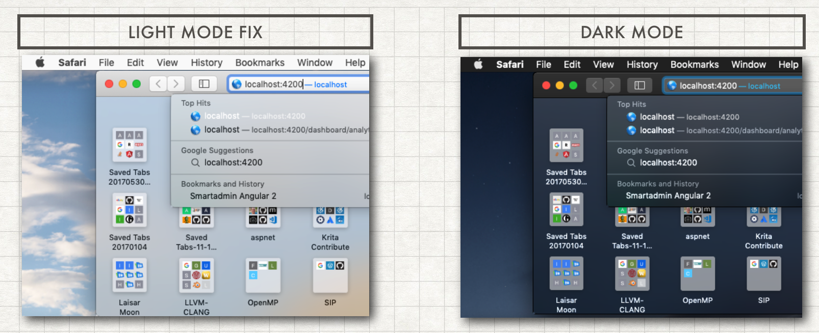

1. Search bar pull downs in apps like Safari and iMessage are back to vibrant in Light:

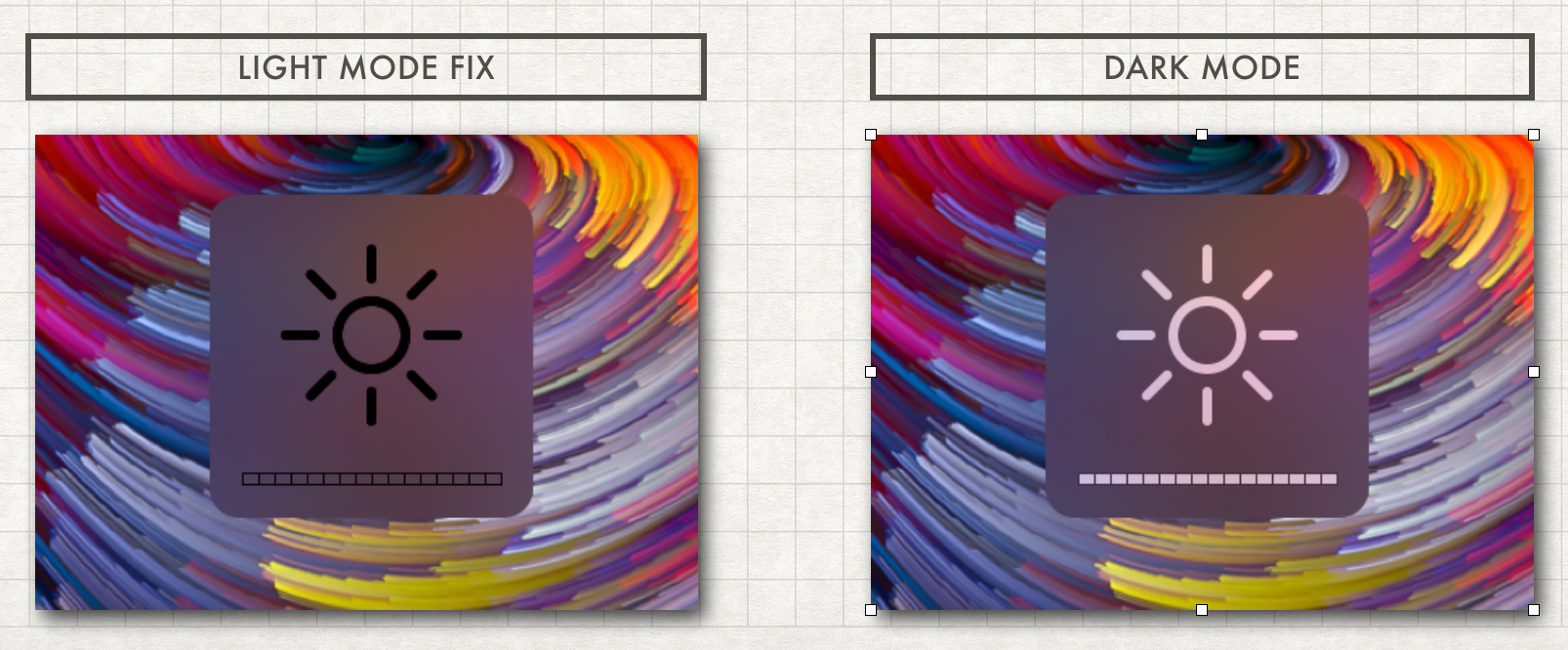

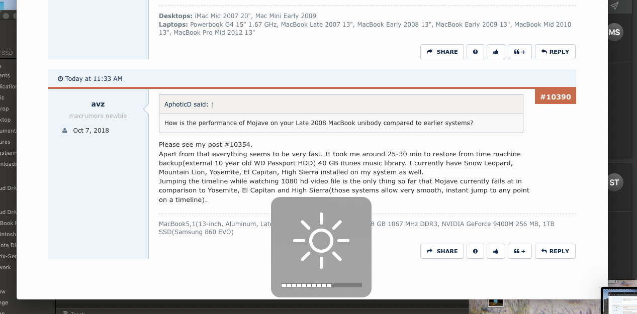

2. Brightness, Sound and other HUDs are "vibrant" in Light and Dark

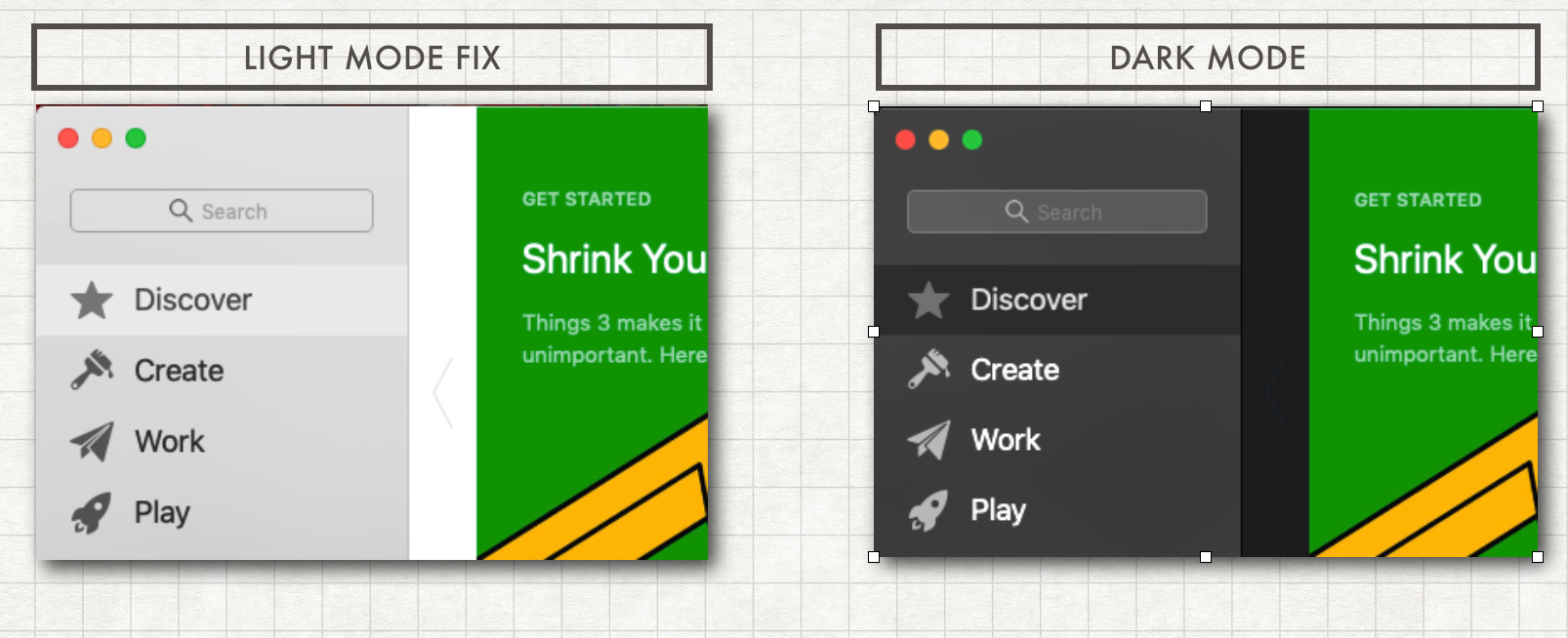

3. Sidebar Search element blends correctly with the background

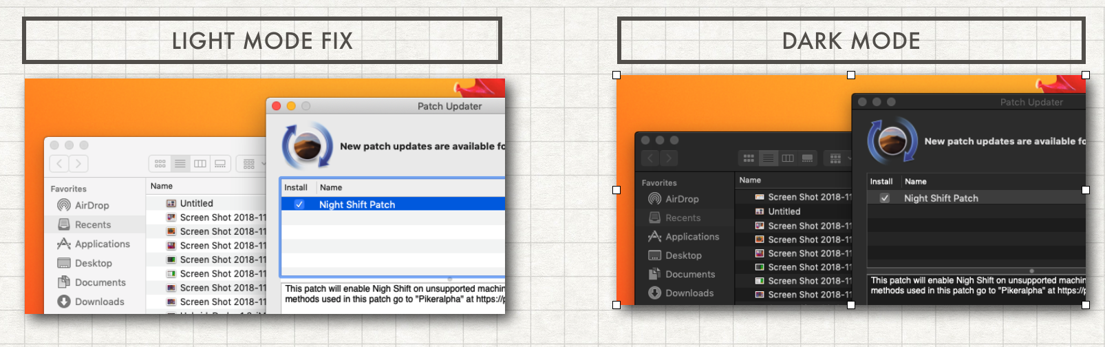

4. While "Inactive" Sidebar selections now blend in correctly
For the Brightness background, shouldn't it be switched? Weird how in light mode its a darker picture and in dark its a lighter picture. Is this off-the-rocker Apple's doing or chosen by you? Regardless, thank you for the continuous updates and work you put into this. I can use light mode again!

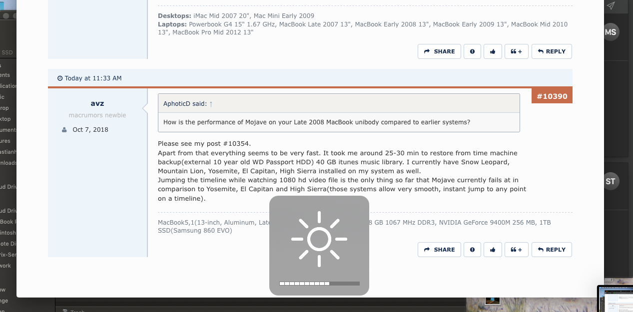

It is supposed to be like that and it actually makes sense when it comes to visibility (light symbols in darkmode, dark symbols in lightmode)
On a supported machine with darkmode (unfortunately on a white background):
