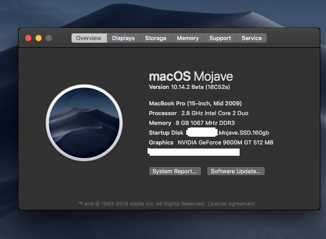

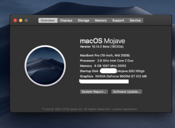

10.14.2 Beta 3 to 10.14.2 Beta 4 update
Successfully updated OTA and Mojave Patcher | MacOS Post Install.
Followed these steps as before.
  1. System Preferences | Software Update, then click on "update now". (goes without saying ... must be on developers or public beta program)
  2. It will reboot and then show "installing software update ...xx minutes remaining)
  3. When finishing step 2, it will again reboot. Now the next step (4) is important.
  4. Option-Key and boot to "Mojave Patcher" 1.2.3 thumb drive.
  5. run MacOS Post Install. Check on "Force Rebuild Cache" and then reboot.
  6. It will boot with the message "Finishing Update" on black screen.
  7. Then you are done!
Regards and good luck to all who are planning to update.
I can confirm this again, still the way to successfully update the betas.
Have done it on my MBP 4,1 17"

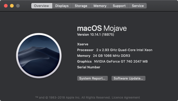

im pleased to report the Mojave patcher @dosdude1 made works lovely on my Xserve3,1 :)
upload_2018-11-29_1-18-24-png.807212
upload_2018-11-29_1-18-31-png.807213
(im running without any video patches as I have pulled the MXM GT 120 video card and installed a single slot PCIe NVIDIA GeForce GT 740 from EVGA which supports metal)
amusingly the patch updater wants to update some sort of audio patch despite the fact the Xserve having no audio outputs :D
