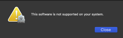

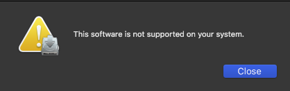

Why we cant update with combo update installer? @dosdude1 is there any solution for that?

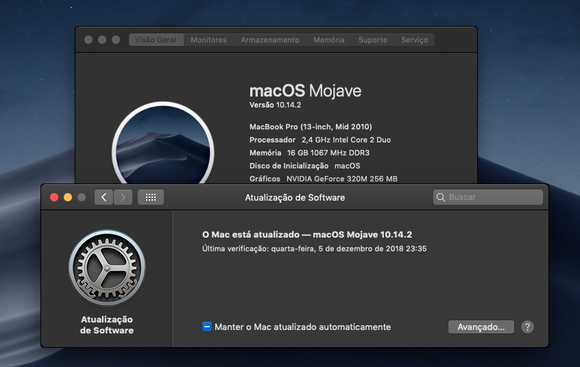

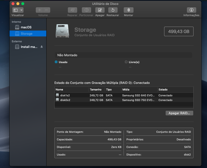

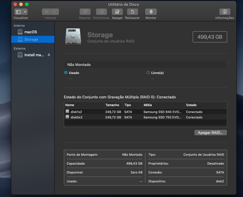

How did you get APFS to install on a RAID? Thanks in advance!
create manually from Terminal before Install Mojave
diskutil appleRAID create stripe Storage JHFS+ disk0 disk1
diskutil umountDisk disk2
gpt create disk2
gpt add -t hfs disk2
Enter DiskUtility from Format to APFS
after install Mojave and Post-Install Patch
boot single mode (cmd+s)
mv /usr/standalone/bootcaches.plist /usr/standalone/bootcaches.bak
reboot

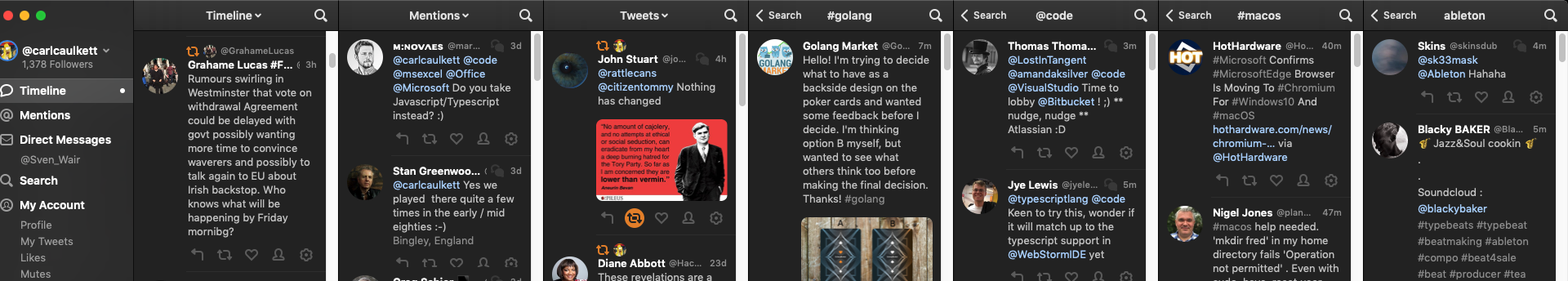

Also, one quick question, if I may. One of my apps Tweetbot has some visual glitches with the scrollbars showing up too brightly...
Interestingly, I sometimes have a glitch where my USB drive tries to dismount by itself. When this happens, it's normally accompanied by the wireless mouse ceasing to work. It's also at this point that the scrollbars in the app above become a very nice shade of black with rather attractive white framed black scroll handles. Sadly this doesn't help me much, because by this time the mouse has stopped working!
Is there some patch or other that can be applied to get my scrollbars to default to black, while the mouse is actually in working order?
It's not desperately urgent, but it's just about the only visual gremlin relating to graphics that I've been experiencing since I started doing these Mojave patches.
