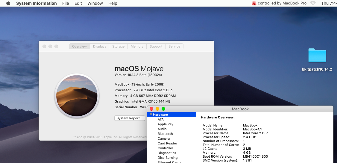

Managed to get my MacBook 4,1 (white early 2008) controlled by remote keyboard and mouse running on 10.14.3 beta.
Recap: Have not yet made progress with the broken USB (internal/external) functionality, still fumbling around with the 10.10.5 kexts to no avail.
As I´ve been very curious about finally seeing performance on such an un-accelerated machine (GPU), I tried some different approach:
- booted the 4,1s internal drive on a machine that Mojave works on
- installed Teleport 1.2.2 (special Mojave build)
- set Auto-Login to prevent password entry
- added Teleport to user login startup items and set Teleport to auto-accept incoming remote requests
then
rebooted the MB 4,1 with this setup, connected my 17" MB Pro, started Teleport there also and hooked up both machines per ethernet cable.
The result is astonishing. The x3100 intel GPU is fully recognized, full frame buffer (144MB) is used and at least the normal GUI/window/dock/side panel stuff is absolutely fluid. Lauchpad is much slower as it heavily relies on accelerated GPU usage, but once onscreen it is still usable.
See screenshot as a proof of concept - I hope that it triggers some more enthusiasm in the patcher community now (help greatly appreciated for more ideas what could be done to get onboard USB controller working...)
Edit: Anyone interested in the Mojave build of Teleport: Link here https://github.com/abyssoft/teleport/files/2414046/teleport_1.2.2.zip

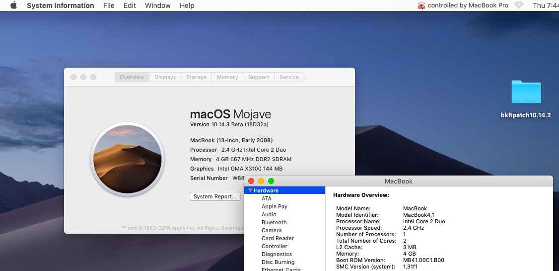

then

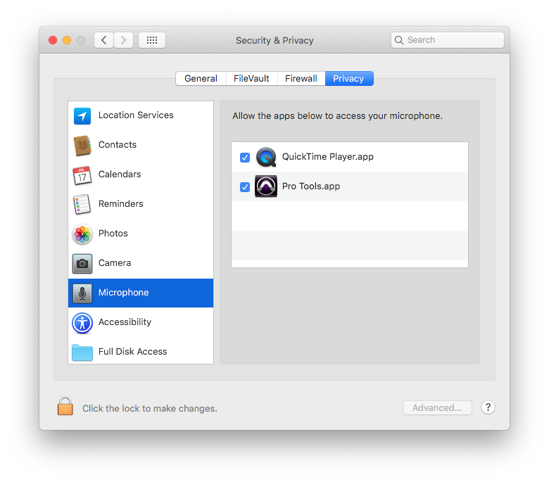

Hi,
I've installed Mojave on a Macbook Pro late 2011 and a Mac Pro 2008 (3.1). It works like a charm on my MacBook Pro but I got a lot of issues on my Mac Pro. Graphic issues even if I have a compatible Nvidia graphic card. Applications crashes (Logic Pro 10.4.2), wifi not working anymore. I had High Sierra running perfectly before trying to install Mojave on my Mac Pro 3.1.
Also, know that I took out the SSD of the Mac Pro and installed the Mojave Patch from my MacBook Pro, but I choose Mac Pro 3.1 when I got the configuration window.
Any Idea ? Also, is it possible to downgrade to High Sierra ?
Thanks for any help.
Reactions: TimothyR734
Hi,
Logic might need to access your microphone within the security pane in system preferences. It's a common issues with other DAW in Mojave. Even if it just says 'microphone' other audio inputs are included.
(I don't use Logic but see the screenshot attached)
