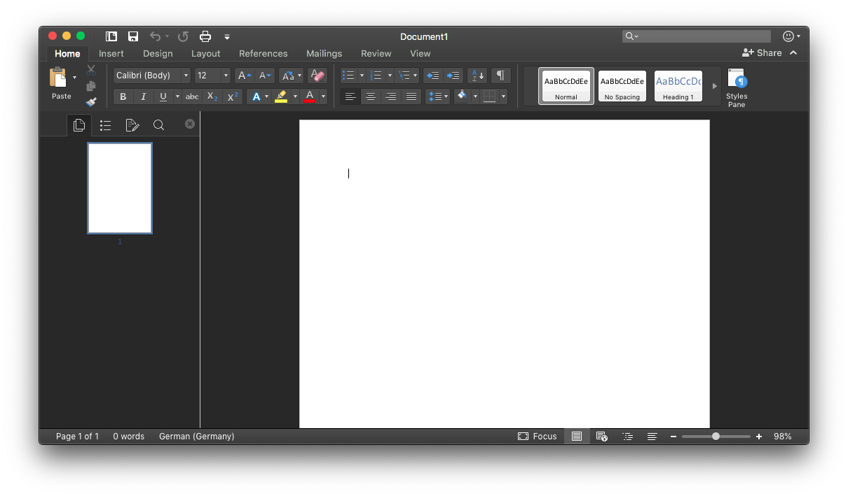

Anyone have issues with getting SSO authentication to work with Office 365 on unsupported Mojave?
I installed an SSD in place of the optical drive in a late 2009 27" iMAC and used that to clean install Mojave. It went well after including the iSight patch (wasn't selected by default). However, I kept hitting issues with SSO active directory activation of office 365 products.
When I went back and did a clean install of High Sierra, activation works just fine. I'll probably give it another go...maybe just update the HS installation on the new SSD (instead of wipe and clean)?
On a side-note, I ended up installing HS via recovery (via my old HDD that I'm keeping in the machine). That approach would not produce the recovery partitions on my SSD. However, once I re-installed HS through the App Store, it put everything there:
