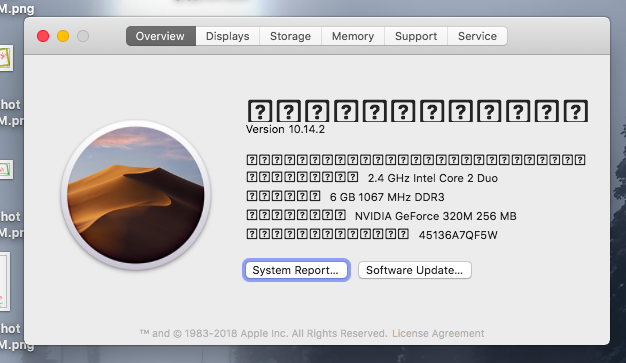

Want to share a bizarre case/experiment, I had an unused MBP (No APFS support) with Mojave GM 10.14.0 HFS+ previously installed and manually patched, then I noticed today that apple released (3 days ago) the full 10.14.3 combo update 18D109 here: https://support.apple.com/kb/DL1992
So I have manually patched the "Distribution" following the recently tips posted here (but initially well instructed by @ASentientBot) and I have done an in-place HFS+ combo update, everything went fine unless I couldn't open many core apps stucking with an high % cpu and ram saturation over the process "Reportcrash", I'ven't figured it out to solve it, so I decided to attempt this:
I had a full 10.14.2 installer on a thumb drive, so I decided to replace/overwrite (normally re-installing over the same drive while booting from the usb) the main (broken) 10.14.3 with a clean 10.14.2 and even with many errors inside the installation log (CMD+L) with my big surprise all user settings/apps have been correctly migrated w/o TimeMachine, the "downgrade" has succeeded and previous issues gone.
