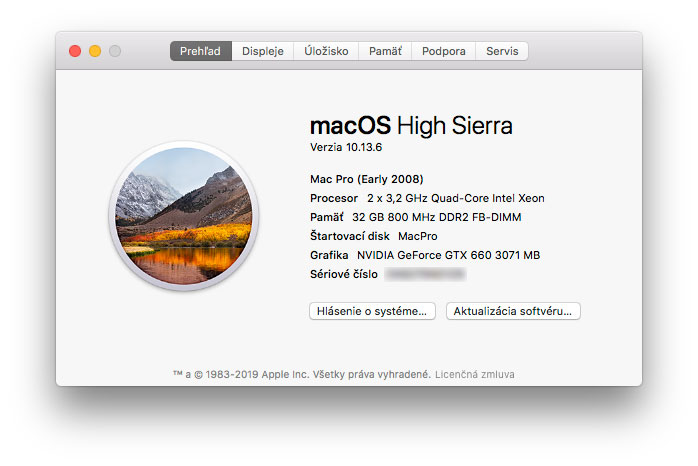

Hi everyone, i have this MacPro (attachment), i try install Mojave on this, install process go fine, but by booting everytime stops about 75 %, i have try everything (different USB, different disk, different install package, different disk format), i lost my hope almost, have you any ideas what is wrong? Thanks all for ideas

Yes i have apply the post install patch also with force cache rebuild, still the same crap for me :(
Second: Nope, with GTX660 i haven't the EFI boot screen, i use the original graphic card (ATI Radeon) delivered with the MacPro for install purposes.

Right, it sounds like you have applied dosdude1's installer correctly. If you have time try this just to see how the Mac Pro does. We know it is quite capable of running Mojave. Take out the 660 and just use the ATI Radeon HD 2600 XT. The card does work in Mojave but use the legacy video patch to get the best out of the card. See if this gives you a working copy of Mojave. If this works then the problem may lie with the 660 card. Mojave is known to be a little fussy over some cards especially those without a Mac efi. Even then the odd video output may not work especially those with any vga type adapters.

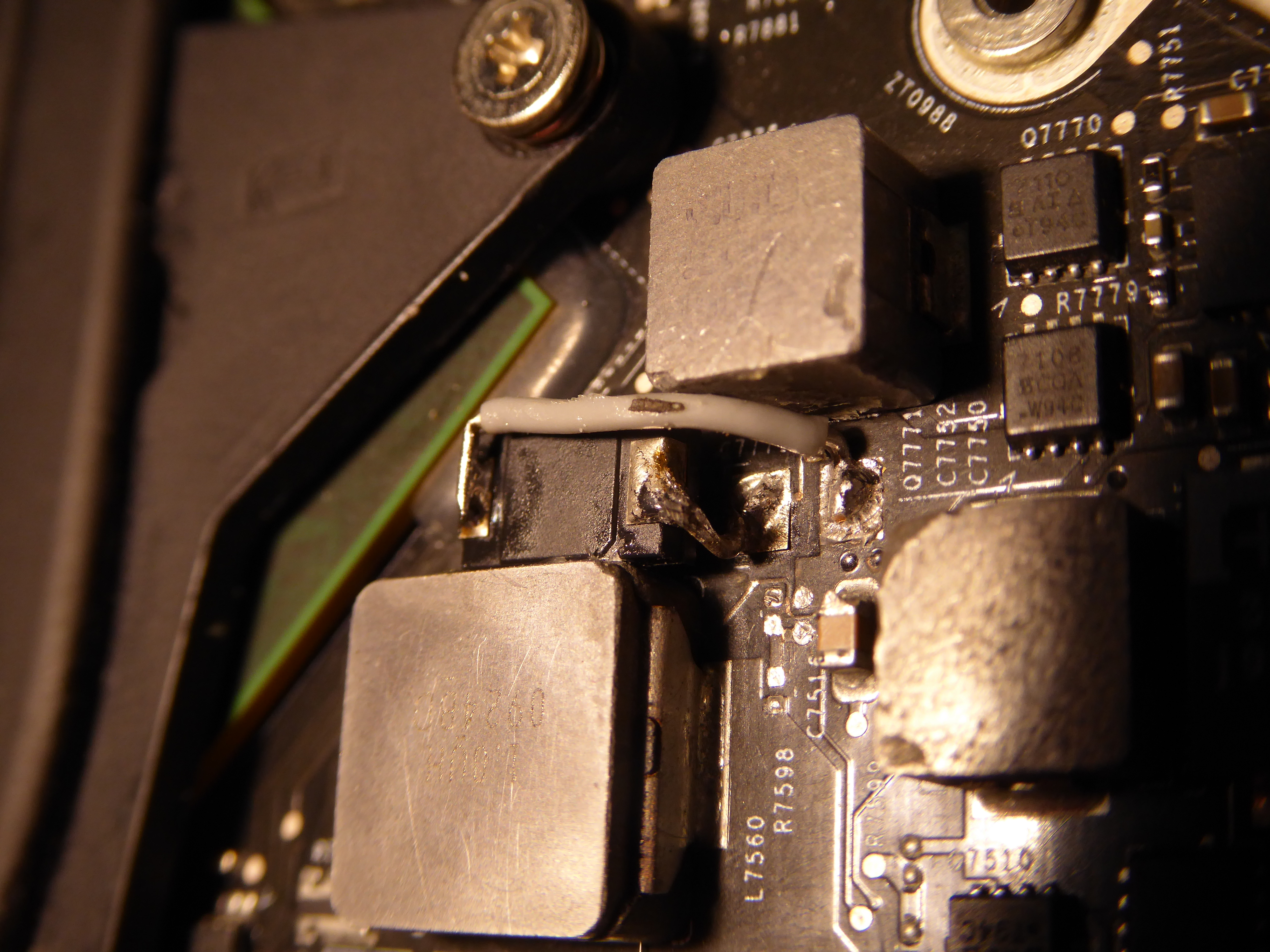

[Regarding hardware I replaced capacitor C7771 in December when the machine had developed spontaneous shutdowns. Dosdude had hinted that C7771 is the very likely culprit, and in fact it was. I used his video here:
and this description to remove the logic board: https://de.ifixit.com/Anleitung/MacBook+Pro+17-Inch+Unibody+Logic+Board+Replacement/3447. My physicist's bricolage with two wires between the pads and the replacement cap (tantal 330microfarad, 2.5V) seems good enough.
During this repair I must have hurt a component of the one-wire circuit: the voltage comparator U6915 (an LM397) with the symptom of dim green light on the Magsafe connector and very slow charging. Identified the problem with the help of Louis Rossmann's video here:
and a voltmeter, replaced the LM397.]
My MBP5,2 is again a reliably workhorse, software and hardware wise. Thanks dosdude and Louis Rossmann!

Gtx 660 is broken since high Sierra. Same with the 650 ti and 660 ti

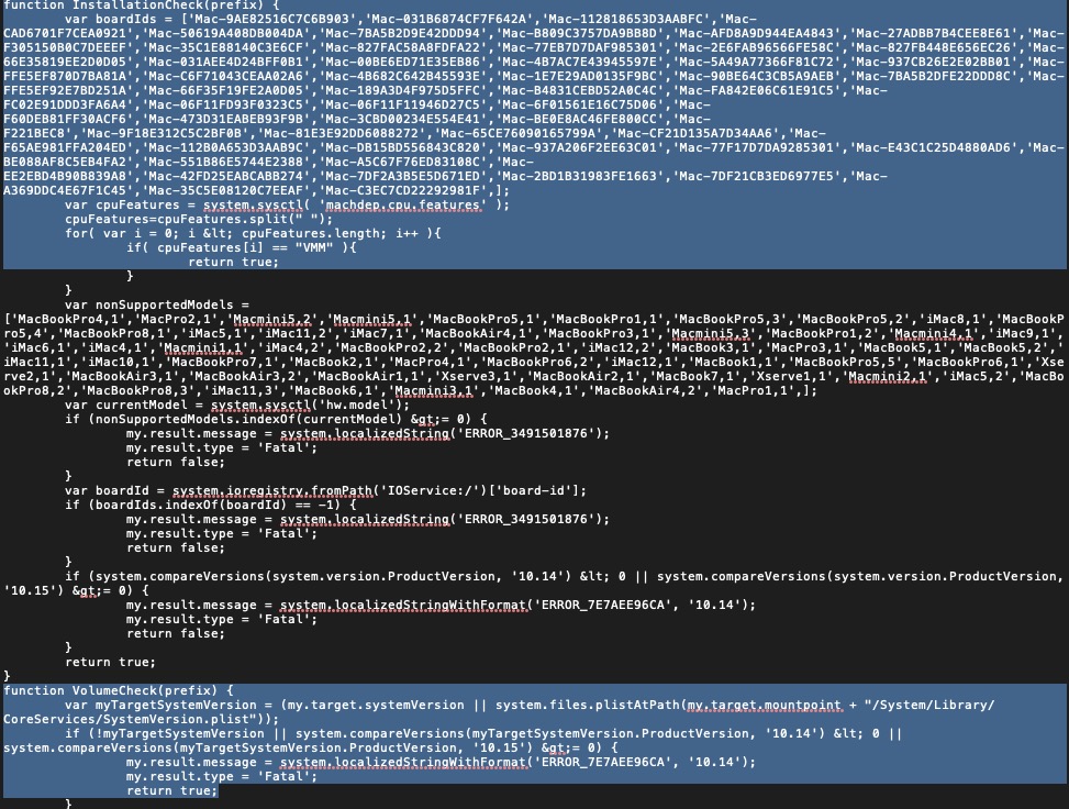

Well done for relating stuff that has already been mentioned and just changing a few words, Olad has already mentioned that he has successfully installed the supplemental after I directed him to my previous instructions.
[doublepost=1549818774][/doublepost]

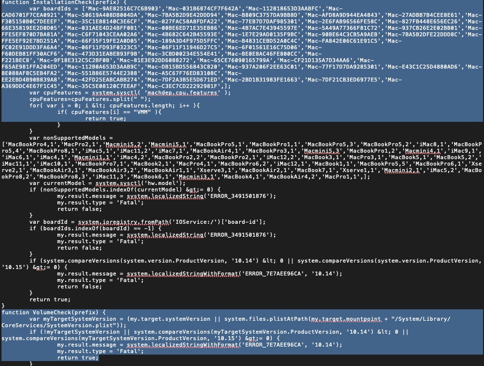

@alphascorp:
So I followed your receipt:View attachment 821028
But it didn't work here on iMac11,1 .
Did I something wrong?
Try again and follow my instructions, as mentioned earlier.
If you want to try again, this works.
Download the update.
Open the update.
Move the update.pkg to Desktop.
Open Terminal.
Enter pkgutil --expand now drag and drop the .pkg from the Desktop into the Terminal window and type after a space ~/Desktop/Expanded hit Return and wait, this takes a little while.
Open Expanded folder and then open Distribution file in Text Edit
Scroll down to the line
function InstallationCheck(prefix) {
enter the text return true; so it looks like this
function InstallationCheck(prefix) {return true;
Now save the changes
If you are trying to install the update to an HFS+ disk then there is another alteration you can make, before flattening and creating the package.
Again in the Distribution file scroll down to
function VolumeCheck(prefix) {
again enter return true; after the bracket, so it looks like this,
function VolumeCheck(prefix) {return true;
Save changes
Go back to Terminal enter pkgutil --flatten ~/Desktop/Expanded ~/Desktop/Modified.pkg
Using the .pkg extension is crucial.
One thing to note is if your Mac like mine has different OS's on it on other drives this method will tell you that all drives are able to install the update, DO NOT INSTALL ON ANY DISK/ PARTITION, ONLY INSTALL TO A DISK/ PARTITION THAT HAS MOJAVE ON IT. Select your disk wisely, and double check.
HEY MAN, THIS WORKED!:)
Yes, it was the insufficient description, where to position this "{return true;" - thing exactly!
Ten letters and two special characters can change the reality...
Thanks a lot.
