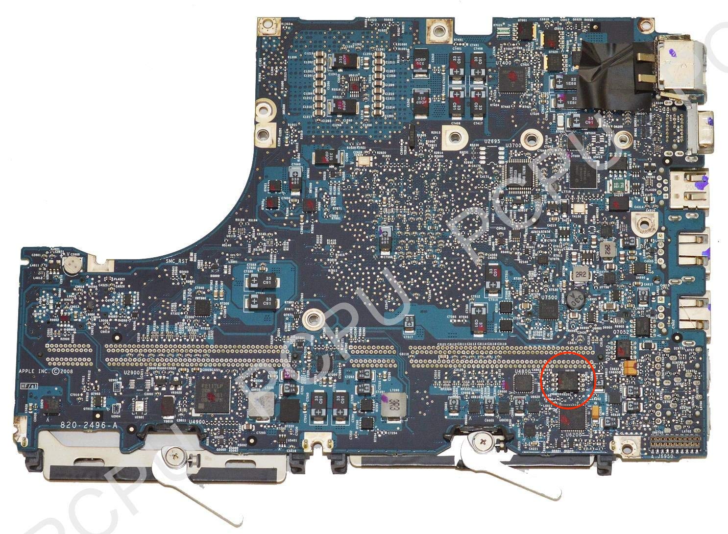

Hello everyone,
my MacBook 5,2 and I, we celebrated our 10 years companionship this month.
Today I opened the MacBook to identify the type of EEPROM in order to choose the right type for flashing APFS Rom-Patcher.
Unfortunatly, I couldn't find the EEPROM.
Please, can someone tell on which side of the printed circuit board the EEPROM is soldered?

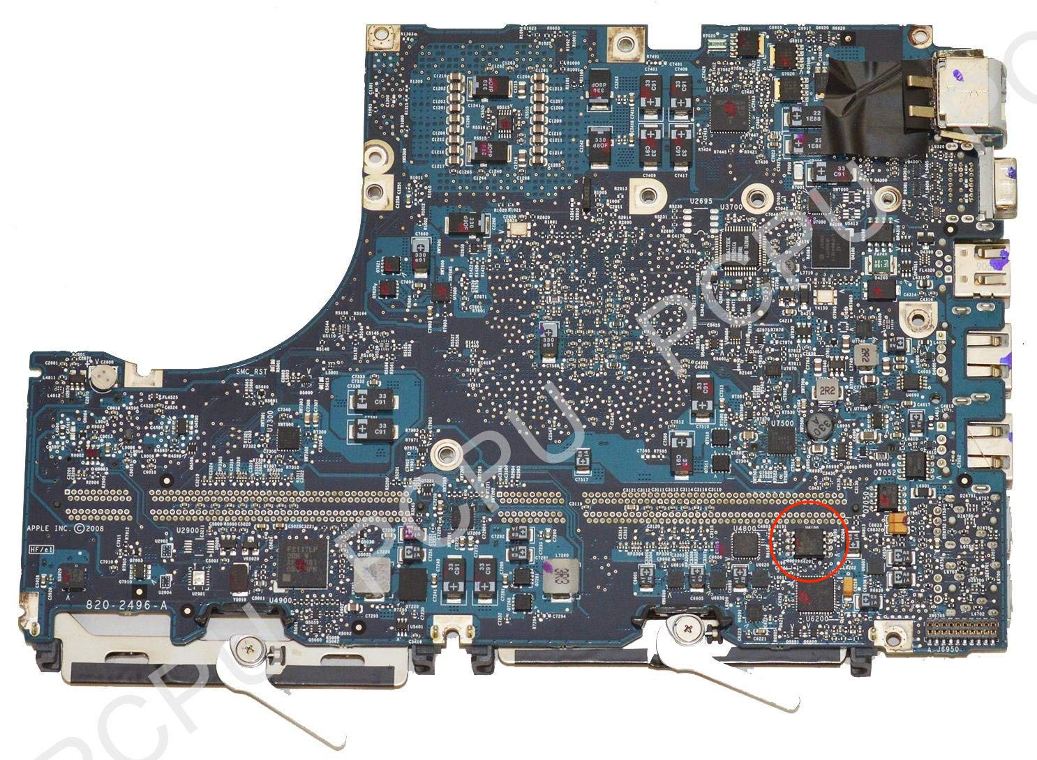

Hello everyone,
IT IS here ! and VERY SMALL.

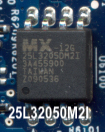

The image I've uploaded shows the position. Reading the number to identify yours is difficult. I first tried a magnifying glass. Even that didn't help. I tried taking a photo with my iPhone - I couldn't get it to focus well. I succeeded taking a 2400 pixel per inch color scan using a flat-bed scanner - then zooming in on the picture - I added an annotation on picture giving the number for future reference.
Here is mine cropped and blown up to 200%

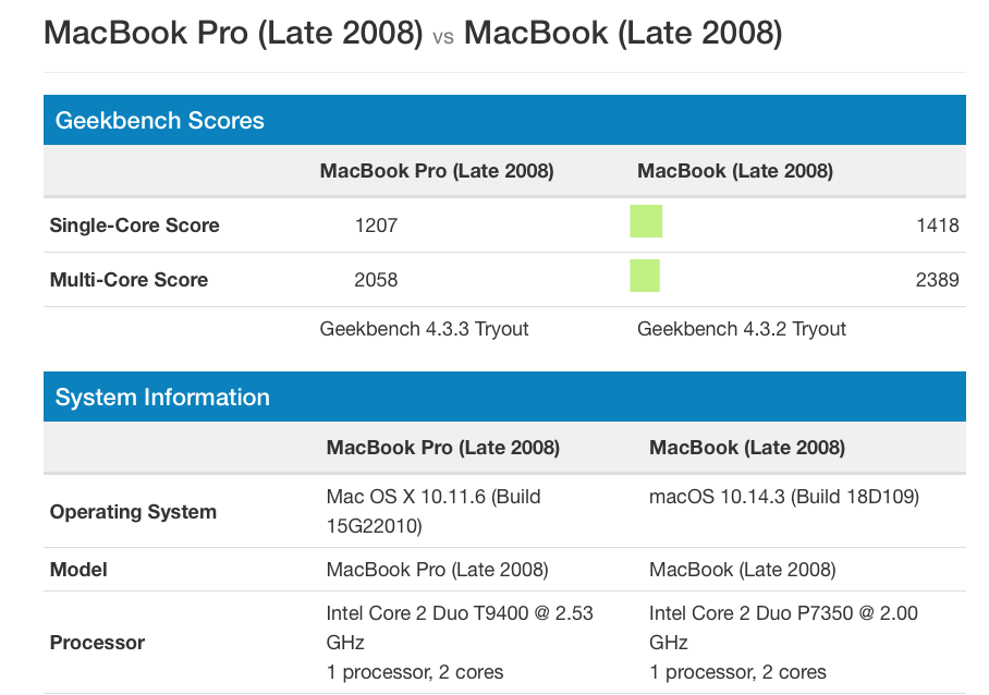

For those who like crunching numbers!
I am sure that something went wrong here and it should not be possible but my 2.0 GHz Late 2008 MB with 3Mb L2 cache just owned a 2.53 GHz Late 2008 MBP with 6Mb L2 cache:
Full results:
https://browser.geekbench.com/v4/cpu/compare/11824328?baseline=11977576
Probably maintenance issues with the MBP but nevertheless makes you wonder and put the numbers in perspective.
Edit: I run Geekbench 4.3.3 as well(because that is what the guy with MBP used) and my results were 1421 and 2391.
