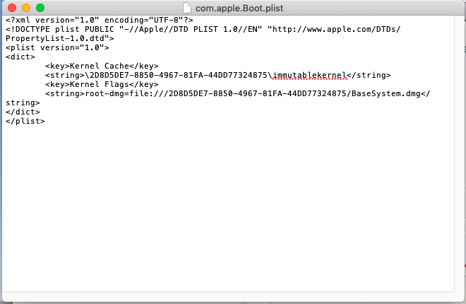

adding next to the "BaseSystem.dmg" string this: "BaseSystem.dmg -no_compat_check -v"
In this way at 99% of the times you can pass the prohibitory CMD+R symbol.
Just to be clear, this is my com.apple.Boot.plist.
Where exactly do I need to add this "BaseSystem.dmg -no_compat_check -v" ?

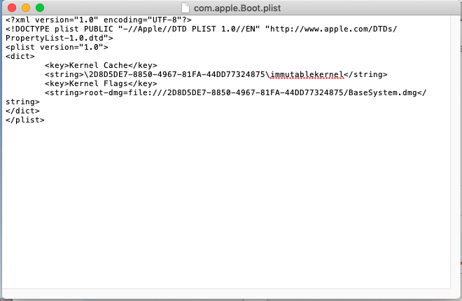

Exactly in this way:
<string>root-dmg=file:///2D8D5DE7-8850-4967-81FA-44DD77324875/BaseSystem.dmg -no_compat_check -v </string>
insert without quotes of course and save the com.apple.Boot.plist
At next reboot you should boot with CMD+R, if it works then you can drop the "-v" re-editing the com.apple.Boot.plist, showing the Apple Logo with progress bar instead of verbose code lines, they're needed only for diagnostics.
Got it. Everything is as it should be now with full access to Recovery if or when needed.
Thanks to jackluke for making this happen and flygbuss for pointing me in the right direction.

For those of you with systems that are stuck at around 75% or so:
Same issue happened to my Mac mini 5,1.... I was able to resolve this by
logging in remotely
invalidating the kernel cache: sudo kextcache -i /
rebooting: sudo reboot
Installation completed as expected and everything is working correctly.
Hi i have the same issue, after install patched Mojave on MacPro 3.1, boot stuck on approx. 75%, please how can i logging remotely? I have a Macbook pro also.
Thanks for answer.
