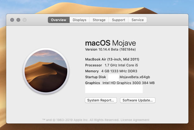

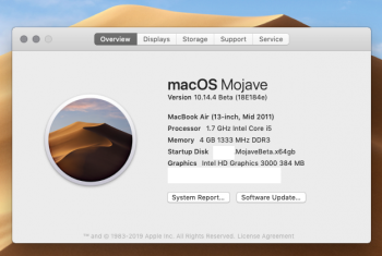

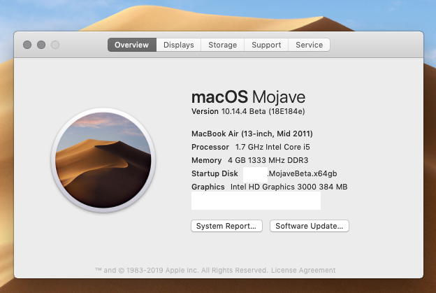

@DaniloGeekDude 10.14.4beta2 is out, could you do an attempt to update your MBA re-renaming the IntelHD3000 OpenGL bundle2 to bundle and checking if you can reach the desktop with acceleration (transparencies and so on)?
OTA update went fine.
But with the IntelHD3000 OpenGL renamed to original bundle folder name, it failed to boot again. Renamed bundle to backup folder name. Rebooted Fine after. I guess still no acceleration at this beta 2.
Please let me know if you have any other suggestions to have the acceleration enabled.
Thank You.
Thank You.
You need to re-apply the entire Legacy Video Card Patch... The OTA update overwrites the IOAccelerator bundles.
Actually, that's what I did (re-ran Patch Updater), which "restored" the IntelHD3000 OpenGL to it's bundle file name. Subsequently, it did not reboot as before. So I had to delete the same bundle file again in-order be able to reboot.

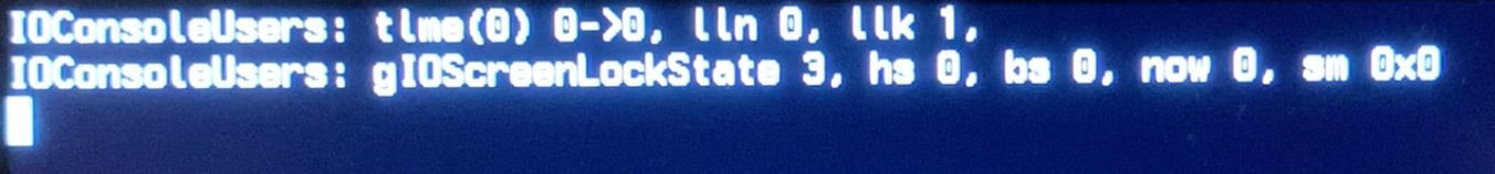

I haven't been following for a while because I stopped using my unsupported Macs a while ago, but because of the issues I thought I'd try to update to beta 2 on my mbp 15 2011.
So I installed 14.3 first, and then tried to update to 14.4 beta 2.
It hangs, and when it does, all I get is two lines of momentary flashing text every 30 seconds or so in verbose mode. (See picture)
Unfortunately I think it makes sense that apple would eventually remove OpenGL completely.
But at least we can still use 14.3, and maybe security updates could still work.

It's a known issue, @ASentientBot found a workaround in dropping the OpenGL feature, if you can isolate your Mojave booting only to IntelHD3000 then boot holding CMD+S single user mode and rename the /S*/L*/E*/AppleIntelHD3000GraphicsGLDriver.bundle
into AppleIntelHD3000GraphicsGLDriver.bundle2
In this way at next reboot the OpenGL kext of your GPU won't be loaded in the prelinkedkernel and you can reach the desktop.
