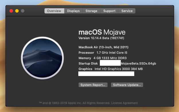

@jackluke,
There is no AppleIntelHD3000GraphicsGLDriver.kext on the /S/L/E folder. However, it does have a AppleIntelHD3000GraphicsGLDriver.bundle
Are those the same? Thank you.
EDIT: I did find these entries on Info.plist under /Contents of the bundle.
<string>AppleIntelHD3000GraphicsGLDriver</string>
<key>CFBundleGetInfoString</key>
<string>AppleIntelHD3000GraphicsGLDriver 10.4.14</string>
<key>CFBundleIdentifier</key>
<string>com.apple.driver.AppleIntelHD3000GraphicsGLDriver</string>
So my follow-up question --- is the bundle file the one I need to rename? Thanks.

@jackluke,
Yes, essentially .bundle and .kext mean the same thing, a kext after-all is bundle package of plist, binaries and resources, so just rename .bundle to .bundle2 and upon @ASentientBot's suggestion you should be able to boot w/o acceleration anyway.

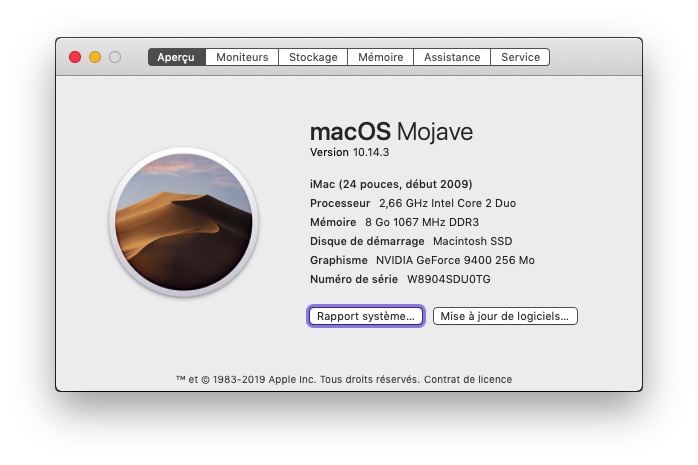

Hi,
Great ... my old iMac 24" early 2009 is running very well under Mojave 10.14.3
No problem.
Thanks a lot

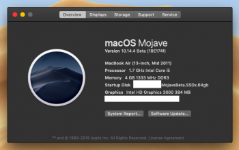

Thanks @jackluke
Now I am able to login to my beta 10.14.4 MBAir, 2011 by renaming the bundle file.
