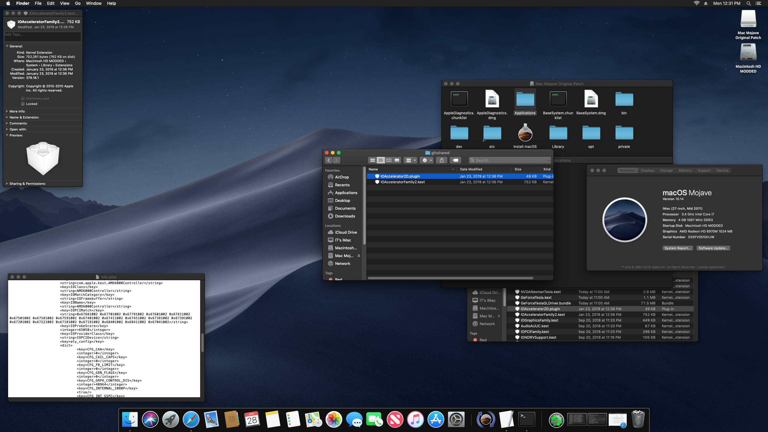

So I was poking around at the loaded kexts today, trying to see if there was anything to be done with the lack of acceleration on a couple 6970 equipped iMacs I have here when I saw that although the 6000 controller and associated kexts for it were loaded that the IOAccelerator2D.plugin and IOAcceleratorFamily2.kext were the original ones from the installation and not the ones in the "gfxshared" folder inside the Post-Install app.
I copied those two files over and replaced the originals that were in System/Library/Extensions and rebooted...
On reboot I found that I did not have the "inverted" color issue and I didn't have the almost unusable window issues, like disappearing contents when dragging or artifacting. It's definitely not as snappy as a fully accelerated card - but short of replacing the internal 6970 with a 4XXX series card from an older iMac I think it's as good as I'm going to get on these.
This was on a Mid 2011, 27 inch and I used the original patcher and first retail release. I'm going to try the same thing with the updated patcher and 14.3 on another nearly identical machine and verify it works with that too...

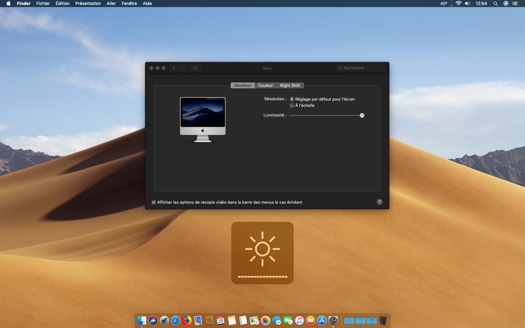

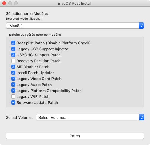

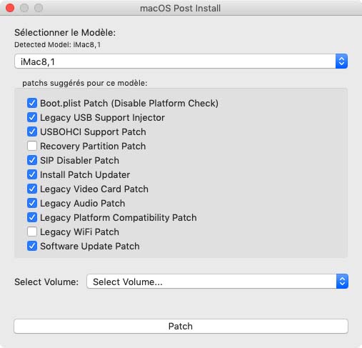

Thank you Larsvonhier,

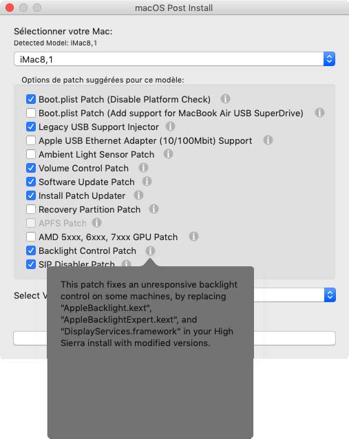

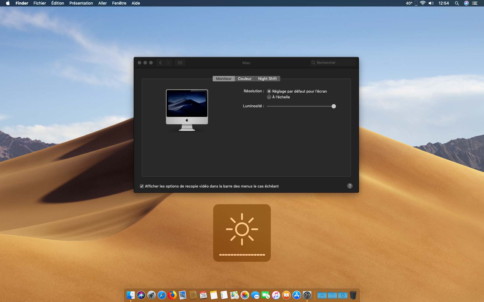

Now I have reinstalled 10.14.3 and my iMac 8,1 starts properly after applying the "macOS Post Install" and selected force cache rebuild before rebooting. but still no backlight control with F1/F2 (only the display works with F1/F2 but does not control the backlight). I really wonder if the backlight patch should not be applied. But it automatically applies with "macOS Post Install". How to make it not apply?

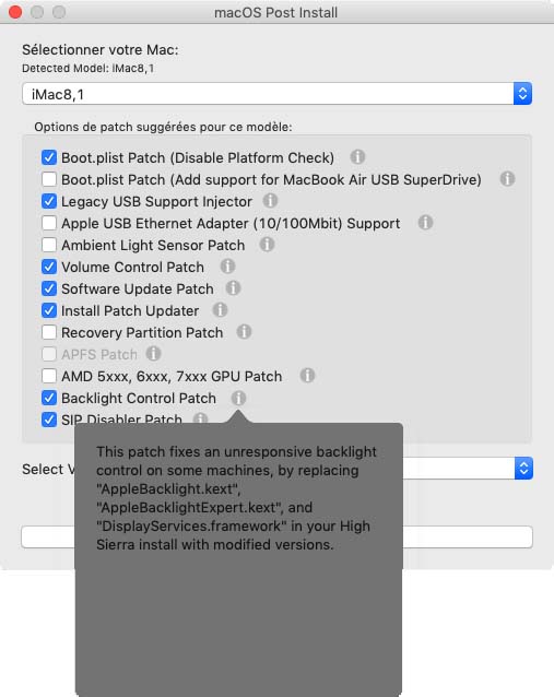

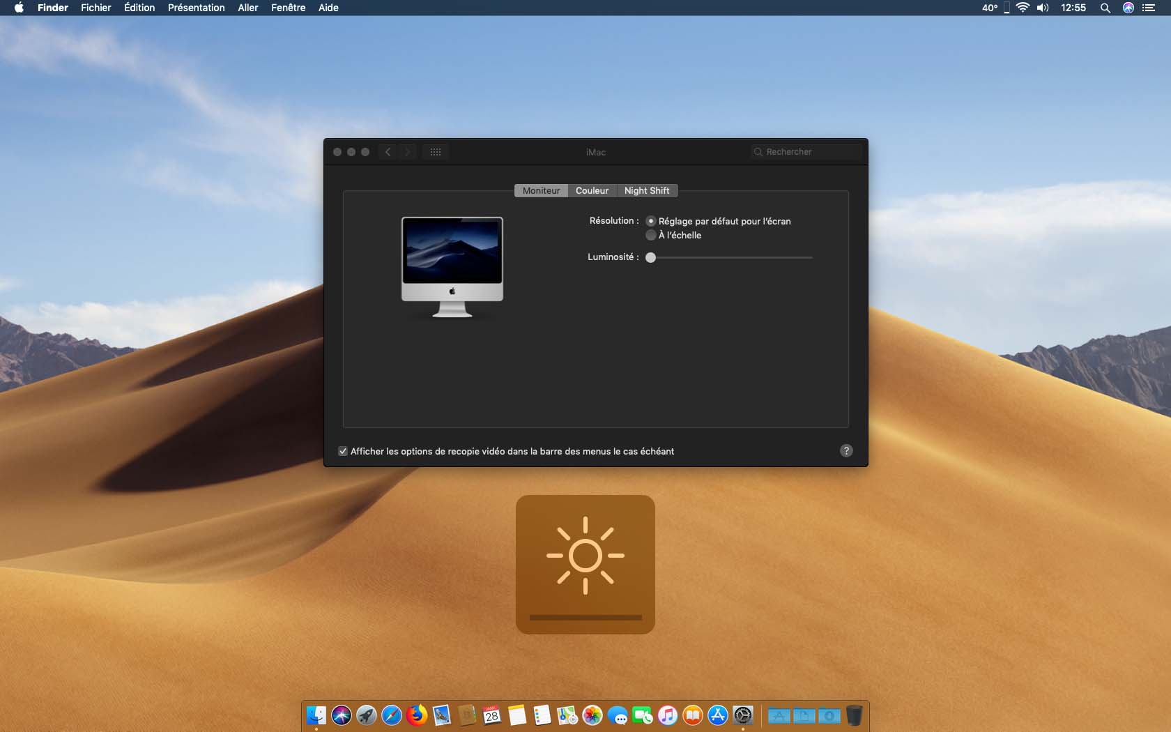

Under High Sierra the backlighting controlled by F1/F2 works fine and I also have the folder "Bklt_Backup" and "CoreBrightness-Backup" so I guess the patch was also applied under High Sierra.
View attachment 818605 View attachment 818606
I confirm, under High Sierra backlight control was patched for the iMac 8,1 (I find that the information of the "macOS Post Install" High Sierra to indicate what each patch does is great but unfortunately it is not is no longer the case with "macOS Post Install" from Mojave ...)
View attachment 818667 View attachment 818668
You are on the right track, but the CCFL backlight patch is something different from the one in the post-install patcher.
You should only apply the latter on an iMac8,1 (and others)
Also note that you can always disable single patches but once patched, some cannot be undone by re-patching again.
You could try to run patchupdater on a running system and (independently what that tool reports) just re-install patches from there.
This helped on one of my macbooks (5,2) where I could not get backlight control otherwise...

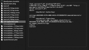

Unluckily as I wrote before, each one use custom disks partitioning and the APFS Recovery mount point could vary, so that's why it's hard to write an universal script for it.
Boot normally Mojave, launch Terminal and type:
diskutil list
diskutil apfs list
Report here your current disks/partitions scheme, and I'll try to help you to pass the CMD+R prohibitory symbol.

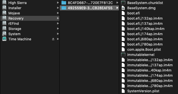

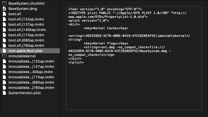

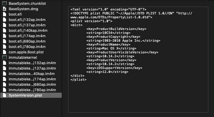

A PDF of the results is included. Screenshots of the result after running my script on my Recovery partition are included. My Recovery partition is disk2s3.

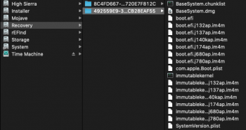

At first glance you have (as many of us) a very personal custom disk partitioning, you use one physical disk I guess 2 TB internal (for disk0-1-2-3-4) and another physical external 1 TB (for disk5-6 time machine), but I notice a weird thing an HighSierra installation in APFS on disk2s5 and inside the same container another "System" on disk2s1 (I guess it's Mojave and moreover you have a Filevault Enabled on it maybe also this could be the issue with CMD+R), then you have another slim Mojave installation in APFS on disk4s1 with another Mojave Recovery disk4s4 annexed, but I bet your main issue is due to the disk2s5 that infact has produced a double UUID inside your main /Volumes/Recovery/ path I mean the folder "8C4F...12C", so in your specific particular case I can't help you quickly, but I noticed also that you use "Refind", in this case you can easily boot the APFS Recovery selecting one of the two "lifebelt" icon available during your Refind bootloader countdown, meanwhile you will able to boot the APFS Recovery anyway from there.
Instead to continue to try to help you to use CMD+R, you should set a general system nvram variable with "-no_compat_check -v", I know many prefer to see the fancy apple logo but temporary you have to put the "-v" forcing the verbose boot, because only in this way you can see exactly what's behind the infamous prohibitory symbol.

Recovery works when I boot it from rEFIn and patch it with my script. Idk why but I can’t get CMD + R to work. I tried once with the NVRAM variable and it booted but the input devices weren’t working. I will release an update to my patcher and you can try part of the code on a normal partition map if you want. In my situation it just won’t work with CMD + R.
For fixing usb input devices you should use/copy the dosdude1's Mojave Installer "prelinkedkernel" renaming into "immutablekernel" inside your APFS Recovery path, but I believe your issue is between Filevault Enabled and HighSierra-Mojave inside the same APFS container.
Otherwise try to patch your other APFS Recovery on disk4s4 probably it's the one associated to CMD+R by your last Mojave installation, because the last you install becomes the first blessed for macOS default booting.
