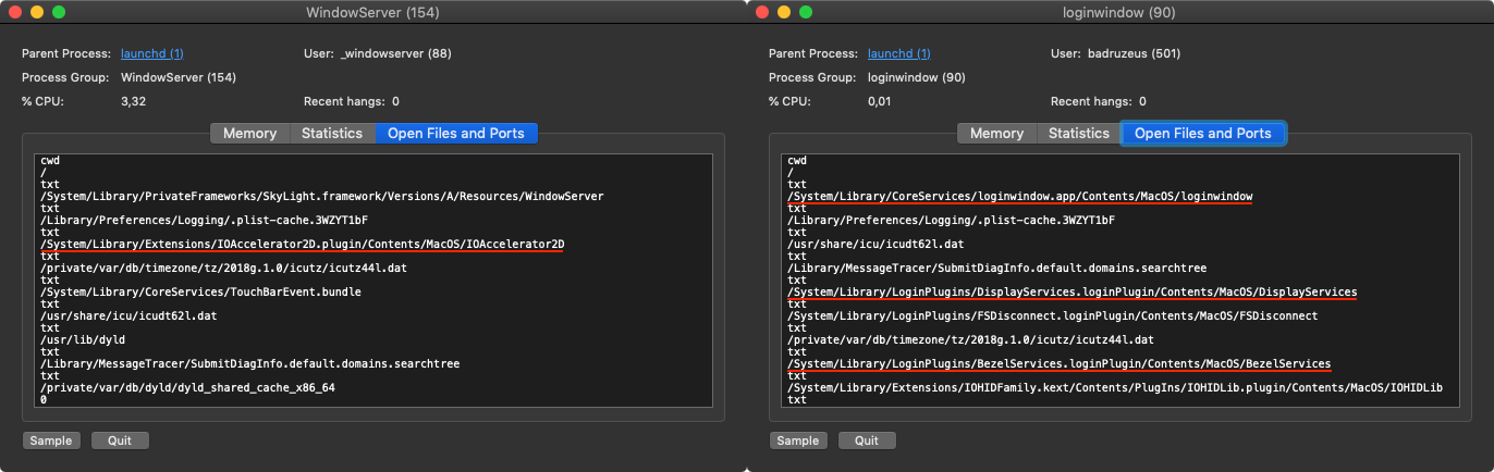

A dmesg log confirmed that it's WindowServer crashing (error message of "too many corpses being created").
Is this using untouched System's Frameworks (vanilla)? Interesting! If so, I guess something was really wrong with this Beta (which actually is aimed for dev & tester #LoL) that caused dependency problem.
I could only solve that by disabling the OpenGL driver. After that it works fine, but no acceleration of course.
Yeah, sure.. CoreDisplay, IOAccelerator* are not loaded on VESA mode (or disabled nvAccelerator: if "sudo nvram nv_disable=1" with Nvidia gfx being used). SafeMode on Nvidia is still using CoreImaging (CI / Draw), NVDA~HAL*.kext is still loaded so, this still loads CoreDisplay (IOAccelerator && GeForce are for QuartzExtreme / QE / 3D).
I don't have time to test more now, but I'm worried that Apple's somehow broken the OpenGL fallback mode. Any ideas? (Replacing the WindowServer/SkyLight has never worked for me, it's too version dependent.)
OpenGL is still there, at least my NVDA Fermi (that's not Metal-capable) is still alive with full gfx accel. Seems like a bug with WindowServer itself, but these are my inspections when booting 10.14.4 Beta 1 (not sure what will we do with these? #LoL.. you may try replacing only CoreDisplay and DisplayServices from 10.14.3; and keep SkyLight, WindowServer, CoreGraphics vanilla from 10.14.4).
#EDIT: As we could see, WindowServer needs _dyld to be rebuilt so... replacing only is not enough w/o:

Not sure what system you're on, but with nVidia Tesla, just move /S*/L*/E*/GeForceTeslaGLDriver.bundle. But the system will be barely usable. I'd just stick with 10.14.3 for now if I were you.
sudo update_dyld_shared_cache -force

Try replacing /S/L/PrivateFramework/IOAccelerator.framework and or its plugin inside /S/L/E/ with previous Mojave 10.14.3 , it's involved too in graphics acceleration at loginUI and WindowServer.
[doublepost=1548836603][/doublepost]
I may have misunderstood the requirement (disabling OpenGL driver). My unsupported MBAir4,2 has Intel HD 3000 graphics. All I wanted to test is 10.14.4 beta installed on this sandbox device. And I thought doing so can finish the boot without WindowServer crashing as I experienced previously.
I know well these kext family when I played with their VRAM, for IntelHD3000 the OpenGL driver is simply this: /System/Library/Extensions/AppleIntelHD3000GraphicsGLDriver.kext
So just rename it to something else (ex. A*.kext2) or move out from its folder or delete directly and an automatic kextcache schedule will occur at your next reboot and as @ASentientBot stated without OpenGL you should be able to pass the LoginWindow with the current 10.14.4 beta.
If for some reason you still can't reach the LoginUI then repeat the same steps even for its Framebuffer: /System/Library/Extensions/AppleIntelSNBGraphicsFB.kext
Removing this last one is equivalent to a holding-SHIFT-safe mode.
