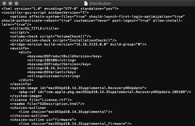

Just use Offline methods:
1. Download macOS Mojave 10.14.3 Supplemental Update.
2. Extract *.pkg (from *.dmg), assumed it' s located on ~/Downloads
3. Edit "Distribution" file for forcing installation on HFS+, Terminal:
Code:
$ cd ~/Downloads
$ pkgutil --expand [PackageName].pkg NewFolder
$ cd NewFolder && ls
$ nano edit Distribution
// or using your fav. xml editor, Find for:
function FileSystem1(prefix) {
    if (my.target.filesystem && my.target.filesystem.type == 'hfs') {
        return false;
    return true;
// change to:
        return true;
    return false;
// Save.
$ cd ~/Downloads
$ pkgutil --flatten NewFolder [PackageNameHFS].pkg
4. Try updating with your new modified [PackageNameHFS].pkg
I'm trying to do this but unfortunately Distribution file, for me, it's blank.

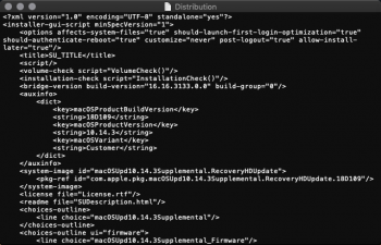

Hi, it's strange that your file is empty, with which text editor do you open the "distribution" file? I managed to open it with Texedit ...
Try with another text editor like TextWrangler, (now replaced by BBEdit), Smultron, MacVim, Atom, Komodo edit ...
MacVim, Atom, Komodo edit are free
